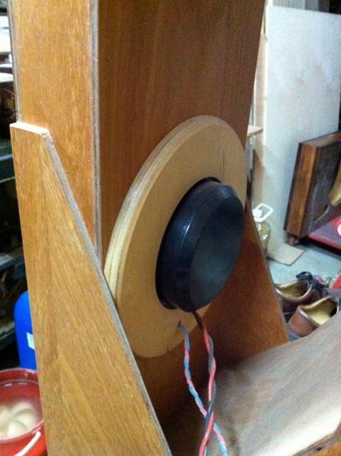

Greetings KoHo, The zen acousta is beautiful and intriguing.... I keep coming back to these posts. Can you tell me a bit more on how you calculated the, or lack thereof, compression chamber? I can't seem to satisfactorily back-calculate the posted horn dimensions to match your exotic Lowther, and so am unable to, intuitively or otherwise, determine whether this design could be downsized to fit my pair of FE166en. Even if I were enticed to swing a pair of FE206en, I'm feeling a bit blind on how it might work. Cheers,

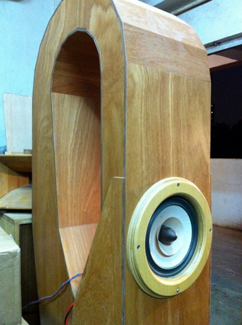

Zen Acousta is inspiration by Lowther 116 Acousta and Hedlund, just following the original 116 acousta horn dimension, without re-calculate.
I did so many testing to build the Hedlund horn and 116, around 6 pair.
I think the key not only the dimension, but also the"Plywood".
Wood as the soundboard like piano, develop the sound tone and low frequency.
FE166 or FE206 may a good choice for replace Lowther.

Hong Kong speaker carpenter Mr Yeung made Zen Acousta.
