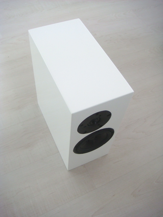

I just completed a pair of ZD5's in a sealed enclosure.
Fantastic, vibrant sound. Absolutely worth every penny.
We showed them at the Burning Amp festival yesterday, driven by a pair of Krell KSA50 clones. People were amazed at the tight controlled bass (especially considering the roof size) and the overall balance.
My last pair of monitors were Jordan/G2 ribbon 2-ways. No comparison. Where the Jordans sounded shrill and mushy the Zd5's were tight and balanced.
I have a to scale PDF file of the xover layout for locating the parts at the monitor base. IT was really helpful considering the complexity of the crossover and potential for inductor noise. I will try to post this file but if anyone wants a copy in DWG or PDF format send me an email
