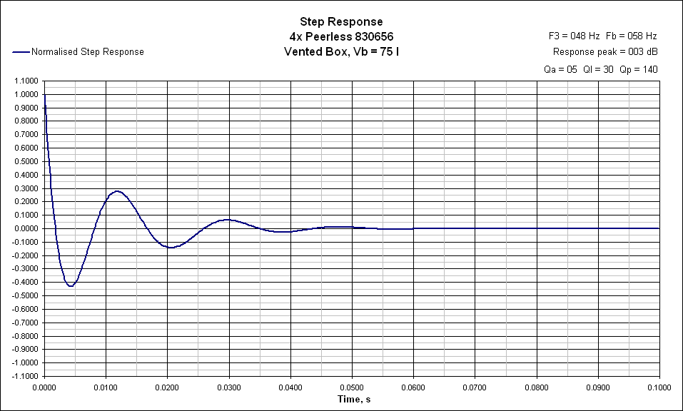

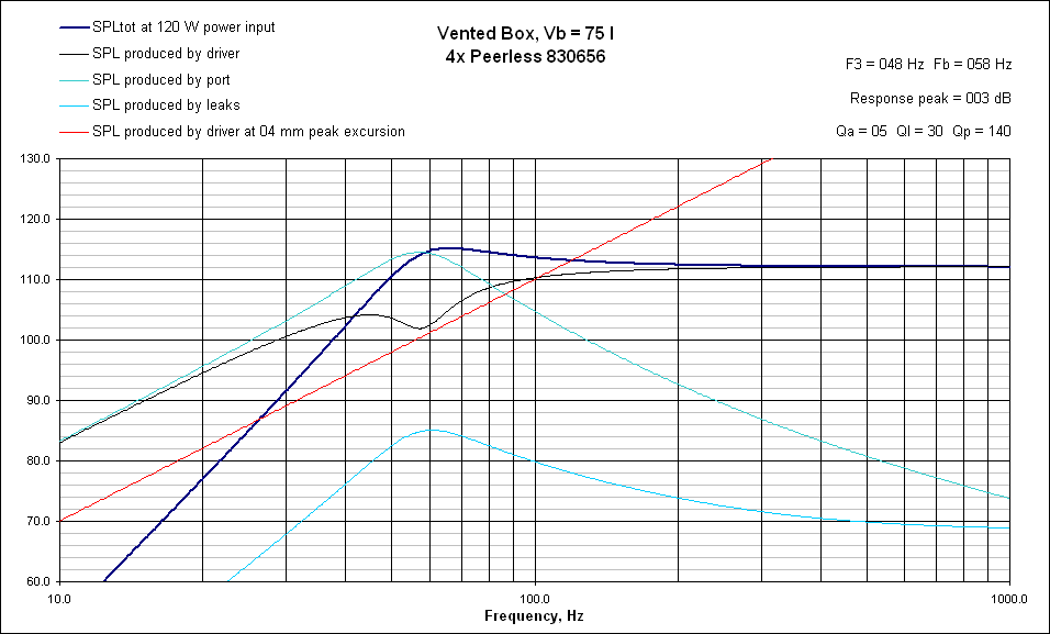

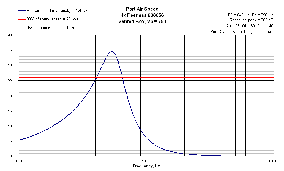

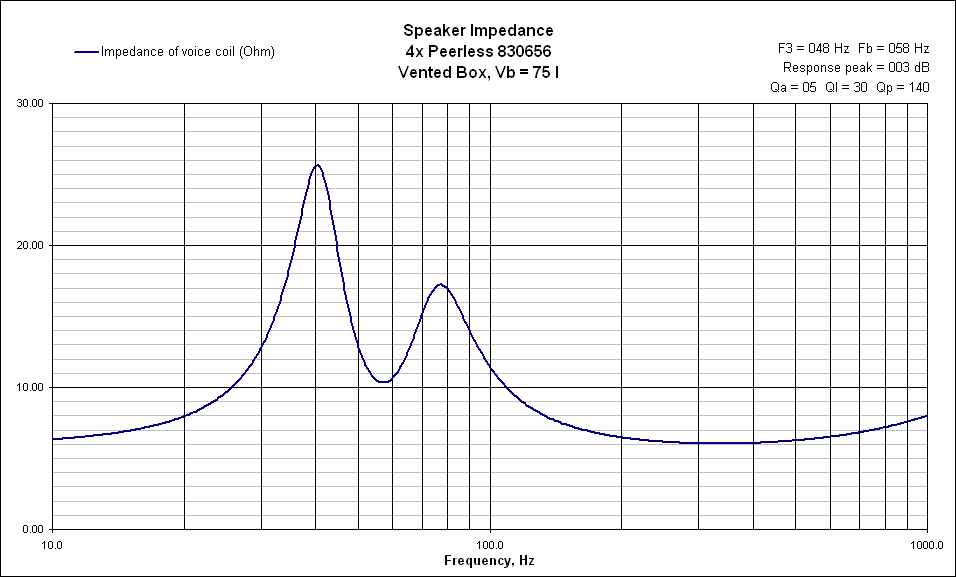

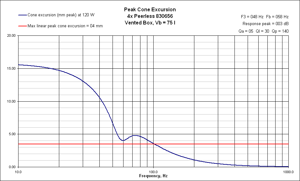

Sreten I have taken on board what you have said and tried the set up with Uinbox. It works great and a lot more detail also.
I came up again though with 4 x drivers in 70 to 75 litres. Box size doen't worry me honestly. (The wife well we will see)
Hopefully I will be able to attach these files and pictures so you all can see and guide me through the issues.
Firstly the vented box of 75 liters looks good but I also like the passive radiator as well.
I am not sure if the PR is for just one driver or not and if it would work by placing it on the back of the cabinet radiating toward the walls.
In both cases I seem to be strugling with cone excursion. It appears that I can limit it with damping. Any idea's?

Regarding your boxes around 6 to 8 L per driver well stuffed
would suit use with additional subwoofers and a HT amplifier.
Vented with no subwoofers I'd recommend around 14L per
driver with the vent tuned to 38Hz. As they are relatively
large boxes and the tuning is not that low the use of
passive radiators should not be necessary.
