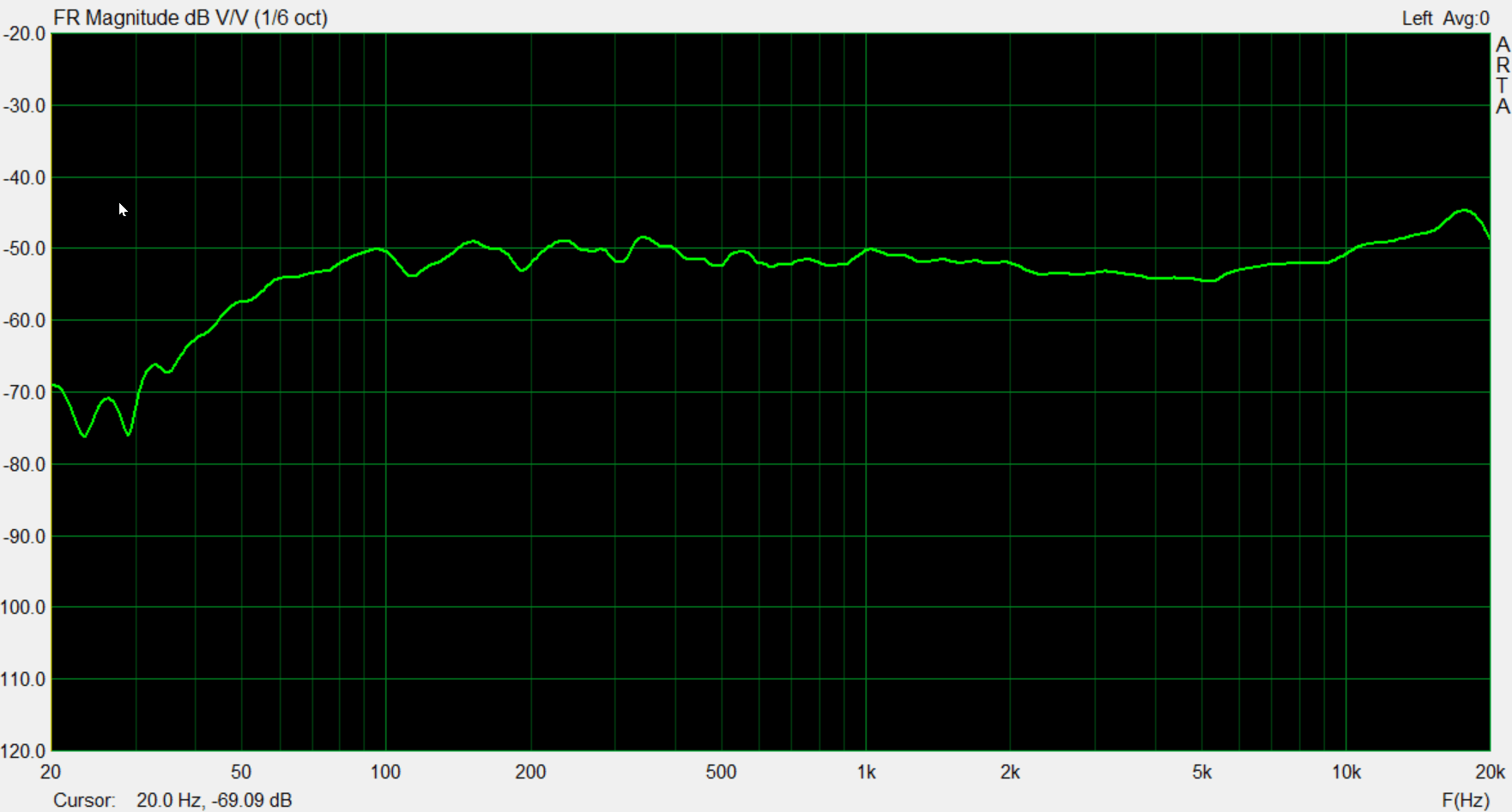

Hey Folks, I'm thinking about going for this build, being a happy user of ZD5 for years. I was thinking about 2.5 sealed, so looking for some opinions from people who built this specific variant, if any. My room is fairly small, so having 68L monster with double vents might be an overkill. I also ran into this thread which now bothers me:

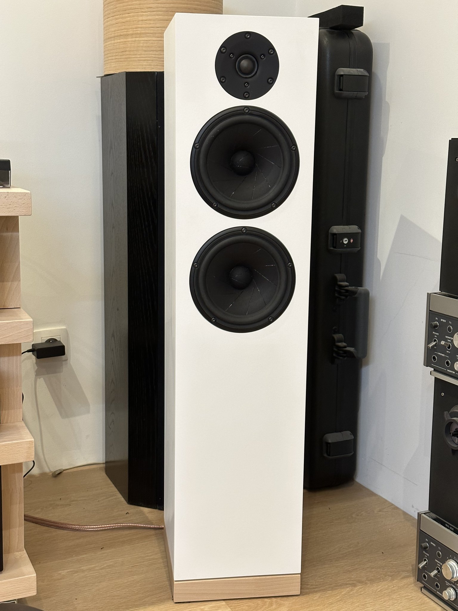

NIce looking cabinet. (y)
You should measure it to be sure what is going on. And if you did closed box instead of bas reflex you will need to adjust, becuse balance low - high frequencies is for sure not the same....and also depends a lot on the room...
Thanks - yes, it's sealed. I will probably need to move to 6ohm eventually, but with 5ohm is already much better. 2.2ohm was simply not listenable.

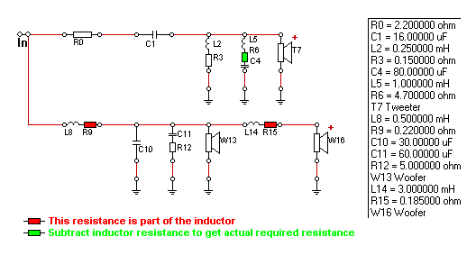

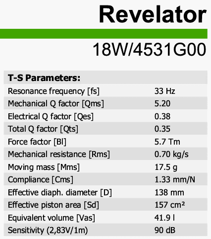

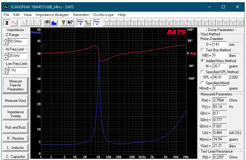

My Revelator is new. I sounded Madisound out that this Scanspeak W18 Revelator is very far out of spec.
I even told them that I'm open to a woofer replacement or ship me a Seas.
I will be happy to pay the extra cost if my selection is more expensive than the Revelator.
Instead of addressing my concerns, their customer service by the name of Brian, started to BS me.
Basically, he implied that I don't know how to measure T/S.
Even went to the extent that Scanspeak measures their T/S differently.
After two rounds of correspondence, I told this idiot off.
Maybe he taught I was a newbie that he can twist his fingers around.
I made it clear that I've been working on audio for the last 25yrs, full time, day in day out.
I know a thing or two about Thiele & Small measurements.
I have commissioned factories before to manufacture woofers for me.
They use LMS by Linear-X to measure Thiele & Small parameters.
For the record, I don't only have DATS.
I own the same LMS by Linear-X, which is the industry standard.
More than that, I have Audio Precision too.
These are the discrepancies in my Revelator.

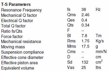

And here are my DATS measurements
Note Scanspeak Qts of 0.35. This is the main reason why I spend so much for a woofer.
When I measured with my DATS, the Qts was 0.7. And that was after 24hrs of breaking in.
A 100% deviation? I can get a woofer of Qts=0.7 for less than $30.
What do I expect?

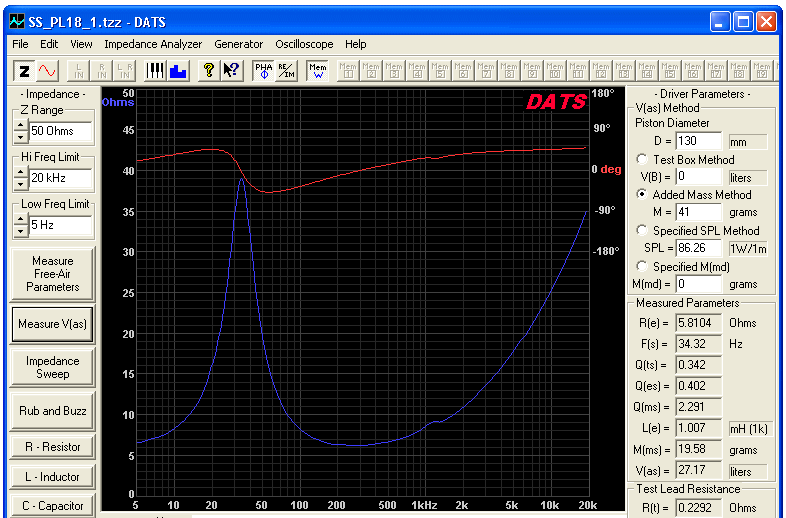

Here is a Scanspeak PL18 that I own. Below is T/S from Scanspeak datasheet.
Qts=0.34
This is from my DATS.
Qts=0.34
So what is all this BS about Scanspeak measuring their T/S differently.
