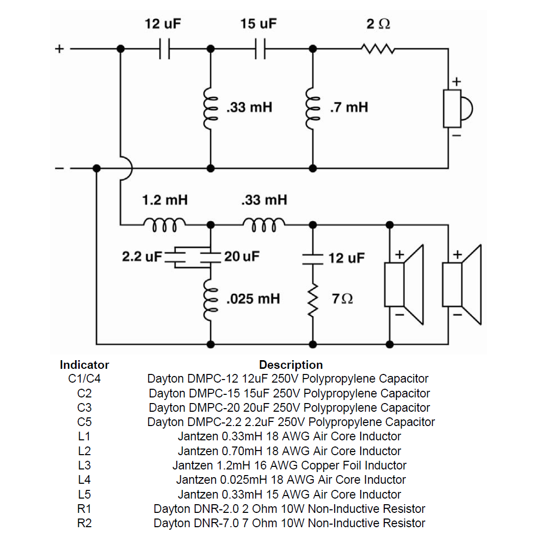

Well, looking through the assembly manual of the Dayton RS MTM the XO is definitely NOT an off the shelf XO.
Maybe someone who knows crossovers better than I can analyze this.
Yes, I agree. I looked into it a bit as well. I don't know anything about crossovers but it definitely seems thought out and not just something random they just threw in the kit.
Thanks for the help so far Einric, I appreciate it.
If anyone who knows crossovers and speakers could look at that diagram and tell me if the crossover is good for the components involved, I would be grateful.
