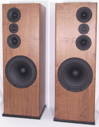

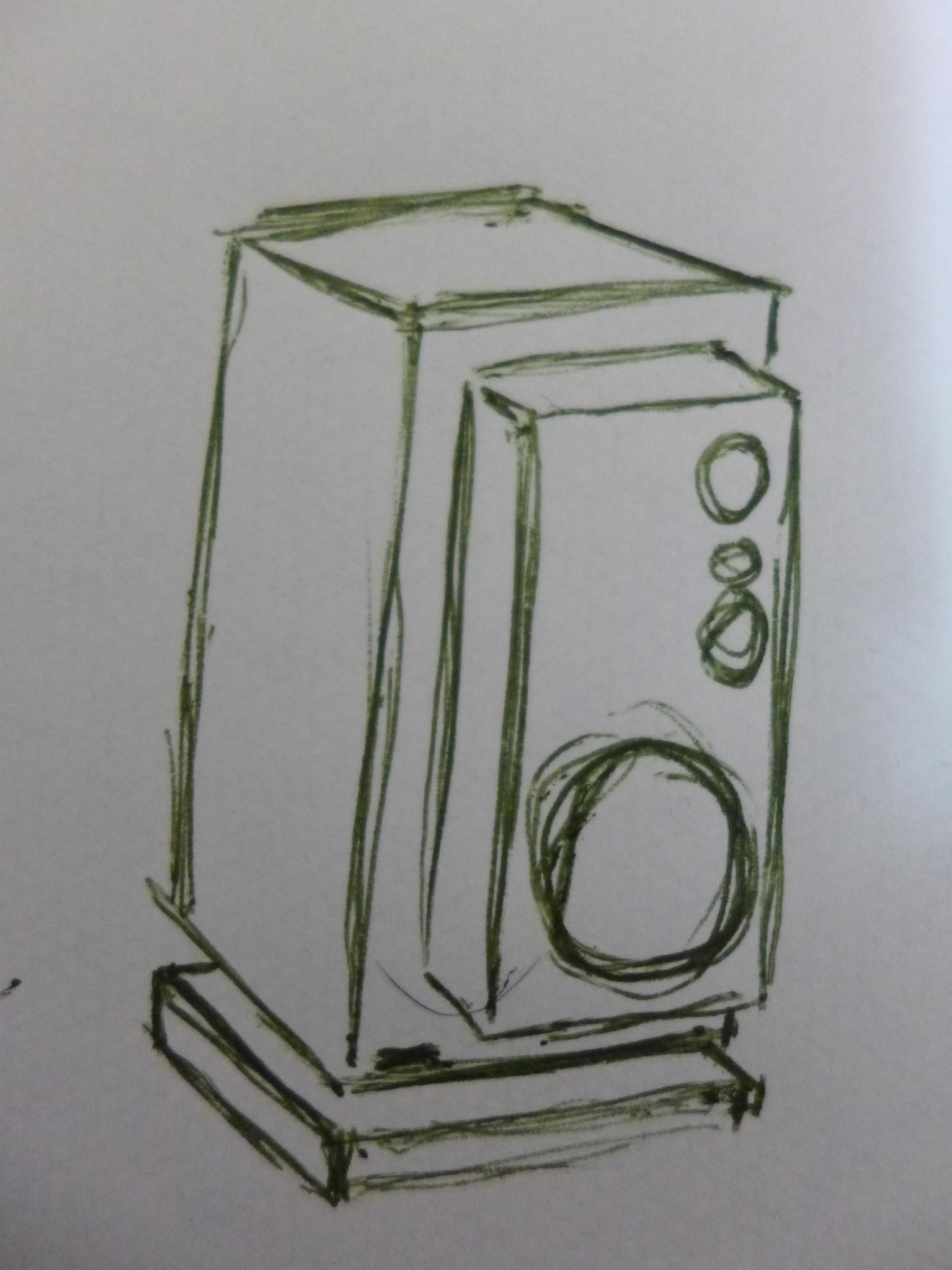

ive seriously been thinking of building these speakers in the new year..
Zaph|Audio - SB12.3 3-Way Tower
https://www.madisoundspeakerstore.co...e-3-way/#tab-3.
i dont know if anyone has built any,if so it would be nice to hear some input on them,more so if anyone has actually heard a pair.
any way i think we can mostly agree there not to pretty to look at which eventually brings me to the crux of this post.
im thinking of building them in the vein of some atc style speakers....please see my walt disney quick sketches below compared to the original offerings..
now my questions are to the people that know about such things are..
1)by doing away with the original lower front part of the baffle under the 12 inch driver (around 7.5 inches) will i be screwing up the baffle step/cross over function compared to how the original was made to function?
2)if im lucky enough to get away with xover problems from question one then will the original width front baffle that i have showing in my mickey mouse sketches protruding by about 2 inches be enough not to effect the original xover function where ive had to make the enclosure bigger behind it to make up the lost volume(in case you havent noticed...i really dont want to get into sorting out or changing the designers xover and hard work)
any help/views or advice is as always appricated.

Anytime you mess with the baffle you end up with different baffle step issues. There are a number of simulators. I like to use The Edge, but others don't.
I suggest what you do is grab a simulator and try out the two designs, and look at the resulting FR. If the changes are minor, and away from the crossover regions you are golden.
May I suggest, if you are going for short, tilt upwards about 10 degrees. This will reduce the amount that the tweeter/mids bounce off the floor.

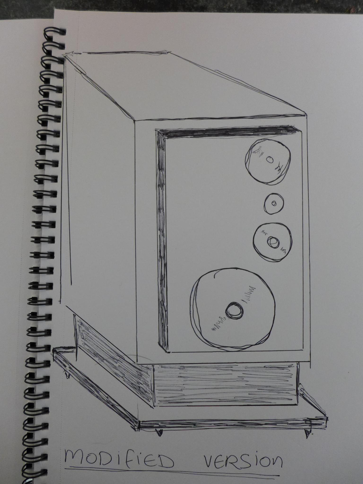

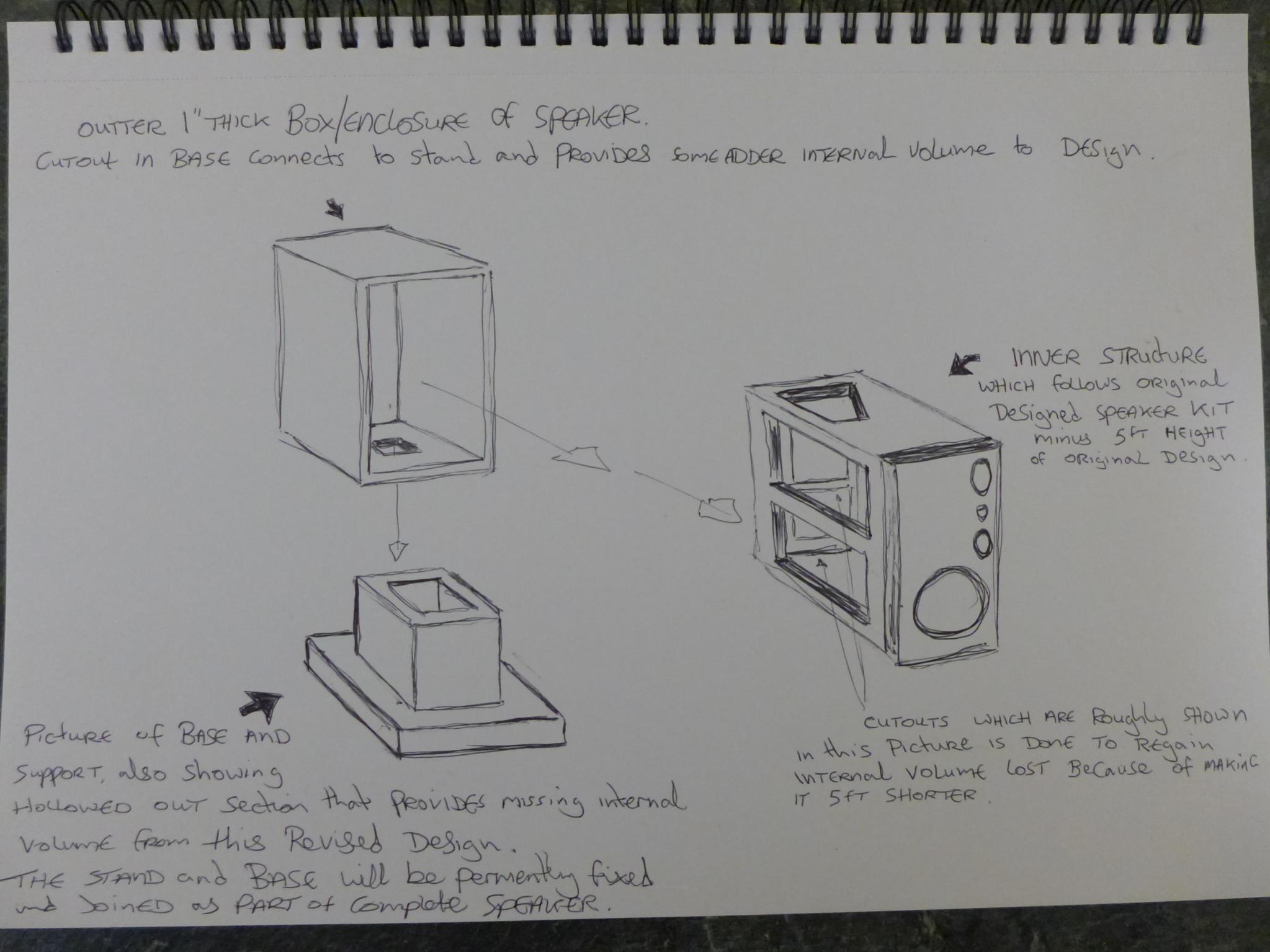

hi guys
many thanks for all your replies and take on what im aiming for....also a big thank you for not bashing my highly detailed and accurate drawings.
maybe what's not so clear with my iffy drawings is that my design will be at the same height regarding drivers and position as per the original design,the height will be made up with a base and central leg that's fixed to the speaker cabinet.
so the distance of the 12" inch driver to the floor will be the same as original concept,what will be missing of course is that last bit of 16" by 7.5 front baffle that normally sits under the 12" driver.
so with that in mind i wouldn't of thought there would be any need to " tilt" my design back,i can understand that reason if it was sitting lower on the floor,but my design won't be(will be same height as original),but i certainly realise my iffy bad drawings gave that impression.
i really appreciate all the help,more so as i certainly know nothing of speaker building or xover tweaking or designing and the reason im posting here and ask for help/views.
so with the positioning and height cleared up regarding my new shape design do we feel that getting rid of that 16" by 7.5" piece of front baffle that sits under the original designs 12" speaker will totally screw up this speakers design sound wise and xover design wise

Nothing serious happens, if internal volume of bass compartment is same. If it gets smaller, you will loose a tiny bit of low end sensitivity and F3/F10 limit, but I doubt if that is significant in normal size rooms. The box is sealed type.

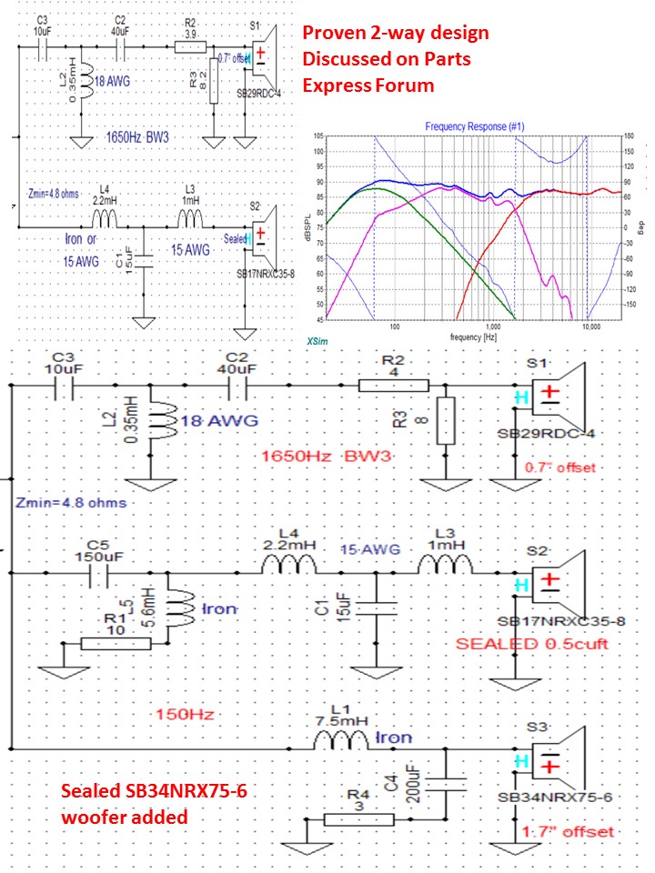

If you LOVE the ATC cabinet style, you could look for a well reviewed 3-speaker, 3-way design which fits that shape and volume. It is desirable to have the tweeter around 36-39" high. Good ear level, and then typical tweeter dispersion also covers standing listeners. A SEALED 4cuft volume for the 12" SB34NRX75-6 delivers -F3 ~35Hz with SPL ~87db after a modest baffle step. Replacing the two 5" midrange with one 6" is a better match for the ATC cabinet.
1.1" Dome SB29RDC-4
6" Satori MW16P-8 or lower cost SB17NRX35-8
12" woofer SB34NRX75-6
There are several free designs using the SB29RDC-4 tweeter and SB17NRX35-8 or MW16P-8 midranges to which you can add the 12" SB34NRX75-6 woofer. An LR2 electrical circuit works well because the Le=1.8mH for the SB34NRX75-6. I can post examples if you go down this path.
You can also Bi-Amp with an active crossover for the woofer. For the best sound, the crossover must be tuned to the baffle shape, woofer height, and room placement.
Meniscus Audio has a few 2-way kits like Jeff Bagby' Adelphos and Mandolin, plus Jeff's write-up on extending them to 3-way by adding a woofer.
What is your budget for raw speakers + crossover parts?

EXAMPLE: Adding a sealed woofer to a proven 2-way design.
$52 tweet + $58 mid + $175 woofer + $90 crossover parts = $375
The midrange is in a separate 0.5cuft volume(angle rear board) in ATC cabinet.

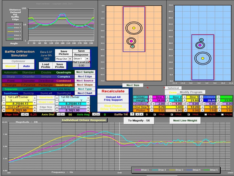

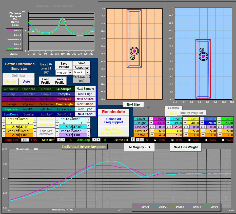

This baffle diffraction simulation uses similar baffle dimensions to the ATC cabinet with a 1" dome tweeter, 6" midrange, and 12" woofer. This simulation shows benefits from:
1) large quarter-rounds or bevels on the baffle edges
2) carefull placement of the tweeter and midrange heights similar to this baffle model
3) lowest simulated diffraction with: tweeter offset 0.8" and 6" midrange offset 2"
----the ATC engineers also used two different offsets for their 1" tweeter and 3" dome midrange.
Why is this 3-way design interesting? Because it delivers good Qtc=0.7 sealed bass from an acceptable 4cuft cabinet.
--Sealed 4cuft volume for the 12" SB34NRX75-6 delivers -F3 ~35Hz with SPL ~87-88db including a modest baffle step.

what my iffy drawing doesn't show is...
when the original speaker enclosure is slid and mounted inside the bigger outter box 2" of the original speaker baffle will be sticking proud of the new enclosure(atc100 style) and im hoping this will be enough not to upset the original xover design as it will be seeing the original baffle width and the speakers will be positioned as originally designed.
i hope that all makes sense

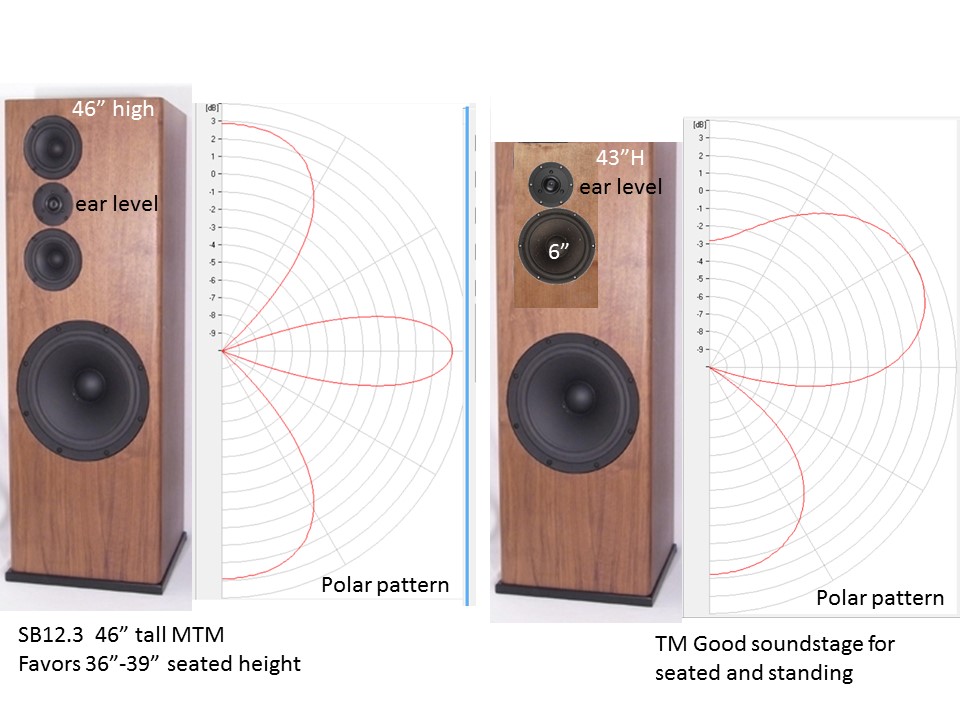

To get the best MTM polar presentation, you new box should have the tweeter at 36"-39" height, or angle the cabinet to the seated location.
The narrow polar pattern of most MTM arrangements favor the tweeter positioned at seated ear level for best sound.
The SB12.3 cabinets are 46" high because Zaph wanted the MTM tweeter to be at ear level (36"-39") .
A TM polar pattern can be slightly angled upward to cover a wider seated + standing height range.

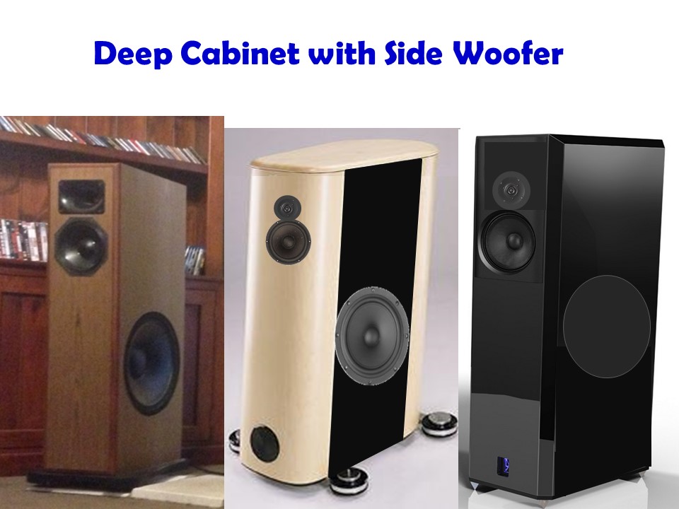

Side mount woofer
Hi LineSource,
I found this post looking for options with Zaph SB12.3, like someone previously said they are ugly so I’m thinking to make some changes to the design like live MTM at the front and put woofer on side but I heard cross-over needs to be modified for that any chance you can help me with that?
I also look at the design proposal in your post and you mentioned that woofer can by mounted on side can you put little more light on this,please
Raf
The Zaph 12.3 really does look a bit bluff.I am sure this has put a lot of people off.
Changing the baffle too much is really asking for trouble however.It seems the driver arrangement and crossovers are very specific to that baffle and positioning.MTM designs are hard enough to get right without messing with a proven formula.
My thoughts are that something that detracts your eyes away from the bluffness might be the best solution.A small shadow line groove or contrasting inlay about 5mm back from the baffle edge round-over might help.Or a mitred contrasting quarter round forming the round-over edge.Better still a contrasting quarter round with a very fine groove on the inside.
For those of us that dislike ported bass this kit seems to have a lot of appeal.
It would also appear to be suited to lower powered amplifiers than most.
- Zaph|Audio SB12.3, slight redesign
