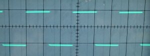

Re: Zanden DAC
Elso Kwak said:
From what I make of it the 1kHz squarewave must look horrible too. But I may be completely wrong. How on earth can this sound good???:confused:
This is the way it looks. That 5x R-L-C series in parallel only filter has somewhat larger overshoot, but rings a bit less and notches are a bit deeper.
Pedja

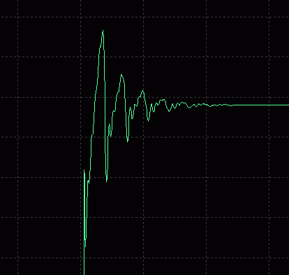

Elso,
Of course. I also have a problem to accept this. Look closer and you’ll see it rings at all those frequencies (44.1kHz, 88.2kHz etc… yes, lowest frequency is 44.1kHz). But I have the great respect for the people who made such thing. Also, some people consider it the best CD player ever…
Pedja
