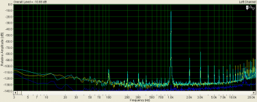

here a 1khz test , 8vss out, 8r load
(dark blue is idle noise of test setup)

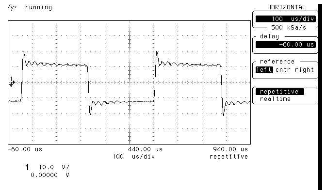

I purchased a new NXP TDA8920 from Mouser (USA), dug out my surface-mount toolkit, and soldered it in. I used a Thermalloy flexible heat-conductive washer rather than the original mica. I also changed the zobel damping resistors to the recommended 22 ohm, rather than the 10 ohm in the board.
The biggest change was to swing the 680nF capacitor at the top of the close-up image (above) around 90 degrees so that it connected to the output ground 'plane' rather than a plane more closely connected with the inputs. Removed the bypass capacitor there to free up the hole, and put two 330nf ceramic bypass capacitors under the board on the two out put rails.
Here are the waveforms from my much-worn and elderly HP54522A :)

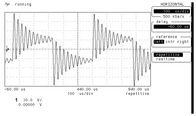

With a 20 V p-p square wave you can clearly see the output filter is relatively high Q. Without any load applied to an output, I measured with the correct 22 ohm zobel resistor and the 10 ohm which was in the boards when they arrived, and there was a marginal difference. You can see that the 22 ohm does provide better damping, although there is only a marginal difference. When an 8 ohm load is applied, the waveform cleans up, as you can see in the third attachment image.
I will try to get a BTL (bridged) configuration going too, and will report those results.

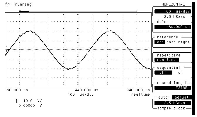

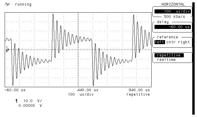

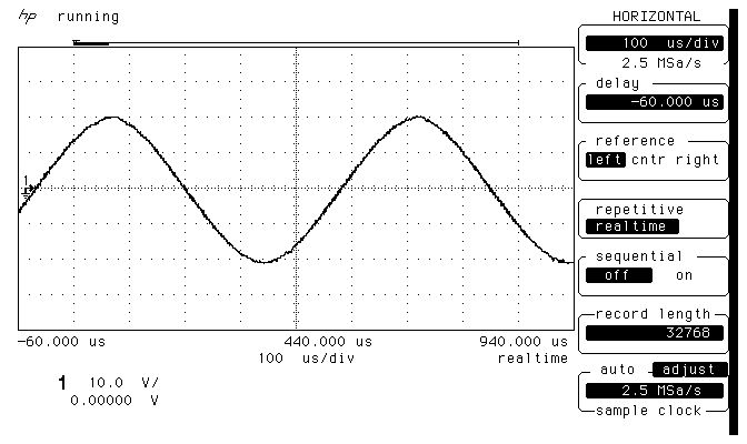

Here, for completeness, is a 20V p-p sinewave with no-load and 8 ohm loads applied. This is a single-shot storage, so you can see the dithering of the PWM converter. Remember that although the waveform imperfections look none-too-good, the PWM corrections are being applied at a very high frequency, above 200KHz. The amplifier actually sounds fine now...

Just confirming it is the Zobel damping network which needs to be adjusted to stop the 50KHz (approx) oscillations with no-load connected to these amplifiers.
The amplifiers which were supplied to me from Hong Kong had 680nF capacitors in the output filter (with 22uH inductors) rather than the 470nF capacitors recommended in the TDA8920 data sheet. Consequently the currently installed 100nF and 10 ohm resistor do very little to damp the Q of the output filter. I changed mine to a 220n and 22ohm series resistor configuration. This worked perfectly, and damped all remaining tendency to oscillate under a no-load condition. Be careful to use at least a 2W resistor in this position, especially after increasing the cap to a 200nF :)

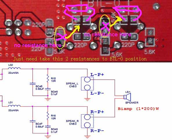

For completeness, I finished testing the boards in BTL mode, having found the instructions posted by leau2001 in another thread (for a different style Yuanjing board) (see attachment below).
Both the Yuanjing boards I tested worked well in BTL after these instructions were applied. Both were stable, both having been modded as described in previous posts. The heatsinks stayed below 100 degrees centigrade when tested with the largest undistorted output sinewave possible, about 50V p-p (bridged) across my 8 ohm resistive load (27.5V-0-27.5V supply). The board stayed within 10 degrees of the heatsink temperature. That power level is just above 40 watts, but you will get the 'rated' 70W if you push the distortion to 10%. I tend to stay below the level at which the PWM digital artifacts occur. Any half-decent speakers can numb my ears from hearing any artifacts above a 40W power level :) :)
