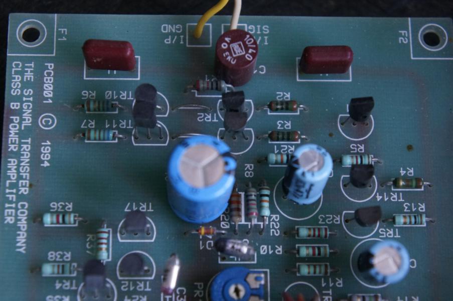

My Blameless (built with 1994 Signal Transfer boards) never suffered from any kind of RFI troubles. It always puzzled me because it has neither RC low-pass filter at the input nor power supply RC decoupling.
I am on holiday at the moment so I can't check, but as I recall all the Signal Transfer power amplifier PCBs have/had both an RC low-pass filter at the input and power supply RC filtering. (on the -ve rail only, as that's where it's needed) However 1994 was very early days so I'm not sure about the RFI filter.
I would emphasise, however, that the series R is only 10 Ohms, and the filtering is in the RF region only. DO NOT put series resistors above 100 Ohm in series with the input as the input currents drawn by a BJT input stage are non-linear and THD will be much increased.
This may be true for JFET inputs also (due to non-linear input capacitances) but I am speculating here.
Here is an advertisement as published at the time in Electronics World + Wireless World from which I purchased the boards as soon as they were available. I also join a photography for more details.
I interpret the lack of RFI detection despite no special protection against it as being due to the fact that the input stage (differential stage with resistive degeneration loaded by a current mirror run at 2*3 mA) is intrinsically very linear and not susceptible to rectify HF signals.
More annoying in the first batch of the boards was the lack of a high value resistor connected to ground at the input side of C1, I added one on the copper side of each of my boards.
I never found necessary to add an RC low pass filter. Of course, would I have done it, R would have been low value, as you recommended it a bit later after your first articles on power amps.
