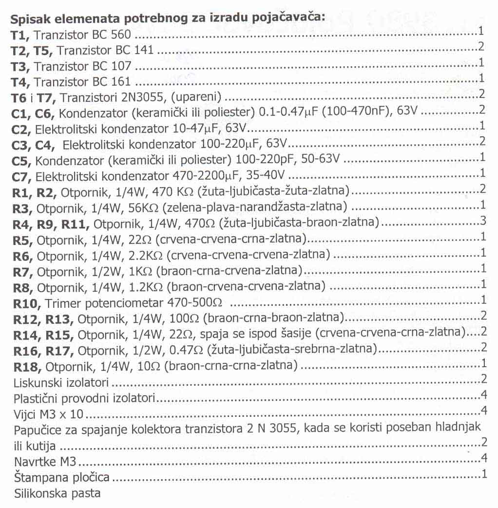

Please, tell me your opinion,about this old schematics.
I know that this schematics is old,low hi-fi,but easy to building, and cheaping.
Yours experience?

Old it may be but you may be surprised just how good it may sound. Look at the feedback factor.
It's ideal as a first project IMO, you have no worries about DC problems damaging speakers and the PSU will be simple.
It will work with just about any suitably rated transistors too...
Do you have the full construction details ? showing how to set up the bias etc and having T3 in thermal contact with the output transistors to keep it from thermal runaway.

Dear frends, T3 is bias control, this transistor shold be to put in to heatsink with outputs transistors,think in same place(heatsink, because good termal stabilty) .
About hum,yes that is probably problems,but with BC550,and metal films resistors,maybe hum to be low.
This is kit,and I get(buy) a PCB with parts and manual instruction,my job is only conclude.
This kit is in circulation but ten years.

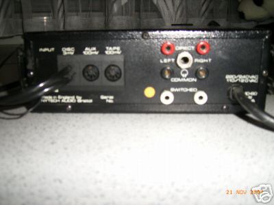

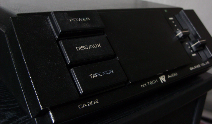

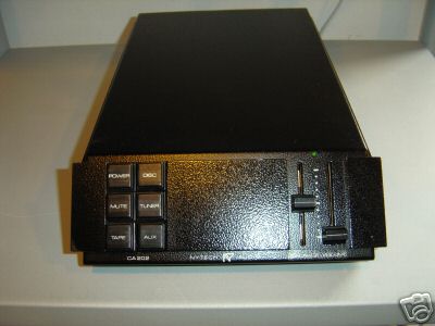

This circuit is one of my prefer topology for Class AB mode (20-30mA idle current through the output devices). If there are 10-15 mA idle current for T1 and 30 - 50mA for T2, so as additional jFET input buffer and high quality capacitors/transformers, then such an amplifier is very hard to beat (except nessecary concepts with pure class A in the output).
There are also some commercial amplifiers, that have inside this topology, e. g. the no longer exist U.K. brand "Nytech", model No CA202 (CA-202), have a look to http://images.deep-resonance.net/image/85.jpg
http://i36.tinypic.com/2chxelx.jpg
and the pdf file:
  • C_tmp_Nytech CA202_ckt.pdf
