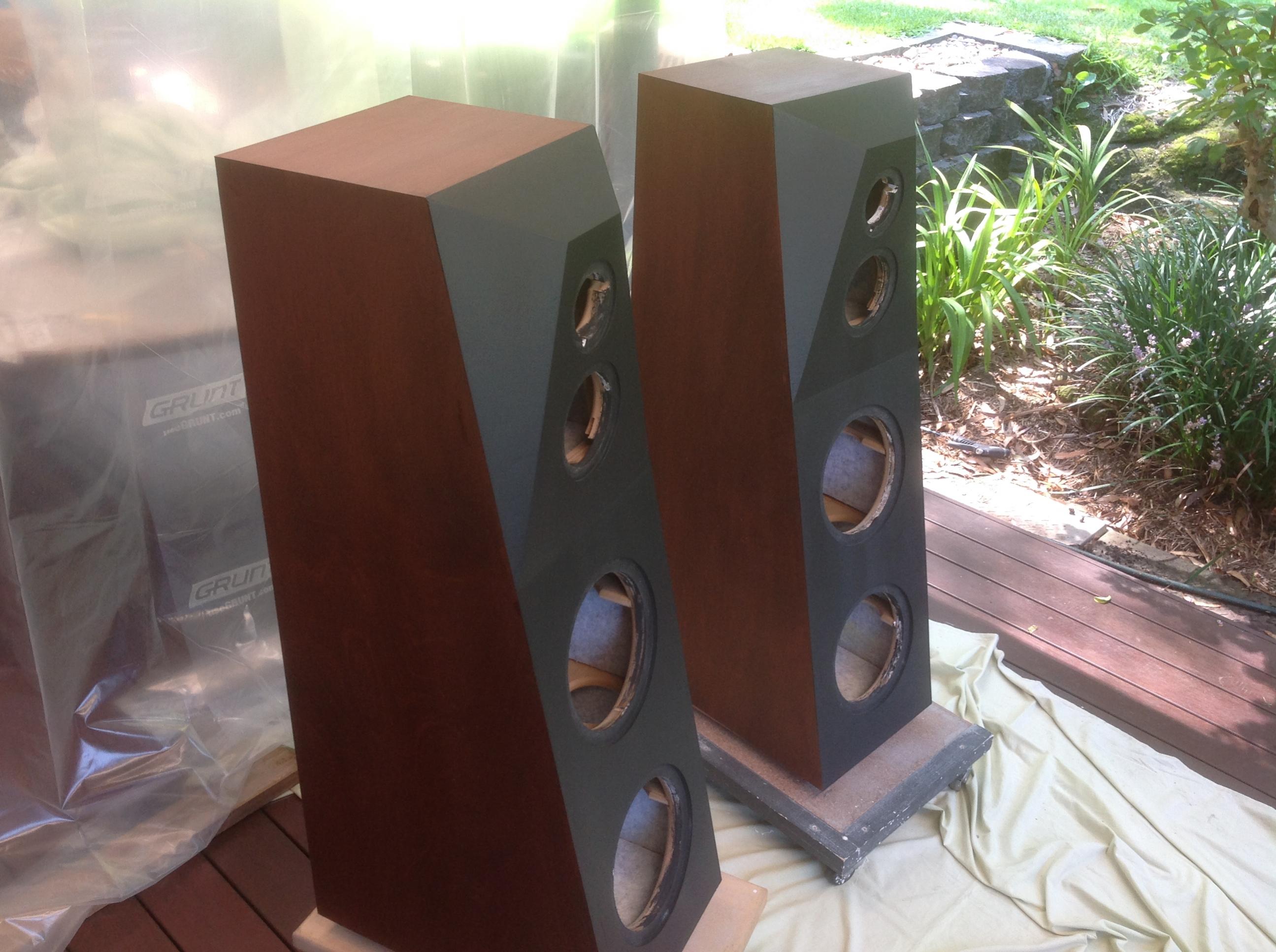

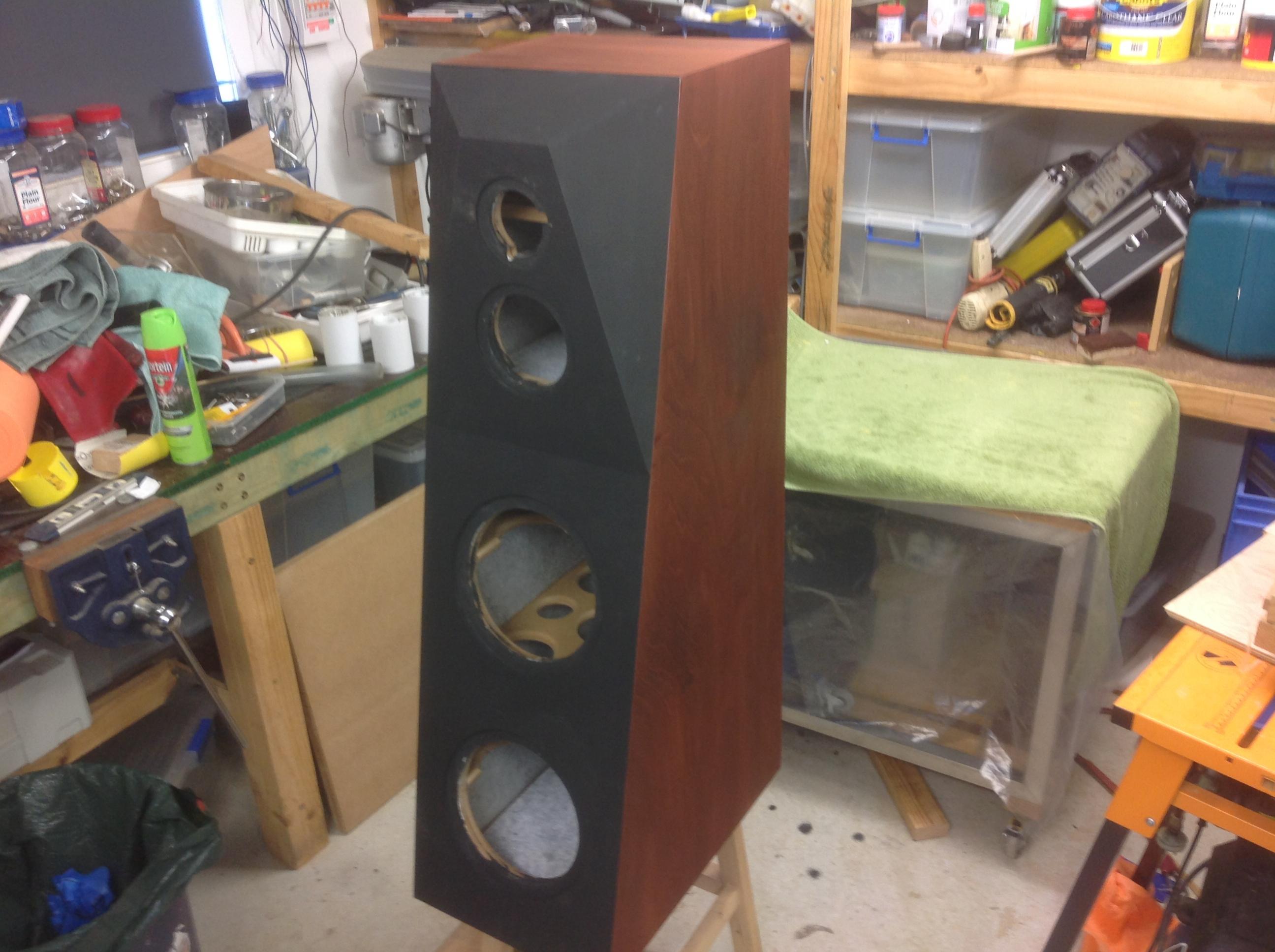

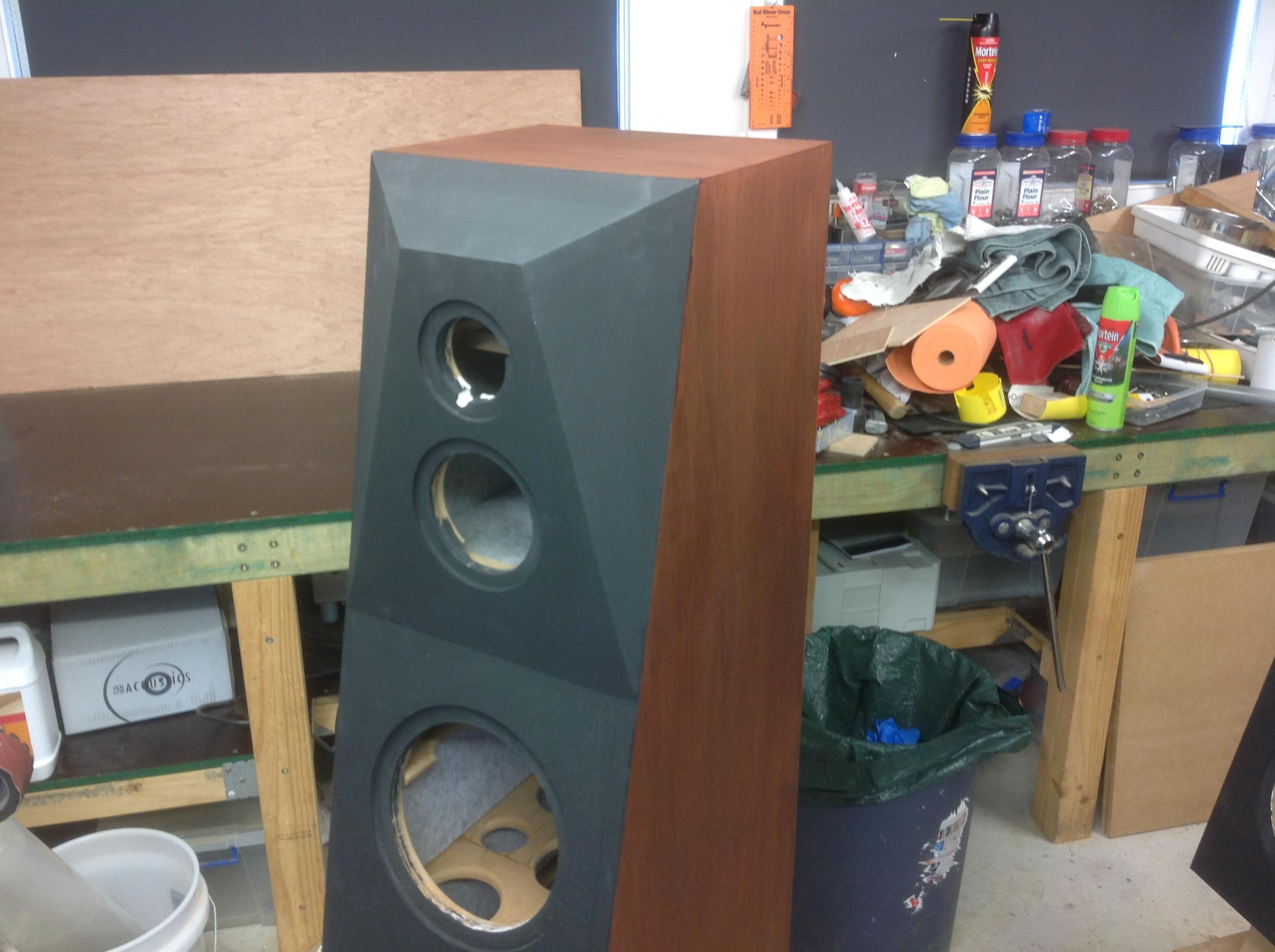

All my recent speaker projects have diffraction control as a priority. I take my inspiration from the Harry Olson results
http://www.aes.org/aeshc/pdf/how.the.aes.began/olson_direct-radiator-loudspeaker-enclosures.pdf
Mine will look similar but even the bass cab will get chamfered (like that of your mid cab) as well since the bass may extend to the midrange frequencies.

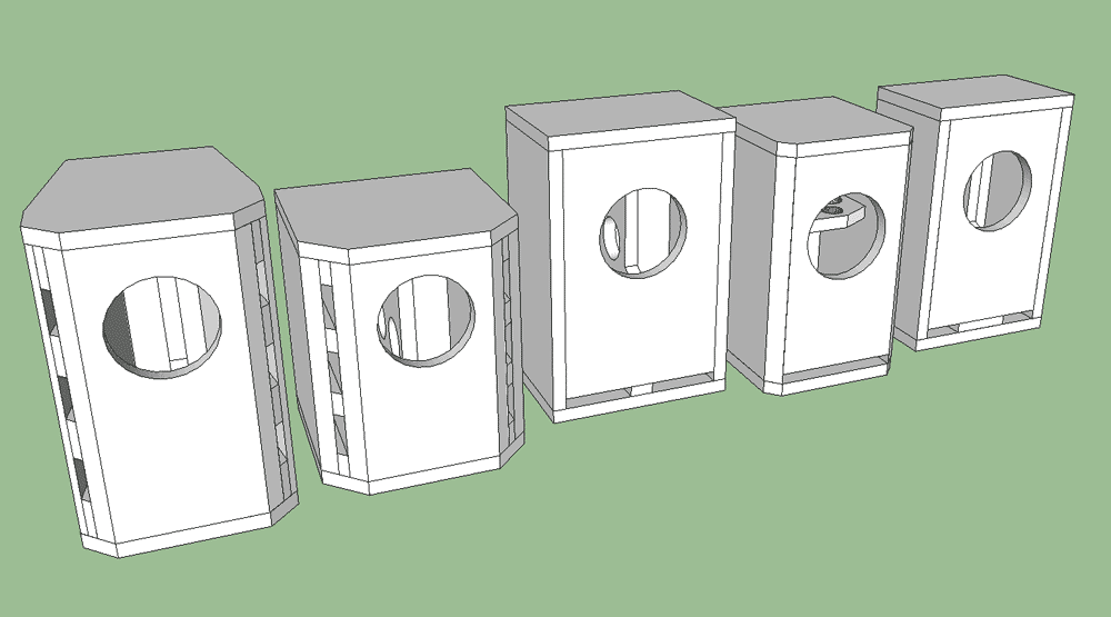

My practical experimentation with diffraction is exampliefied by this sketch (Fonkens for the FF105wk),
The 3 images on the left are all 5 litres and all have the same tuning… they are just different shapes. As one moves from the rectangular CGR, to the rectangular box with big side chamfers, to the trapezoidal box with not only large side chamfers but a narrowing at the back that make sthe plan a crude tear shape, the diffraction signature decreases and the ability of the box to audiably “disappear” increases.
dave

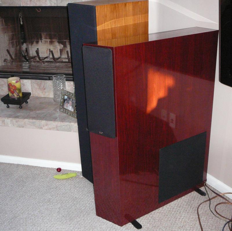

Epic build! Have you also found that a slanted baffle does only good for the bass? (and obviously the midrange so that you listen slighly off axis where every single speaker in the world sounds better)
Another thing I have found is that a speaker produces better bass IF the baffle goes all the way down to the floor. If you raise the speaker with spikes or so, it seems that some of the sound travels back under the speaker. Not sure if I can measure a difference with my mic, but there is no doubt in my mind, that there is a difference. And it is not neglible. The impact and tactile of the bass is better. Then imagine what happens with a two-way, where there is a slanted stand all the way down to the floor. I even think that way back in time, such a device was sold by Wilson Audio.
For DIYers, I think the Thiel CS2.4 is probably the easiest to duplicate. The ones from B&W may be a bit difficult.
It may be an optical illusion but the rear and mid-tweeter baffle are vertical and the bass baffle is leaning backwards. So actually the listening position is horizontal with the tweeter. The speaker is toed-in to preference. The new photo hopefully makes this clearer.Epic build! Have you also found that a slanted baffle does only good for the bass? (and obviously the midrange so that you listen slighly off axis where every single speaker in the world sounds better)
Bass performance is better at low frequencies when the baffle is extended towards the room boundaries (wall, floor or both). This is often called the Allison Boundary Effect, after Roy Allison. It was used in the NHT 3.3 and 2.9 for exceptional bass performance. It was a bit limiting in that the speaker worked best hard up against the front wall. To keep this thread on topic, NHT also used foam strips to mask the cabinet edge diffraction. I have never been quite convinced by the use of felt or foam to control edge diffraction. It always seemed too hit-and-miss to me, although many swear by it. The Olson results are pretty definitive but the cabinet construction is not simple. If I had the capability, large radius edges would be my preference but chamfers get pretty close.Another thing I have found is that a speaker produces better bass IF the baffle goes all the way down to the floor. If you raise the speaker with spikes or so, it seems that some of the sound travels back under the speaker. Not sure if I can measure a difference with my mic, but there is no doubt in my mind, that there is a difference. And it is not neglible. The impact and tactile of the bass is better. Then imagine what happens with a two-way, where there is a slanted stand all the way down to the floor. I even think that way back in time, such a device was sold by Wilson Audio.
