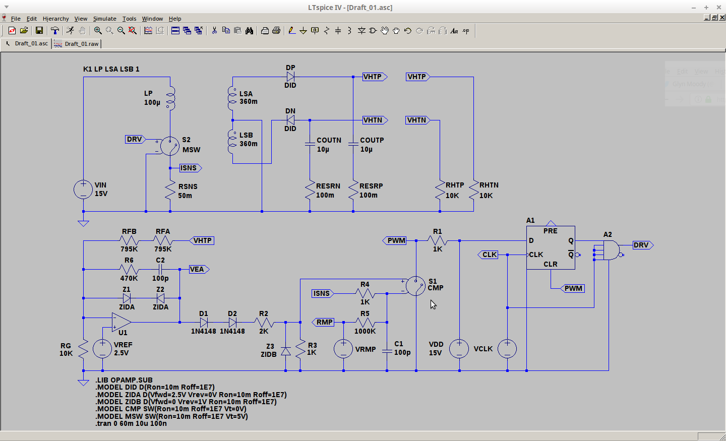

YH11068A Schematic update
(I've joined the forum primarily to post this)
trobbins: I saw a post of yours more recently than this thread, saying that you've not completed the schematic. Is that still the case?
I've created a schematic in LTSpice from your hand drawn notes, but there are probably some errors... In particular, I've defined a node "Vx" as the power supply to the opamp, but I'm not clear on how it is supplied.
Anyway, does this look right to you? (wiring only - part designators, values, and other static are all up in the air ATM)
It would be nice to actually get this simulating in LTSpice (hoping that the LT1243 is very similar to the UC3843A).
It would also be nice to hack it with an opto in the feedback line so that the outputs are isolated/floating.
Any corrections would be appreciated.

Hi, your schematic is not linking properly. No I haven't attempted to redraw my hand-drawn schematic, so any re-draw would be a help, given that if sections of the schematic do not make sense (given what is known with normal use of those IC's) then I'll get the pcb out and confirm where the actual traces go.
Oops, I hadn't completed the upload to Imgur. I think this works:-

With respect to your draft schematic (I appreciate LTSpice may not have applicable parts, but I'll list items for completeness):
- The linear reg is a 78L09, with an output filter cap.
- output rectifier configuration is half-wave
- opamp V+ pin 8 connects to +9V supply (I missed a via link). C3 appears to be a local bypass to the opamp package.
- opamp output pin 1 has a 15k pull up to the +9V supply.
- opamp pin 6 pull up to +9V is 15k (not 8k), and 15k to pin 2 (not 8k).

trobbins:-
Thanks, I'll update the schematic with your corrections.
Except on the output, my schematic is correct there.
These modules often come with -ve outputs as well, ie: dual half wave.
(which is why isolation would be good - can get 800V)

Tim,
I've updated the schematic:-
* Where you had no value, I've made a guess (2K7,10nf,100nF)
* The diodes have no part numbers (except the LED)
* I don't see a C3 on your drawing, I assume you mean what I've designated as C4
The attached ZIP contains the .ASY files for the parts that are not supplied with LTSpice. Dropping the lot into a single folder, and opening the .ASC should work...

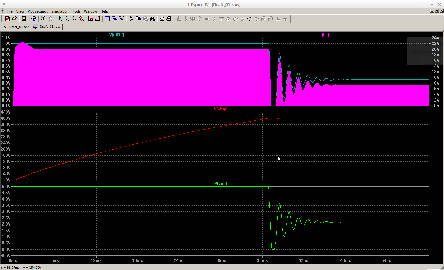

This is all just for the schematic, no attempt has been made to get simulation working. I may play with that, but it would probably be a waste of effort.

Hello all!
Thank you for circuit diagram and very clear picture of PCB YH11068A.
And I would like to present new corrected circuit diagram. Differs in partnumbering and some connections:

If there are pull-up resistors like R12, R13, then operational amplifier LM358 can be easy replaced by comparator LM393. IMHO.My power supply, unlike the schematics, does not use LM358 but instead LM393.
