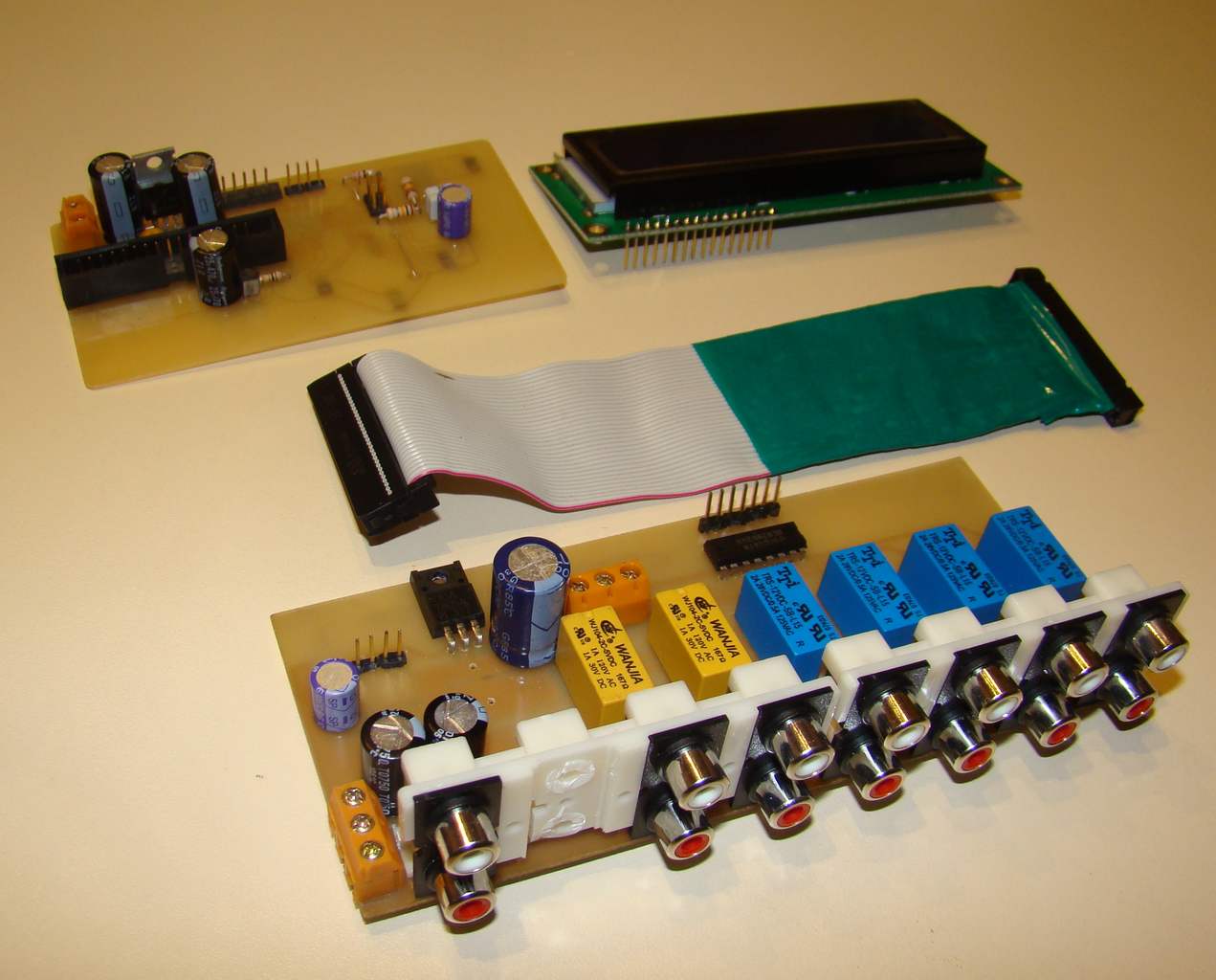

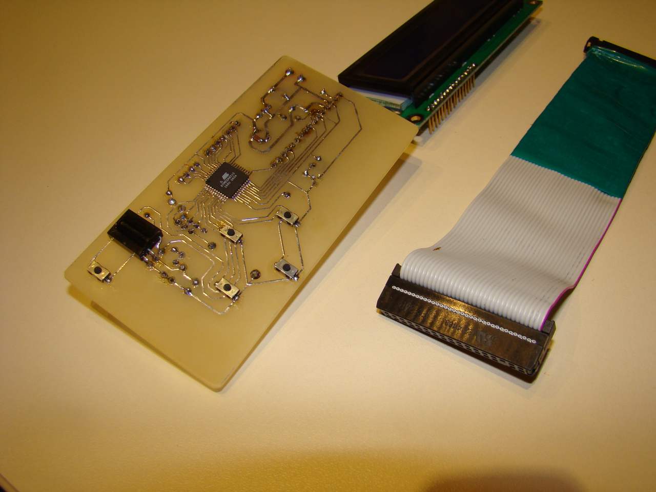

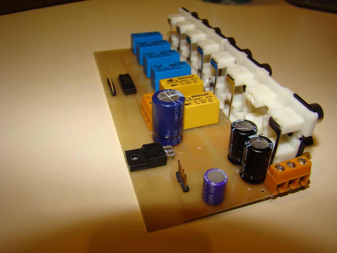

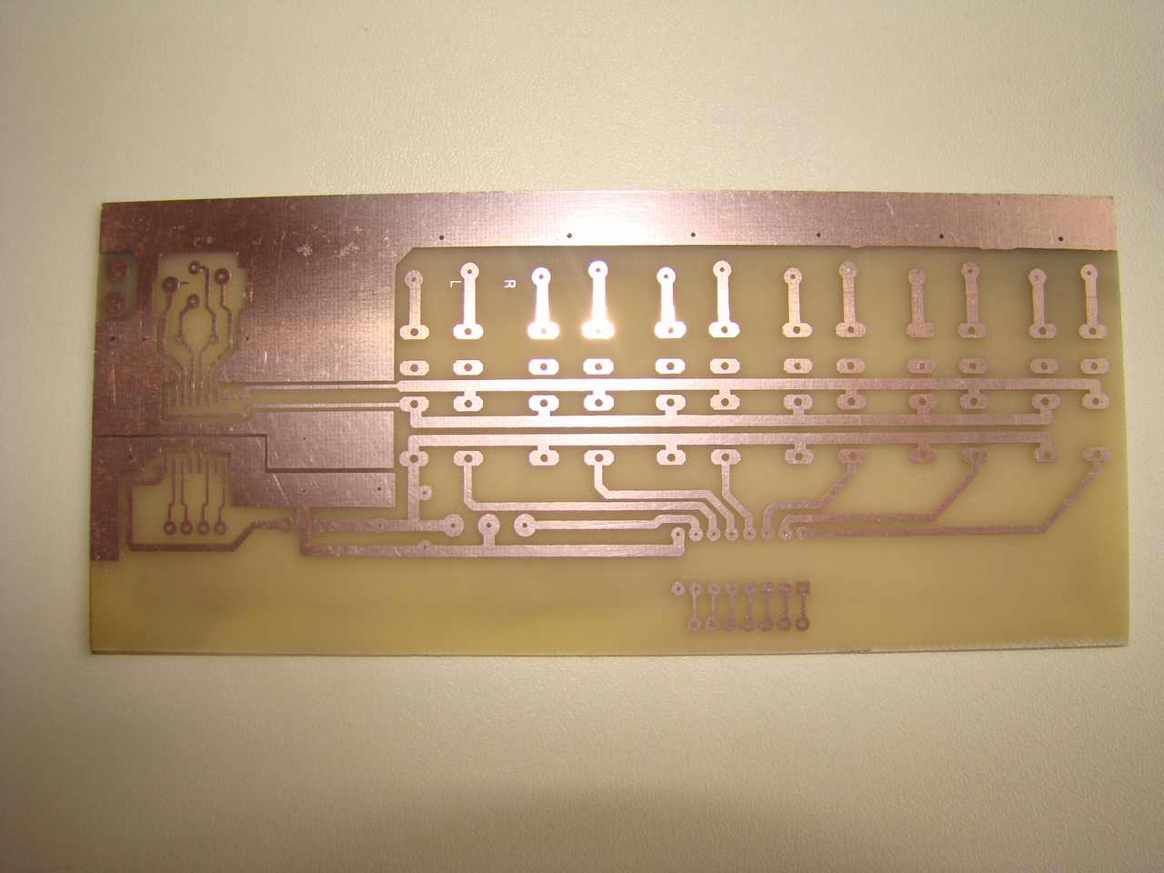

Finished designing, etching and drilling the analogue stage PCB. Took me about 4 hours all in all. Photos will follow soon. The PCB fits the input/output jacks, relays, a ULN2003A driver, the PGA 2310 and a 7805 voltage regulator for it's digital part alone. Analogue and digital grounds are split apart and connected via a ferrite bead inductor. Signal path is minimized.
Let's say it's an attempt to get a step closer to a "proper implementation" of this chip. If anyone's interested - I'll share the design as well - it's already possible to use it combined with the microcontroller (which is recommended to be kept as far away as possible from the signal path).
So here is how it looks like.
The PGA is bypassed with small SMD ceramic caps close to the leads. The ferrite bead is also an SMD inductor. The analog PSU bypass caps are Rubycon ZLG, the digital part bypassed with a Sanyo OSCON.
Exceptional !!! I like`t !
Congratulation for your PCB !
Okay, maybe that was five hours... Thanks guys for such positive feedback, catch some more then...

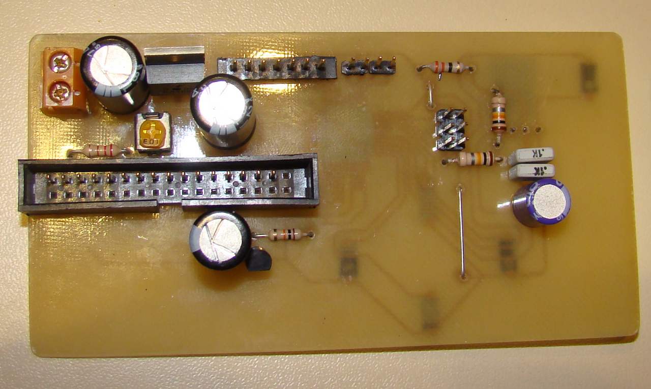

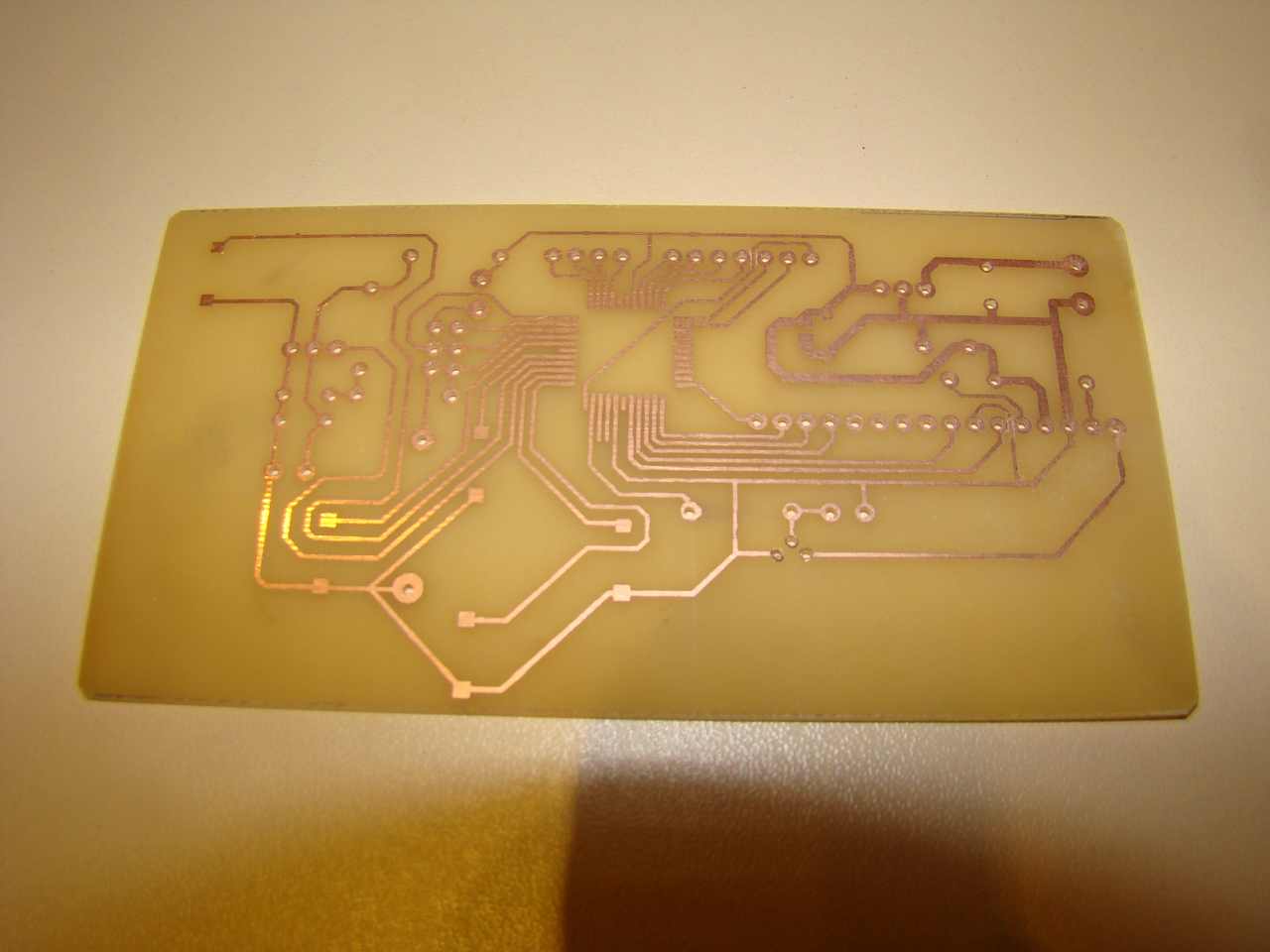

This is the MCU board for PLCC atmega. This one took me some more, needed to spend half a day digging the datasheets. Now only the PSU PCB will remain.
Come back with updates soon.

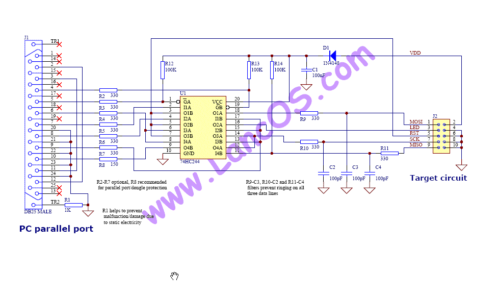

as far as I understand, you've used BASCOM-AVR for creating and compiling the code. What did you use for flashing the chip itself, I mean - which schematic and software? I am planning to build the simplest-ever-possible type of ISP programmer - appreciate your suggestions.
AVR prommer
Vikt0r,
as for me I soldered very simple "USBasp - USB programmer for Atmel AVR controllers".
Original link:
fischl.de - USBasp - USB programmer for Atmel AVR controllers
BASCOM-AVR supports USBasp since version 1.11.9.6
Vikt0r,
Original link:
Yes .
It is STK200/300 programmer header for parallel port .
In Bascom this must be set in the programmer adapter type .
Bascom AVR compiler you will find to download for free .
On the schematics I forgot to draw the signals for programming so you must use the following pins of Atmel :
Reset , Miso , Mosi , SCk , 5Vcc , Gnd .
Do not forgot to program only the fusebit : Internal RC 8Mhz oscillator.
Wow,
thanks guys! One of these will definitely do for me, found an ALS244 already. Interesting founding that some different (and incompatible!) pinouts for the ISP exist. The Atmel appnote recommends a 6 pin header, while at many designs a 10-pin one can be found.Which one is more standard? Another question - would this all SW accessing the LPT port work under Win7? Has anyone tested it?

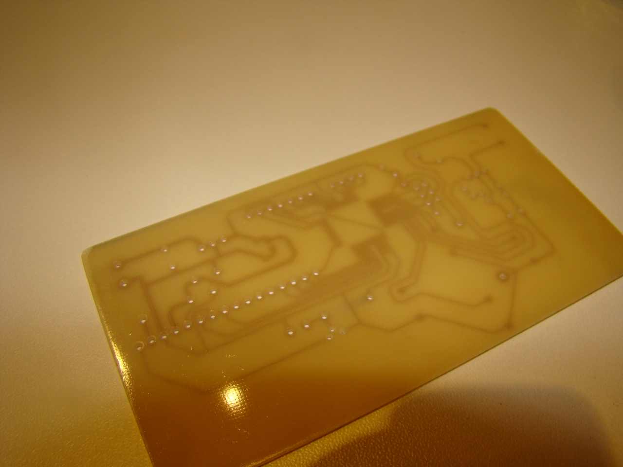

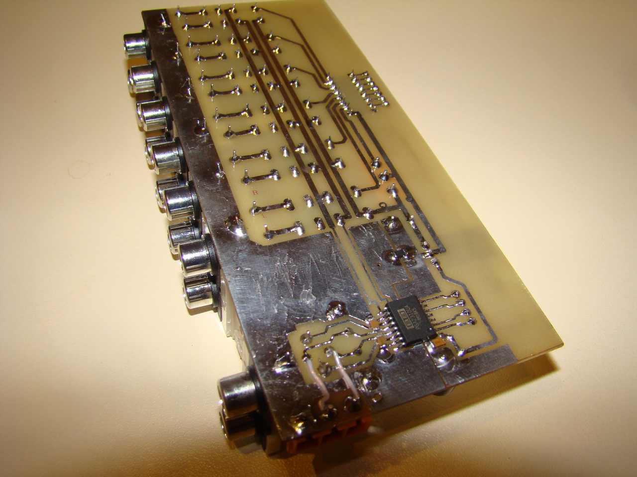

Oh... the WIP, if anyone's interested Very draft yet, just finished soldering, didn't even wash the board.
