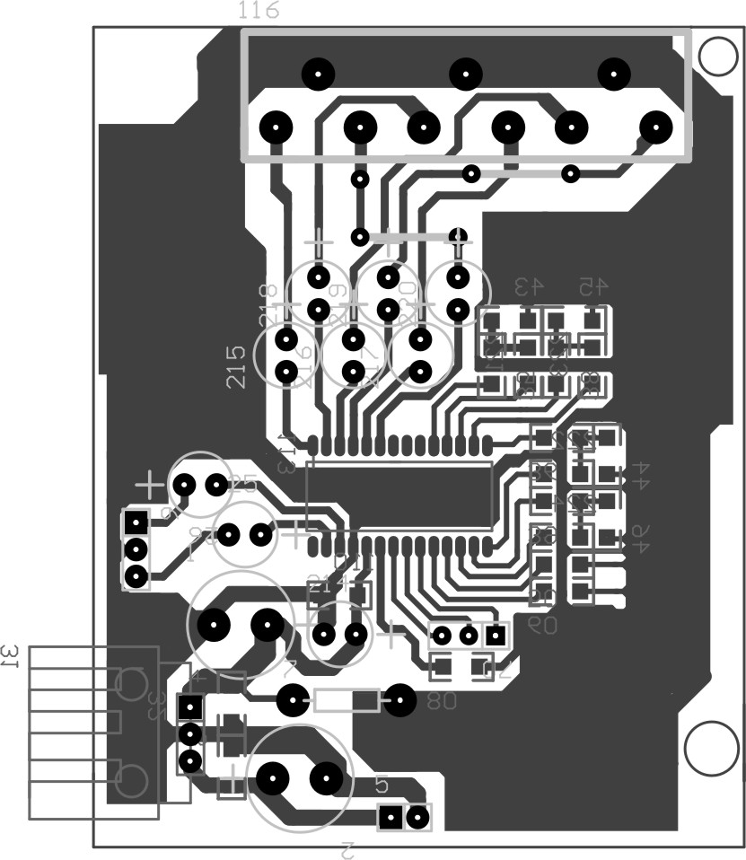

pcb layout for TDA7439DS
hi
made this pcb for replacing my pga2311 ( vvvvvvvery sweet chip) card, since things are modular in my amp.. i can relace the processor, amp, power filters. so even my preamp is sort of modular...
anyways just posting the pic of the pcb... let me how to improve it more.. if possible..
yes i know i should have used mkt capz.... but .... i wanted to make it small and couldnt source all the cap in same chemical family in bombay market.. anyways.. did what i could
