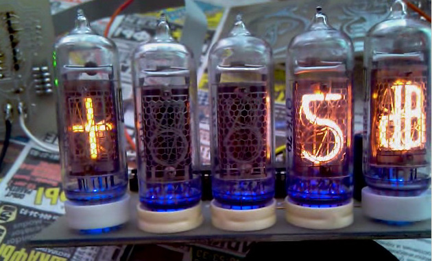

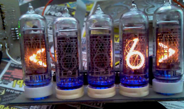

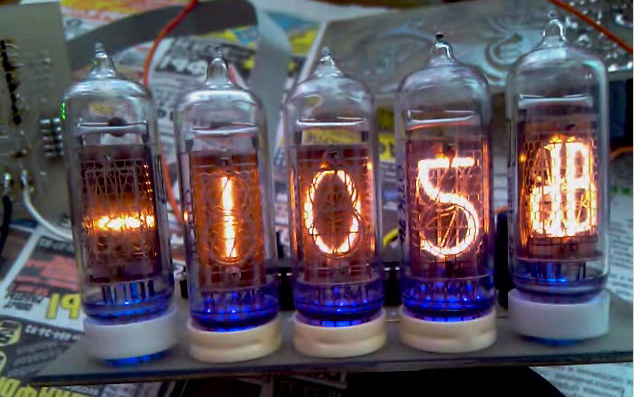

R/2R Nixie/LCD Versions
Hi
Volume Controller Nixie version was finished in april. It was successfully tested.
Two LCD versions are also finished, there is one small difference as an option.
Options:
- volume control R/2R -127dB...0dB
- passive board control, bass&treble, 4 steps in 5dB from 0dB to +20dB
- Nixie PWM (brightness)
- IN-13 VU PWM (brightness)
- Nixie underleds PWM (brightness)
- RC5 learning and control + encoder control
- Fade-out on Mute, fade-in on UnMute
- UnderNixie leds fade-in & fade-out in Mute.
- 6 Inputs selection
- old-school option "-20dB" in one go
- variable volume control speed
First LCD version backlight goes down automatically if no RC5 button pressed and if encoder do not use.
Second LCD version has backlight brightness control via RC5.
Now the case is underway.
More info here
Tube preamp_Nixie version
in russian language
Links to video - how it works
IN-13.mp4 - YouTube
All Options.avi - YouTube
LEDs up_down manual.avi - YouTube
Mute_UnMute.avi - YouTube
Great THANKS to Kim (FarmTech) for help me to implement this idea - the volume R/2R controller with Nixie...
