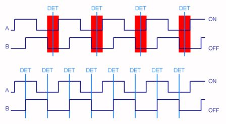

Hi all,
i have some problems with this attanuator (Farmtech software, R2R no VU). I have try software for ATmega16 and 32. The problems is when i use encoder. When I turn it quickly ATmega go to sleep or reset. Every time. I didnt try remote.
I use this encoder: http://home.comet.bg/datasheets/Buttons/ED1112S-ok.pdf
Is this problem with this encoder, should i have to chnage it for another, or i do something wrong?

Encoders
Rotary encoders with detents have 2 different patterns (from those i have tried so far).
1) ALPS - BOURNS: In each detent position, both A and B outputs are 0V (LOW state). A small debounce space beside each detent position is also provided.
2) Panasonic: In each detent position, output A is either LOW or HI, while output B is not specified.
Your encoder has same pattern like Panasonic.
You must use a same pattern Encoder like this of Farmtech original project, unless you should change the program code.

Encoder Patterns
In the attached pic you can see for what i am talking. Both patterns are obtained with COM pin of encoder connected at +V.
The upper pattern is that produced from ALPS or BOURNS encoders. The blue vertical lines are detent positions. The red shaded area is the debounce time offered.
The lower pattern is that produced from Panasonic (and your own encoder). I hope you can understand why B output of encoder is not defined. It can be either HI(On) or LOW(Off) because its transition edge is located exactly at the detent line (position).
On my own view, ALPS pattern is most easily implemented in program code because its A & B outputs have fixed LOW(Off) state at detent positions.

Thanks for your reply. I will try to find ED16112O or ED16112M.

Today i was try this encoder : BOURNS|PEC11-4020F-S0024|Incremental Encoder | Farnell United Kingdom , found it in local store, and i have the same problems described in post 551. This encoder is without detents.
Do I have to use strictly ED16112O or ED16112M for this project? On the picture is datasheet for those encoders:

Hi Boban
Pinout of this encoder is:
Left pin = A switch
Center pin - Common terminal
Right pin = B switch
Try to connect A (Left pin) and B (Right pin) in inverse way on PCB, A in the place of B and B in the place of A.
