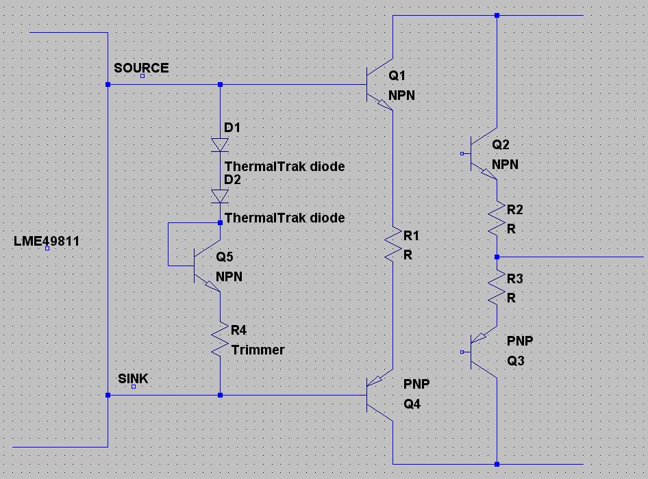

Because of above limitations I decided to left the STD03's alone and continue with the ON Thermaltraks. However it has to be said that the sound results once all is working with the STD03's really sublime is, and in line with the very best I've heard.

The driver temperature in a double EF output stage shows substantial variation. If its Vbe is not considered in the thermal tracking loop. We will end up over bias. I use the NPN driver connected as diode and insert it in the bias generation. It is attached to the driver heatsink, separated from the ThermalTrak heatsink. The arrangement shows better overall bias thermal tracking performance. I will present test data very soon.If you talk about discrete drivers after the chip, How would you compensate them for temp?

@Tom. So far impressive results for a first attempt! The biggest downside about the STD03's is that you can only use the diode string one way since the side attached to the base is not accessible. This is really pity and because of this you are forced to use difficult tricks to run multiple pairs parallel.
Tradeoffs, tradeoffs.... And thank you. Yeah, I'm really quite happy with this amp.
I experiment as well with a pot per pair, but never really got them equal.
If I build the bias circuit with just one pot and the diodes in parallel as you have done, I get about 10~15 % difference between the emitter currents of the two devices. This is caused by device mismatch between the STD03's and the emitter resistors (+/- 5 % tolerance). If I use two separate bias strings, I can tweak it so the transistors' emitter currents are within +/-0.5 % with a little patience. The currents through the two diode strings will differ - probably by the same 10~15 % as with the parallel bias scheme. There is no way they will ever be equal. The voltage across the diodes + pot is the same for the two strings. So if the devices differ slightly, the currents will differ slightly. Ohm's Law in action.
Important to watch is do not exceed the advised 40mA (max 60mA according to Jan Didden). Above 60mA the system will suffer thermal run away and you blow up all devices I tried many attempts to bias them in class A but that is not possible with the STD03. In my case everything above 60mA resulted in (longer term) thermal runaway and self-destruction.

How does the performance of ON's Thermaltraks compare to Sanken's? At a fifth to a third of the small quantity price of the STD03s they're certainly interesting despite the much lower hfe.I decided to left the STD03's alone and continue with the ON Thermaltraks. However it has to be said that the sound results once all is working with the STD03's really sublime is, and in line with the very best I've heard.
EDIT: measurements buried in this thread, notably from Doug Self. Haven't spotted any data from a 49811 driving ON parts at typical powers, though. So my question still stands...
I looked briefly at ON's TT devices also. I planned to use them as an alternate had I not been able to get the STD03's. Note that the TT diode in ON's devices is NOT on the same die as the BJT. There's quite a bit about the ON Semi devices in Bob Cordell's thread, specifically around post #77.
Having the TT diode on the same DAP as the BJT will obviously help with the thermal tracking. But having the diode fabricated on the same die as the BJT would be even better - same process, good thermal connection, good device matching. The parasitic cap mentioned in the Cordell thread can be dealt with and reduced with proper layout.
Having the diode be completely separate and pinned out separately from the BJT does offer more options as far as the bias circuit goes, though. That's a nice touch of the ON devices.
Note that the ON Semi devices are single BJT's. No darlington here... Hence, the lower Hfe. So you'll need driver transistors. This will make the thermal system more complex.
In the end, the simplicity of the STD03 + LME49811 was overwhelmingly appealing to me. And I was able to get the STD03's at a good price so that, obviously, factored into the equation also.

Very neat Tom,
I don't doubt you the amplifier works great, and I don't want to be the skeptical here, but don't you find it a bit tricky to run the amplifier without any Zobel on the outputs? Did u check for oscillations?
I suggest for extra stability safety margin you mount at least one 5W10R together with 100nF from output to ground.
I build many amplifiers over the years, and without Zobel unexpected by a change of cable type or cable position the amplifier can suddenly start to oscillate.
