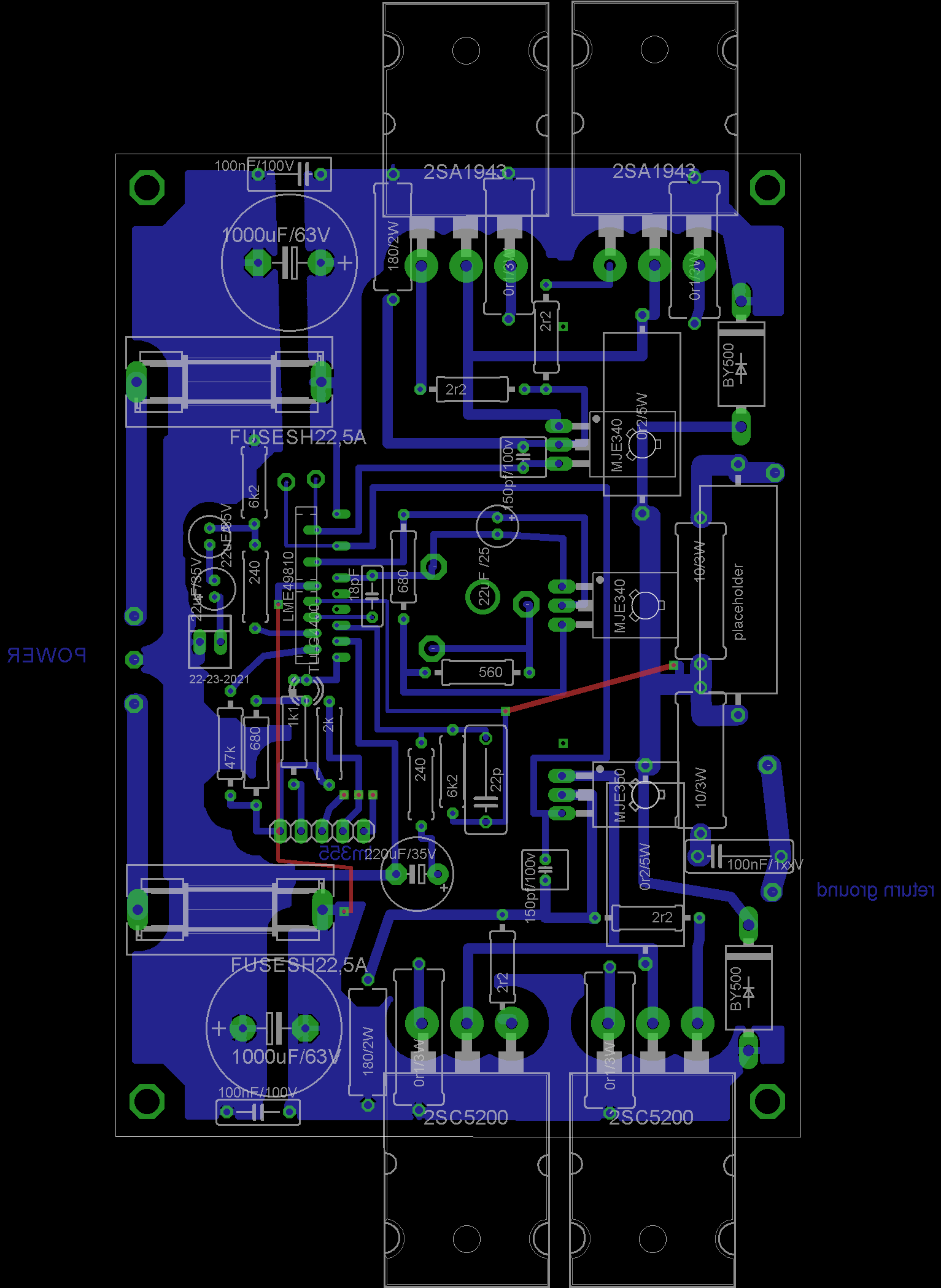

After a LM4870 and a dual LM3886 amplifier I wanted a little bit bigger and better.
I’m using a 300VA toroid with 2 32VAC sec. That would gave me around 45V, in paper of course. In reality sometimes more than 50, so 63 V capacitors is needed for safety. I calculating around 100W in to 8 ohm, and 120 6 ohm, no 4 ohm loads (if this wound be a perfect world. It’s not). The two pair is adequate to it per chan. (2SC500/2SA1943). Pre drivers hmm maybe MJE30/50 or Toshiba I don’t know right now. Open to suggestions.
Input independence is low, but I wanted to keep the DC balance from the other side.
You can see the input LP and a HP, 3 hertz (same as in the NFB loop) and 136 kHz.
Also lowered the gain from 29 to 22, because this version doesn’t have a VI limiter and make it a little harder to clip it. And not least make the NFB resistance smaller.
Also the single pole is bigger for stability and I don’t need more. The slew rate around 25V/µs. Later I’m going to try two pole too, but now let see it is stable enough for it.
The interesting part is the clip pin. I want to know when it clips, so then I can ignore the PGA2310s values das no overload. I don’t know that I can just connect an arduino pin to it or I need a transistor for it, like in the scem.
Every part of the schem is free for argument and advice.
Thanks.

Hi Zolux,
I would rather go for a '49830 with MOSFETS and no predrivers. Do BJTs sound any better?
J.
J.
Well technically BJTs are more linear. MOSFETs are more rugged and need more voltage (voltage controlled ampl.), and the most cases people chose it in big amps, because MOSFETs are somewhat immune to second breakdown (well Zeners are not a bad things on the Gate leg) . But lme49830 does not have a clip pin. If wanted to build a bigger then 200+W amp, I would build a FET one too. You can found a good ref design in High-Power Audio Amplifier Construction Manual by G. Randy Slone. If i remember correctly. (nope it was Designing Audio Power Amplifiers by Bob Cordell)

Looking foward to this project, I have something similar in my mind, I might help with PCB design, my idea was to use single output pair because I have 8 Ohm speakers...

Well, finally had time to build it. But there is a problem, as always. Limiter resistors are in hell temperature under no load.
In the fuse place there is a 27R 5W resistor, and its gets hot in 10 sec. Both sides. No DC output (~+24mv). First I thought that I made a short cut in the driver stage but no. There was a heat sink in the drivers and VBe transistors. The PSU 8A T fuses are holding. The output transistors are warm, but i think only the BIAS. There is no short cut far I can see, so maybe its a design problem.
Bias should be around 1.35, based on the resistors and the trimm pot (500R) is in middle position. I dint measured it yet. No wires reserved (good old + in - place and vice versa problem).I also measured the heat sink around 4mV, so only some static distract thing. Every transistor micad. No other thing gets hot.
Soo I have no idea what is the problem. I will measure the rails and bias voltages, but i think the problem lays in other place. Any suggestion?
Begin by turning your bias pot to maximum resistance.
And then measure your bias current.

What are "Limiter resistors" ?
Vbias set to 1.35V is probably too high.
You are biasing a single pair of Vbe. That can be around 1.13V to 1.24V
Add on 10mV for each of R5 & R8 and you get Vbias from ~1.15V to ~1.26V
Do as Zol suggests.
Turn the VR to maximum resistance for first power on. Check all your voltages to ensure no errors.
THEN start setting Vbias by measuring distortion at the output. This will probably result in Vre ~5mV to ~10mV.
Do as Zol suggests.

Technically the limiter resistors are limiting the current so, if I made a bad wiring should heat up and show that "Jeh something is not right". But I also have fuses. but I don't want to waste them in the test runs. But in normal no load ( I haven't tried it with load) conditions in class-B should not dissipate to much heat, so jeh bias it is. I calculated it with avg diode drop== bias=0.65V*2. It seems that I was wrong. I will check it at Monday. 🙂

I switched to 2 bias diodes. Bias around 1.21v somewhat over biased but good for know. The only problem now is only distorted sound comes out. Rails are 37.0 and 37.4v under 8r Load. I Checked the mute but 30k should be enough for 5-6 volts to get that 1-8 mA what is required to lme to be in play mode. Well jeh.
