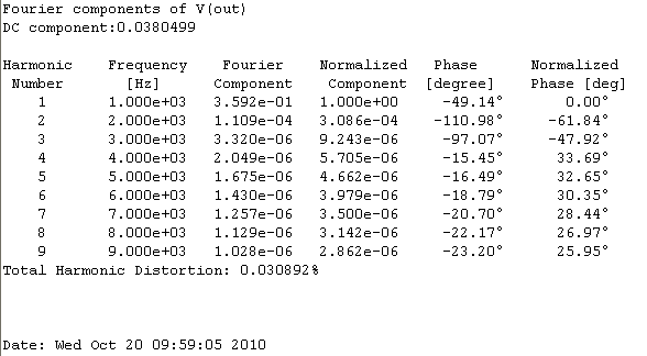

The first threads about the sSimplistic show a simple common source input stage, which could be problematic with MM-pickups due to its highinput capacitance.
Calvin
Hi Calvin
I don't think that the input capacity of the SK170 is critical for MMs. But maybe you have another JFet as suggestion...
Regards
Joao
gain multiplies the capacitance. So with high gain values there come indeed high capacitance values which, added to the cable and input-loading cap, may be too much for a correct loading of the cartridge.
By design high gm JFETs show larger capacitance values. So if the input capacitance of a circuit is a critical parameter a different design like the cascode instead of the simple common source amp could be the solution. That is the smart thing about cascoding....keeping the capitances low and allowing for high gain.
Since we ask for considerable gain a JFET alternative needed comparably high gm as the 2SK170 but considerably lower capacitance (reverse transfer capacitance in special). It´ll be hard to find a alternative, especially when the lownoise character at rather low source impedances is also required. If one could find such a part, it probabely will be expensive and hard to source.
The Ortofon 2M-series for example are high output MM-cartidges. So their inductance value is rather on the high side and they require a lower capacitive loading.
This applies mainly to the loading of MM-cartridges, while MC catridges due to their much lower inductance values are far less critical.
The hype about the 2SK170 is not entirely without reason ;-)

Hi Calvin
thanks for the reply and the facts in which I agree. Anyway, who uses MM carts - ok, the Grados - nowadays? As well we can use cables with low capacitance...
Can you share your listening experience with your MM-cartridge regarding "common source" and "cascoded input stages" ?
I´ll soon get me the 2M Black. I never liked the tonality and resolution of the Grados. At first I was searching for a nice MC. But apart from the ever present DL103 I only found the AT33PTG, which now is hard to find these days even on ebay. So I asked a person who knows my likes and my gear and whom I trust in his words about sonic character of pickups.
After him I wouldn´t find a MC-pickup around 300€ that could cope with the Ortofon. Besides Ortofon ´designed´ the 2M obviously as partners for Rega-arms. And though I have an excellent Phono-stage -optimized rather for MC than MM) I think I´ll build a simple JFET-Phono for this cartridge too. With a nominal output of >5mV it doesn´t need so much gain and I have a huge bunch of 2SK373 and some BF246A lying around.
If done well the cascode shoud perform acoustically transparent. Sure would I prefer the common source stage simply because of its simplicity, but if the input impedance of this stage doesn´t load the pickup correctly, it´s no matter of easyness or taste but a matter of choice of the best fitting circuit design.

I posted the plots in the Pass forum, the BF862 is (very) slightly less noisey than the 2SK170 and has much less C. Check out the graphs and see what you get if you don't sort

There is such a part, the Philips BF862. Easy to source, current production, cheap. Noise a bit better even. Capacitance, 3 times less. Gm, more. ''Problem''? Surface mount.

Those Ortofons are very good carts. Use a capacitance multiplier local to your cascoded head amp and a 100k Vishay bulk foil trimmer for MM input load, no added pF capacitor. Can give surprising range of tuning the cart.
