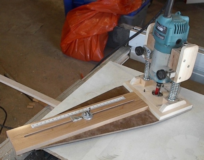

That is my homemade circle cutting jig:
The plywood is cheap 3/4 inch sheathing. I ran it through my thickness planer then lots of sanding to make it smooth.
Ah I think I see, you drill a pilot hole at the middle and then attach the jig with its screw and secure with the butterfly nut.
I used jigsaw for everything. I also have a table saw and a chop-saw, but never the less I used the jigsaw for 90% of cuts. And it does not come out good when you use the jigsaw.
Disabled Account
Joined 2007
The jig has a 1/8" pivot pin (circled in red in photo).
I just drill a 1/8" hole in the centre, put the jig in place and set the diameter using the scale on the jig. Very fast and convenient.
Nothing wrong with using the jigsaw, just this is faster and more accurate - no laying out the circle before the cut.

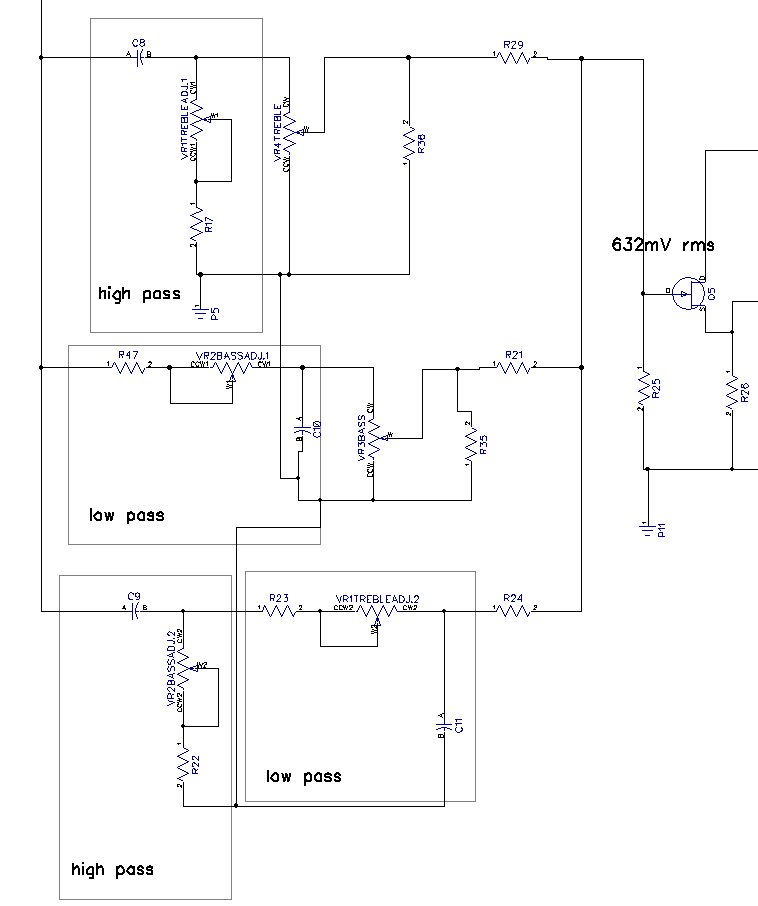

I have changed my mind on the preamp and I'm now going with a discrete design. See here for details.
