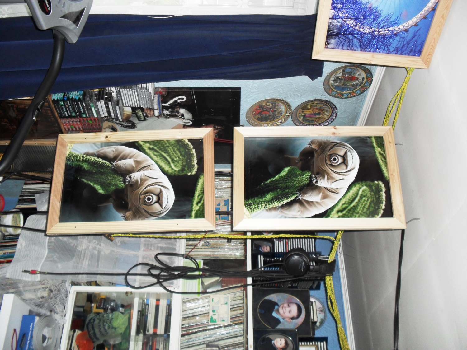

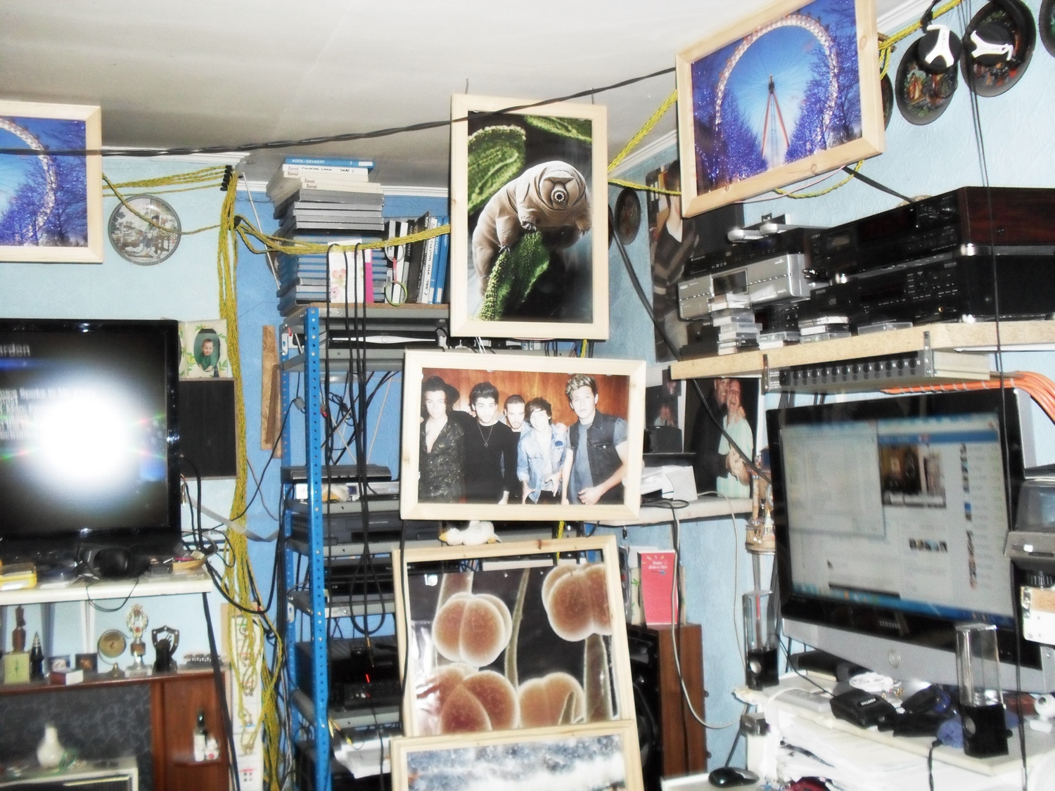

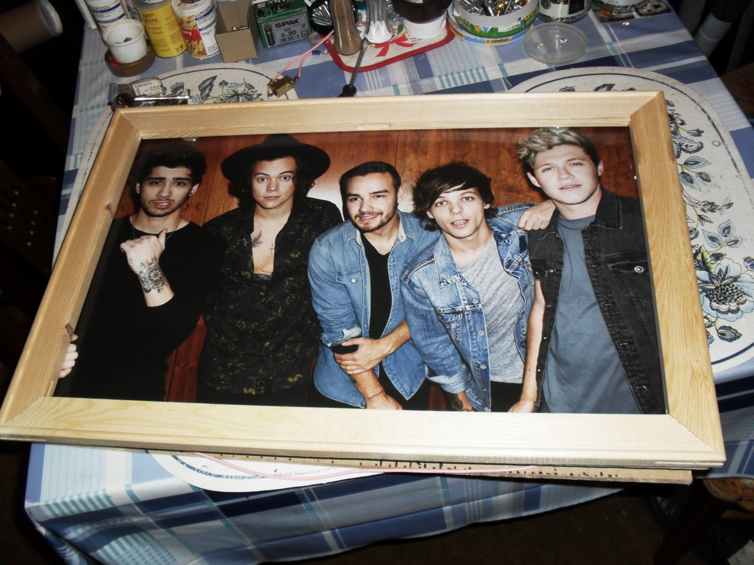

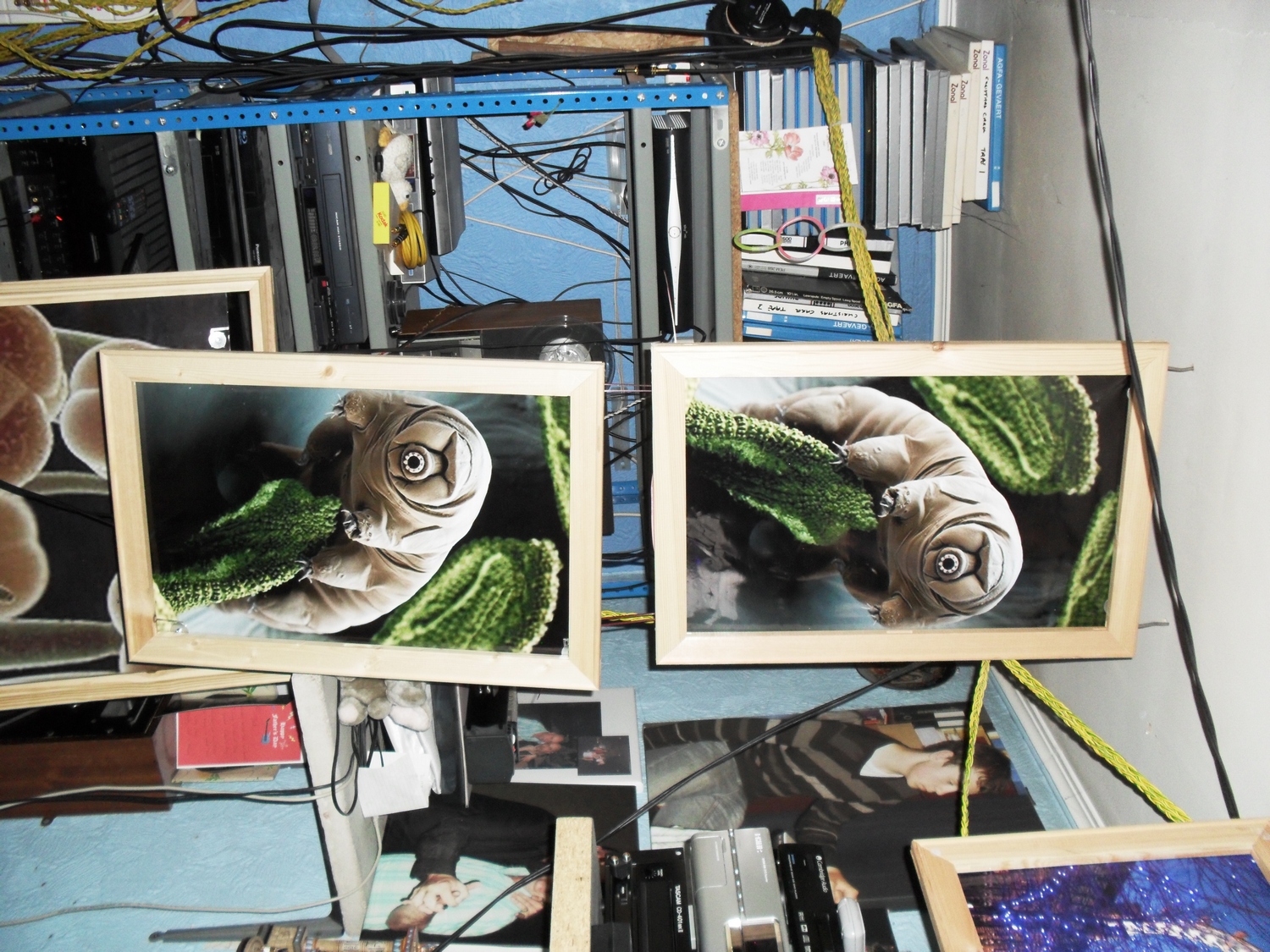

I am rebuilding all my designs again using pictures for the diaphragm, if I don't have picture I use picture paper which is white and shiny. The aluminium tape is on the inside. I use 5 mm tape with the 18 mm ferrite magnets, and 6 mm tape with the 22 and 25 mm ferrite magnets. I use 3 mm tape with my neos of 12.7 mm width, all touching no gaps. Not worth the trouble of glueing I use double sided tape to fix diaphragm using a roller to control placement. I have also placed diaphragm without the double sided tape as it is held in position using picture frame wood.
Then it's ALL imaginary.
If you say so, I'll just enjoy them in my imagination!, and keep living in my dream world!
But if you want someone to follow your design, and I guess that's why you post this, you must also post some measurements.If you say so, I'll just enjoy them in my imagination!, and keep living in my dream world!
Otherwise it'll be a wild goose chase for any follower.
MY LATEST REBUILDS
The large one uses ferrites the next 2 my little monsters use 50 x 12.7 x 3 mm neos, as I have said I don't use mylar or polyethylene any more. Quite happy with results no more funny noises caused by the noisy mylar!
I am not interested in anyone following my designs, just trying to help you build a simple light design that works. This as been my goal over the last 15 years. I think I have finally reached that goal, after many years of trial and error!But if you want someone to follow your design, and I guess that's why you post this, you must also post some measurements.

As I suspect that an English pudding is way too sweet for my taste buds, I still want some measurements of your design.The ultimate test of any design is what it sounds like, nothing else matters, as they say the proof is in the eating of the pudding, and my pudding tastes wonderful, and is easy to bake as well!
It is the only way that we can use in order to know if it is worth while to follow any of your designs.
