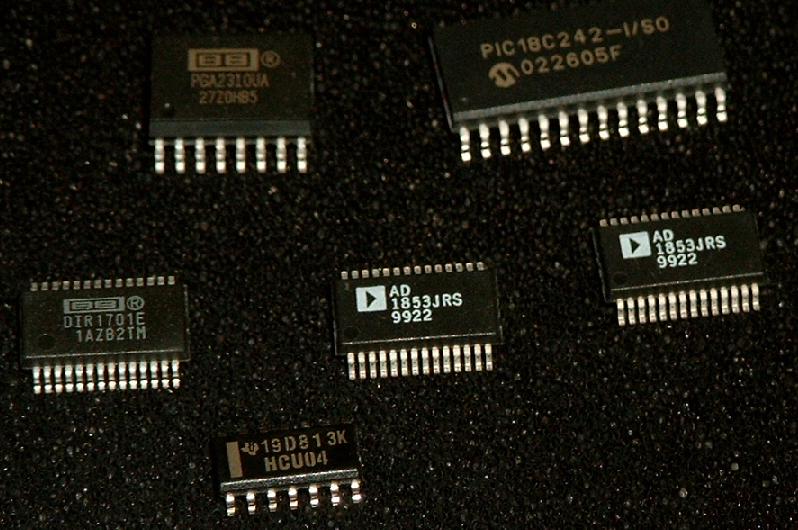

A picture of the parts to start with :

Hi, I am also currently drawing up a project with the AD1853, but with a CS8420 on the front end. Are you planning on using 2 1853's (mono mode) , I see 2 in the picture...

Are you planning on using 2 1853's (mono mode)?
- Yes!
