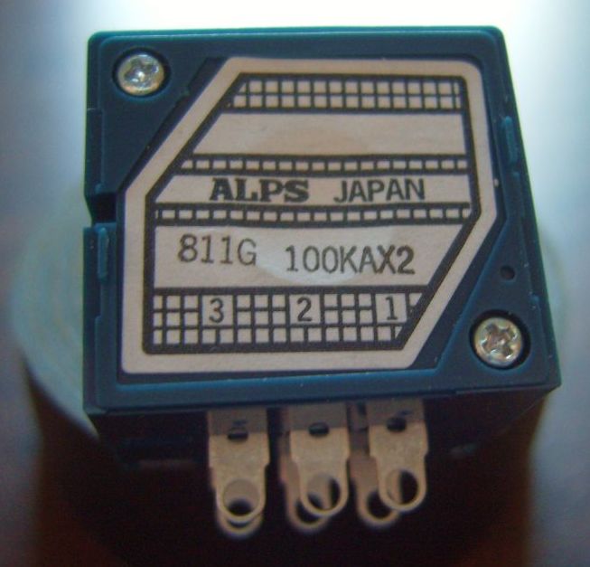

Nate, the pot arrived this morning. Customs form is dated 11/4/08 so that's about 6 to 7 business days to arrive here in NH.
However, it is not quite the model I was expecting. This is marked with a model number of 811G. Not sure quite what this is and can't seem to find it in my Alps datasheets. It is, however, a dual 100K audio pot and housed in a "blue velvet" case with a 6mm shaft.
Can you post a picture of the label? Does it say 100KAX2 on it?N1ESE said:However, it is not quite the model I was expecting. This is marked with a model number of 811G. Not sure quite what this is and can't seem to find it in my Alps datasheets. It is, however, a dual 100K audio pot and housed in a "blue velvet" case with a 6mm shaft.
n_maher said:Can you post a picture of the label? Does it say 100KAX2 on it?
Yup, says 100KAX2 on it.
n_maher said:Isn't that # just a production code?
Could be. I'm not up on Alps numbering.
