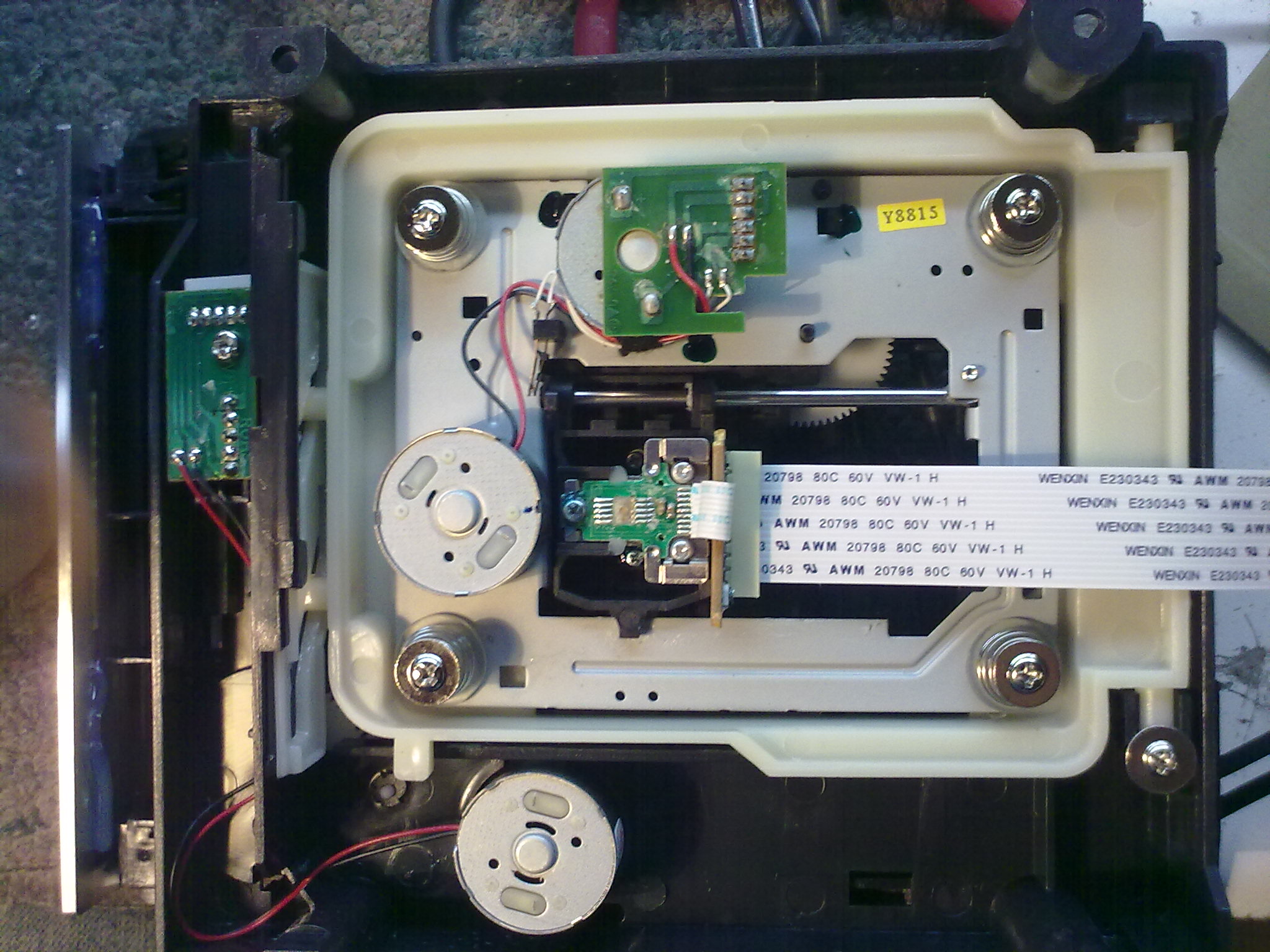

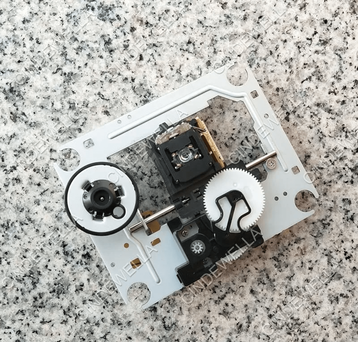

That looks like a Sanyo head. You shouldn't have problems with these normally.
You pretty much have to install the head / mech the unit was designed for. Servo tuning could be different, and it needs to be aligned. You can't just stick a new mech in and expect it to perform well. It may work, but alignment makes a big difference.
I assume it is new? Have a good tech used to working on CD players look at it.
