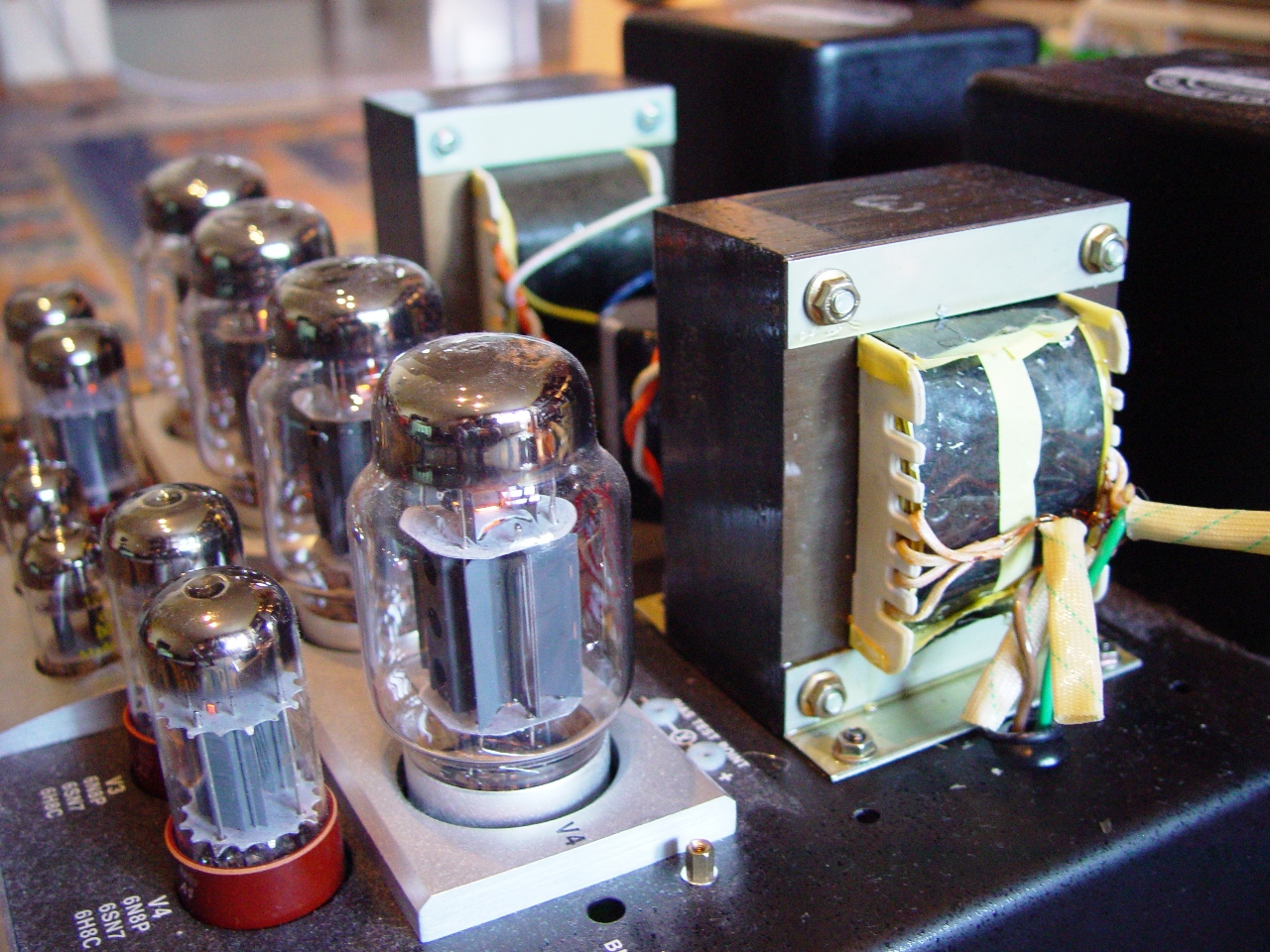

Hi Duncan, I know long time is passed since you published this post, but I would like to know if full image is still available.You might find this useful.
I have one of these amps, a most excellent sound.
Using one in the UK means I need to step down the mains 240volt supply or the heaters run at 7.4v and every thing is a bit stressed. I use a buck transformer this works very well.
Duncan
sorry about the quality, email me if you want the original jpeg. 1.24Mb
If yes, could you plese send me a copy to eddi at frigos dot it ?
Thank you in advance and best regards!

I once heard a tube McIntosh system, three decades ago, and the memory is etched in my mind forever. So....after many years of solid state home stereo, I found a 2 year-old Yaqin MC100B in great shape for the princely sum of $366 US.
This is my first post on any hifi forum. I take all my toys apart, but know nothing about tube amps. So I am standing at the top of a steep, slippery slope. I will be reading voraciously. This thread has been very interesting. I am likely to "roll" some tubes. Perhaps some Gold Lions to start.
I am going to read carefully through some earlier posts in this thread in which folks recommend certain voltage adjustments. Bear in mind I am a relative newbie. This amp has pairs of ports in the chassis so the user can place test leads in and measure voltage. This is adjustment of the (4) Kt-88 output tubes. There are also four ports into which a tiny (2.5mm) hex tool can be inserted to adjust voltage.
The voltage readings I got were:
1) 329 mv
2) 367 mv
3) 0.571 V
4) 315 mv
I believe #3 is simply a function of my meter's auto ranging, and that 0.571 V equals 571 mv.
Anyway......am I on the right track? Are these voltages ideally set in the 450 mv range? It seems to me I read something like "45" rather than the factory-set "55-60". This does not compare with the readings I am getting. If a figure of 45 is desired, are we talking 45 100ths of a volt? Help me out here. I will go back and re-read.
1) 329 mv
2) 367 mv
3) 0.571 V
4) 315 mv
The manual says 550mv-600mv with is a current of 55-60mA thrue a 10 Ohm resistor. You just measure the DC voltage on the testpoints and devide it with 10 and now you have the biascurrent.
Ah hah! 10 ohm resistor. So this is why I am measuring about 350 mV at the test ports? And this means a "bias" of about 35 mV?
Okaaaay....... 35 mV bias is not enough. Factory says 55-60. Some guys say 40-45 for longer tube life. One guy says that's not enough.....resulting in a flabby bass. The bass my amp is making is flabby. Hmmmm.......
You are correct that 35mA (that is the amount of current going through the tube (read up on ohms's law)) is too little for a KT88. I think that in general a KT88 is fine with 50mA and with a good solid power supply and not too high a plate voltage 60mA is good. So go ahead and try 50mA which is 500mV on your meter. That might improve the sound some.
I don't know exactly why your phono stage damaged the amp, but it seems likely that it could have been an issue with grounding. I hate to blame the amp but some have observed all sorts of weird wiring mistakes in the Chinese amps in general. A quick look at the schematic which you posted on another thread seems to show that there is NO safety ground wire on the amp, i.e. it has a two prong power cord. This is something the shop where you had the unit repaired should have fixed without asking.
Here's the deal: it is possible that the amp or the phono stage is leaking voltage onto the chassis. If you connect the two together there will be a voltage difference between the two chassis and so the interconnect becomes a current carrying link. It was not intended for this purpose and will fry whatever is connected to it.
Plug in the phono stage and, using the AC voltage reading on your meter, put one probe on the ground ring of the RCA jack and the other to the ground pin on the wall outlet. If there is an AC voltage reading there try changing the orientation of the plug (assuming it is a non grounded plug). Do the same thing for the power amp. There should be no AC voltage reading at all on the chassis or the RCA jacks which should be internally connected to the chassis. If you get an AC voltage reading on the amp take it back to the shop!
The power cord is a standard cord, separate from the amp chassis. It is a thick thing that includes ground prongs. There is a male ground prong along with the hot and neutral prongs on the amp chassis where the cord plugs onto it.
Plug the phono preamp into the RCA connectors at the front of the amp? This is perhaps what fried the amp in the first place, and it would cover the connector so I could not get at it with a test probe. Or are you suggesting that I check resistance between the ground pole on the chassis where the power cord plugs into it, and the outer (ground?) ring of the RCA jacks in the front of the amp (0.6 mV)? That would make sense.
Or perhaps I should disconnect the power cord from the amp chassis, plug the powered preamp into the input connector at the front of the amp (0.6 mV), and check to see if there is voltage at the negative pole where the power cord goes?
This I don't get. Again, the power cord is a modern cord, separate from the amp chassis, with three conductors. They are oriented in a triangular shape at the amp end.
Amp end? Sorry, I do not follow.
Also, every time I have ever used my multimeter to look for voltage, I have found it. I think I can find voltage in a tree or sidewalk. A tiny amount, but it's always there.
