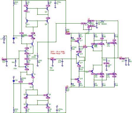

This version is scaled to deliver 50W in 4 ohms in class A (I’m actually building this one ATM). The OPS has a closed loop gain of 5. Without any TPC or TMC and a very manageable ULGF of only 2MHz, its 50W/4-ohm THD-20 sims in isolation as follows:

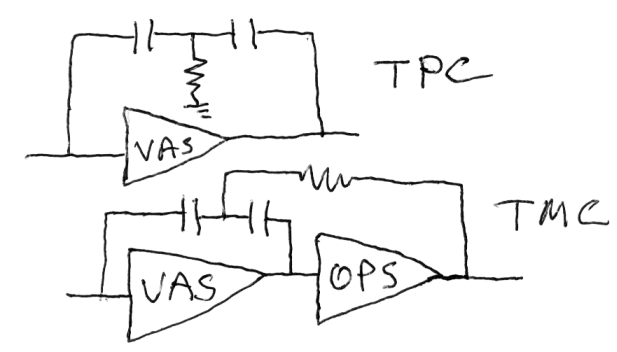

I’m using TPC in the final version, and coupling it to the modified TPC “Blameless” frontend that I described in that other thread a while ago.
The input stage distortion is effectively minimised by the reduced voltage swing; and don’t underestimate the linearity benefit of only needing 1/5 the voltage swing from the frontend! (Another trick I use here is to not lower the front end voltage rails accordingly).
Anyway, this basic CFB OPS augmented with TPC and coupled to my version of the “Blameless” frontend sims waaay under 1ppm THD-20, and is still a relatively simple design.
