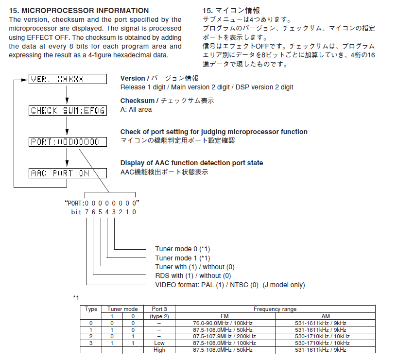

Could not find the exact manual, but found one for an RX-V440. Thinking it may be close in some respects, and out of curiosity, I dl'ed it. It was interesting to find a section on how to read the MP settings. Even more interesting to learn that there are tuner settings for the bands based on regions, which confirmed my intuition. What was missing was any detail on how to configure the MP. I think there must be some kind of bench diagnostic tool to do this. I also think that unless leaving it unplugged for an extended period does the trick, I am going to be out of luck. All advice is still welcome, and at least I am getting closer to a final determination. Much thanks all around!

After I posted this today, I found a service manual online. It had information on what the default settings are supposed to be, and how to reset them, which I did. My unit is not lining up with what they should be according to the manual. I guess it is toast - disappointing! For the life of me, I don't know how this occurred, and why it cannot be resolved. As I thought about it, I seriously doubt that Yamaha is going to tell a user how to muck around with a unit beyond what they have provided me already. So, I either find another, or else I use this one for it's remaining capabilities. Thank you for your suggestions, I truly appreciate them.

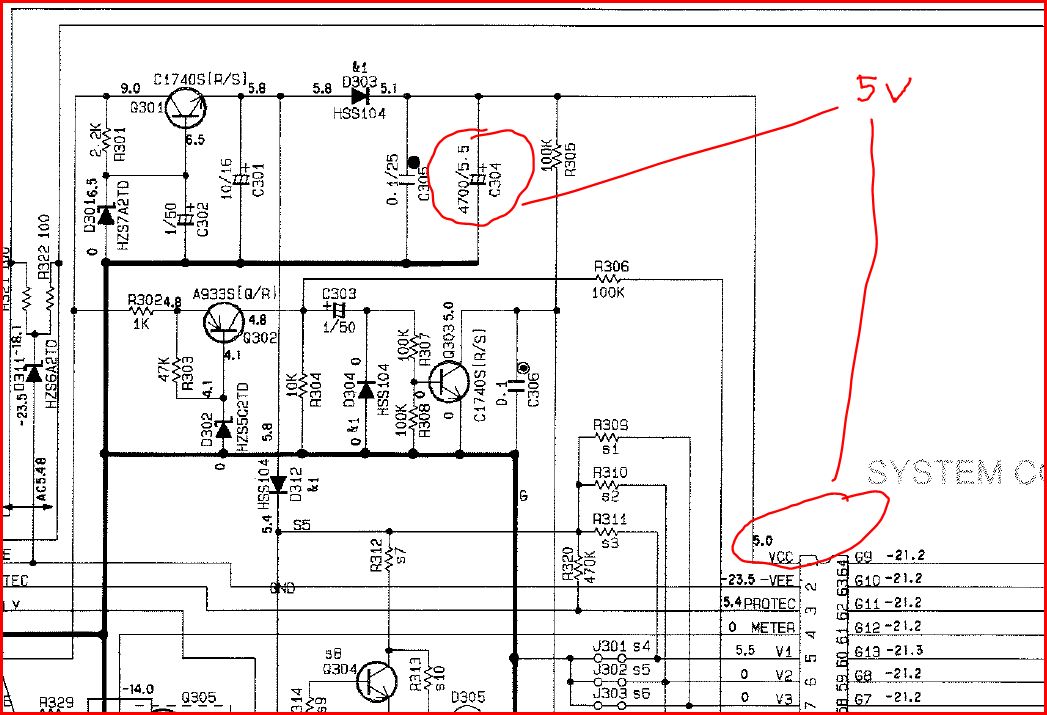

Sorry to show my lack of knowledge here, but I don't even know how to check the things you have suggested, although I am more than capable of giving it a go with a little TLC ;=}. I have a schematic from the service manual, if I shared that could you point out what to check and how? I have a V-O-M meter, but not a silly-scope. Anything is worth a try in my book. Thanks much!
Administrator
Joined 2007
Its no problem :)
Here's the backup 5 volt supply. With the power TOTALLY OFF check what the voltage is on this cap and pin of the system control processor. It should be 5 volts.
Assuming it is, then what you then need to do is to discharge the cap with a resistor (anything from 100 ohm to 10K ohm).
You then have the option of trying it all again. If its still the same then repeat the discharge procedure and then totally remove the cap I ringed. Try it again and see if it will set up.

I stumbled on this thread (and forum) Googling specs for the RX-V480 because there's one for sale near me. There's probably nothing wrong with it; 76-90 is the FM broadcast range in Japan. That said, there may or may not be a setting to actually change it, so no big deal if you already tossed it. But if you haven't it might be worth playing around with or at least reselling.
