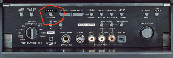

To find out what is causing the specific problem you have to go into diagnostic mode. Usually you have to press "power" together with "A/B/C/D/E" And tuning right button. The first thing that is displayed is the last failure code. From this you can understand what the issue is. PS1 or PS2 means that one of the voltages from the stabilizers is not Ok. Mine had this code - required to replace 2 voltage stabilizers which failed due to bad contact with heatsink (broke the stabilizer after about 8 years). The part was cheap but took some effort. Another unit I had had bad output amp (shorted transistors) this comes up as PRD or DC - which means there is DC voltage on amplifier output. You need to look in the service manual for your receiver what the code is. Good luck.
What the heck is a/b/c/d/e???
PRR
