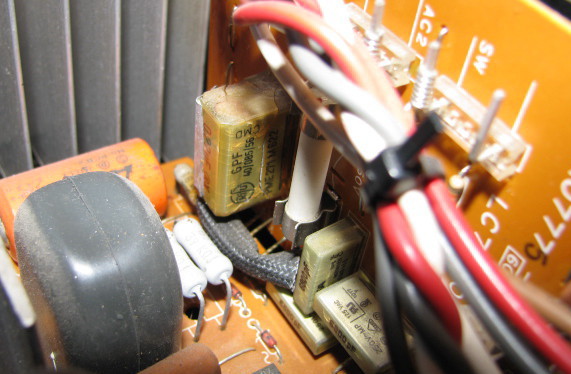

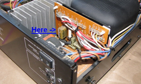

Hi Mooly/Unclejed - I am asking these basic questions because I am just getting into electronics after years of wanting to be able to repair my own stereos. In this case, with a low value cap, I thought I would venture out a little. Reading up on the fundamentals of electronics, and got myself an oscilloscope, but that's for later. So, I really appreciate all the education and advise that I am getting from you guys on diy! This is fascinating!
So, I checked for continuity (w/o plugging into the wall!), but with the power button on. One side of the cap is connecting to neutral, and the other leg has continuity to the other incoming power. So, you're right. Bascially this cap sits across the main supplies, on the primary side (so it must be the noise filter cap as unclejed mentioned). I am not sure if I will ever know the root cause...also, I'll try to post some pics tomorrow. Thanks again.
Across the incoming supply sounds right. Nothing in the amp can have caused it to fail. It's either "just one of those things" or a mains spike has finished it off. Having said that it's worth checking for anything like loose fuseholders etc or loose screws in any mains plugs.
As to a replacement, as Unclejed says it's value isn't critical at all, but it's good practice to get one that fits properly. There is nothing worse than seeing bent legs all over the show

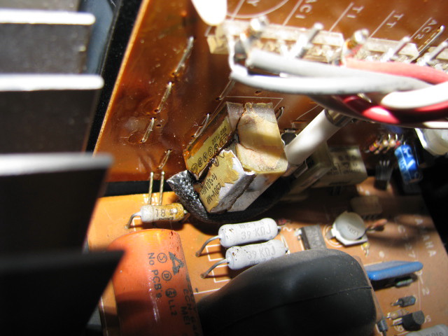

Mains filter caps these days are often what are called "self healing" meaning that a "short" occuring in the cap is actually "repaired" by the offending material being vaporised internally without you being aware anything untoward has occured.
Mains filter caps are normally specified as "Class X" or "Class Y", class X normally being used between live and neutral, where if failure were to occur it would not pose any threat to life anyway.
In the UK with 240Vac ( well 230 now officially but nothing changed only the tolerance ) I would always go for a 275 Vac Class X for anything like this. 240 Vac is 680 volts peak to peak.

Quite an old fashioned fault is that Take the cap out and clean up the PCB with paper towel and alcohol or WD40 or similar, anything to get any carbon of the board where the cap has gone up. Make sure the board is clean and dry.
Then test the amp, just to make sure all OK. You can run it without the cap fitted. Back at the start you mention using an UPS etc. How do you power the amp ? I don't think I would use it on anything like this. Just use it direct on your wall supply outlet.

I see on the photo Crashed Rifa cap., well it is very strange for exactly that type of Rifa transparent caps which is printed inside.
I saw a lot of the same case crashed caps in 80's power supply's from the PC's.
So I started to hate that kind of caps a long time ago.
Try with other cap and don't keen so much about the value and voltages, in your case the rule of the voltage :"The higher - the better".
So for the U.S. standards the cap I would recommend you don't go lower than 250VAC, and AC is very important to be marked as before explained , but don't use cap which is marked 250VDC or this can be seen like 250 V "and straight line" and the line means that it is 250 volts DC current or voltage.
The varistor can protect from the voltage spikes and You should use for your standard, here I am using varistor rated 275VAC.
