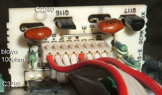

Continuing work on blow output transistors:
Traced more problems back to the driver board.
5 total transistors
2SA1306 (clamped to heatsink)
2SC3298 (clamped to heatsink)
A970
C2240 (back blown off)
'unknown' (clamped to heatsink)
3 resistors
(1) 100ohm (fried chicken) on emitter of 2SC3298
(2) 1.1kohm
2 caps
A220J Soshin
I'm wondering out loud if I should just replace all parts?
I'm seriously thinking of pulling the same channel from the
other M-45 and dropping it in. . .

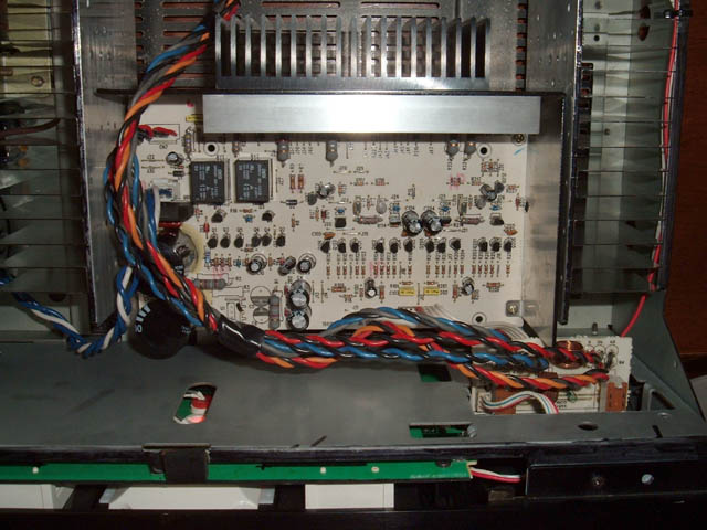

After much time researching the replacement
transistors I've come to a cross-roads.
Option A:
Continue to hunt for quality transistors for +20 year old amplfier.
Plus: Restore original amplifer sound at reasonable cost (<$50)
Minus: Might not work, more time hunting down other problems,
replacement transistors might not be matched and/or fakes.
Option B:
Swap out amplifier section and replace with new amp modules.
Plus: Quality amplifier modules, new technology, more support.
Minus: Mod power supply to work with module, different sound quality.
In the end. . .I like having three quality working amplfiers. I would also
like to keep the power meters functioning. I will be doing some
non-distructive testing of the meters to see if it will work.
Why I'm leaning towards the ColdAmp modules.
They accept the +/- 63VDC power rails of the M-45.
They run cooler than most Class AB amps and would mount
easily on the existing heatsinks.
They are relatively cheap at $300 US dollar for two modules plus
shipping. I originally paid about $410 for the M-45.
Good opportunity to reuse existing parts (instead of landfill).
