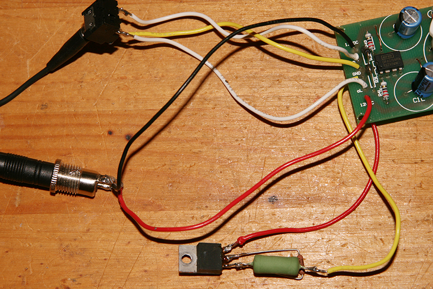

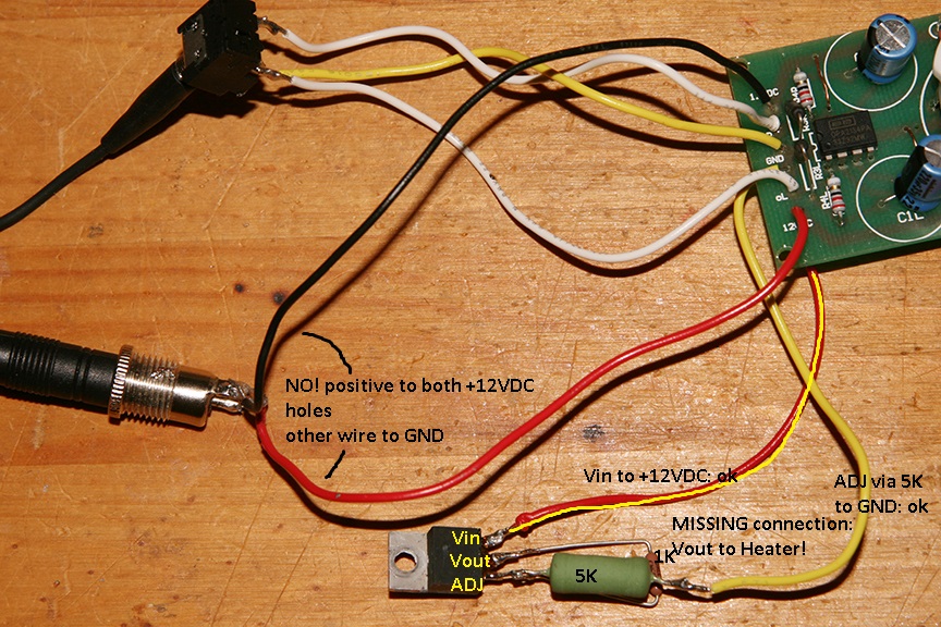

thanks dfy- I have taken the regulator off the board and wired according to the wiring diagram. Could you kindly take a look at it and tell me if I have it right. It still doesn't work but I do get a very quiet hum through the headphones. :scratch1:

Errr... did you connect the two wires from the power supply both to the "+12V DC" holes?!? That's not what you're meant to do. Let's hope you haven't fried any parts.
You have to check your power supply first to check which of your two wires (black/red) is positive. That one goes to both "+12V DC" holes, the other one goes to one of the "GND" holes!
(The way you wired the regulator looks good. But why did you take off the heatsink?! That's gonna fry it when you leave it on for too long :( )

In the picture, the LM317 is wired wrong. LM317's are not very tolerant
of being wire up wrong.

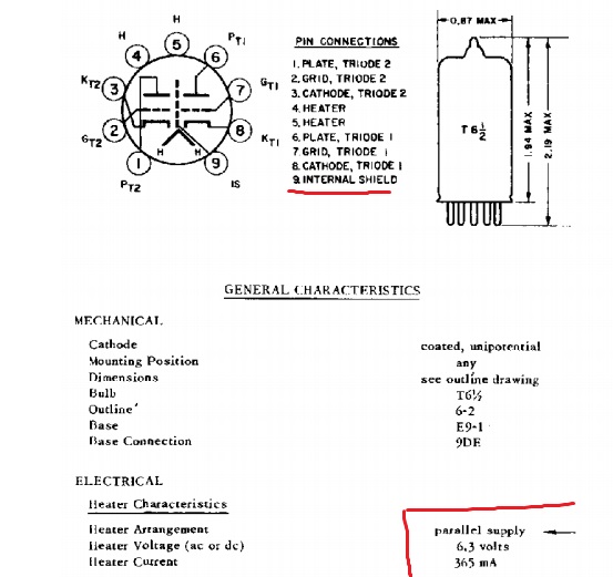

The ECC83 has dual heaters at 6.3v each. the first one is between pin 4 and pin 9 then the other pin 5 and pin 9. Hence my explanation but the diagramme of the Ecc88 valve that I have is not clear; ECC88 @ The National Valve Museum
It looks to me like pin 9 is the centre of two 6v heaters. A resistance reading will confirm this.
I have never heard of 3v heaters, ( two 3v in series?). I apologies if I am wrong.
In the picture, the LM317 is wired wrong...
Are you talking about OP's latest picture? Apart from the missing connection from Vout to the heater, the regulator wiring seems okay to me? (picture attached).

I have attached a part of the ECC88 Amperex data sheet. It would seem to me that the heater supply is internally paralleled (so they are two 6.3V heaters in parallel rather than two 3V heaters in series), and that Pin 9 is the internal shield, not a center tap of the heater. From there I would conclude that the voltage across the two heater pins is supposed to be 6.3V :confused:

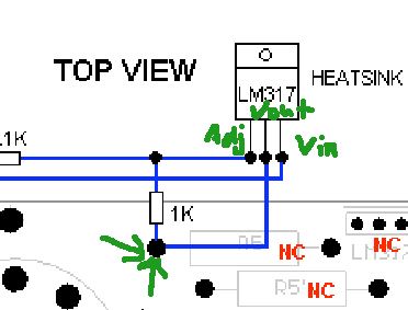

Because you mounted the 1K resistor "in the air", you are missing the connection from Vout to the PCB hole marked with green arrows in the picture below. (That hole connects to the heater via a PCB trace on the bottom of the board.)

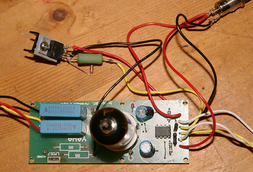

Well I have made the changes suggested by dfy and almost got it working. When I turned it on the dim light bulb flared quite bright went off, The regulator got very hot instantly and the right channel on my headphone got toasted. :eek:
Fortunately they were cheap earbuds and not good phones :D
I'm sure I've done something stupid here so once again I will need some help please :worship:

Okay, so a few safety rules first before you plug it in next time:
Power it on without phones or source plugged in of course! Then check DC offset at the output (measure voltage between GND and both channels at the output) before plugging anything in.
As to what went wrong... I re-checked all your pictures again, and it seems you have a large solder blob that connects two traces that shouldn't be and therefore put the right channel of your headphones at +12V DC. See attached picture.
The regulator may or may not be dead after this. There may be more wiring/soldering problems, really do some extensive testing with a multimeter (for connections that shouldn't be there before(!) you turn it on and for sensible voltages after you turn it on, but before you plug in phones or sources).
