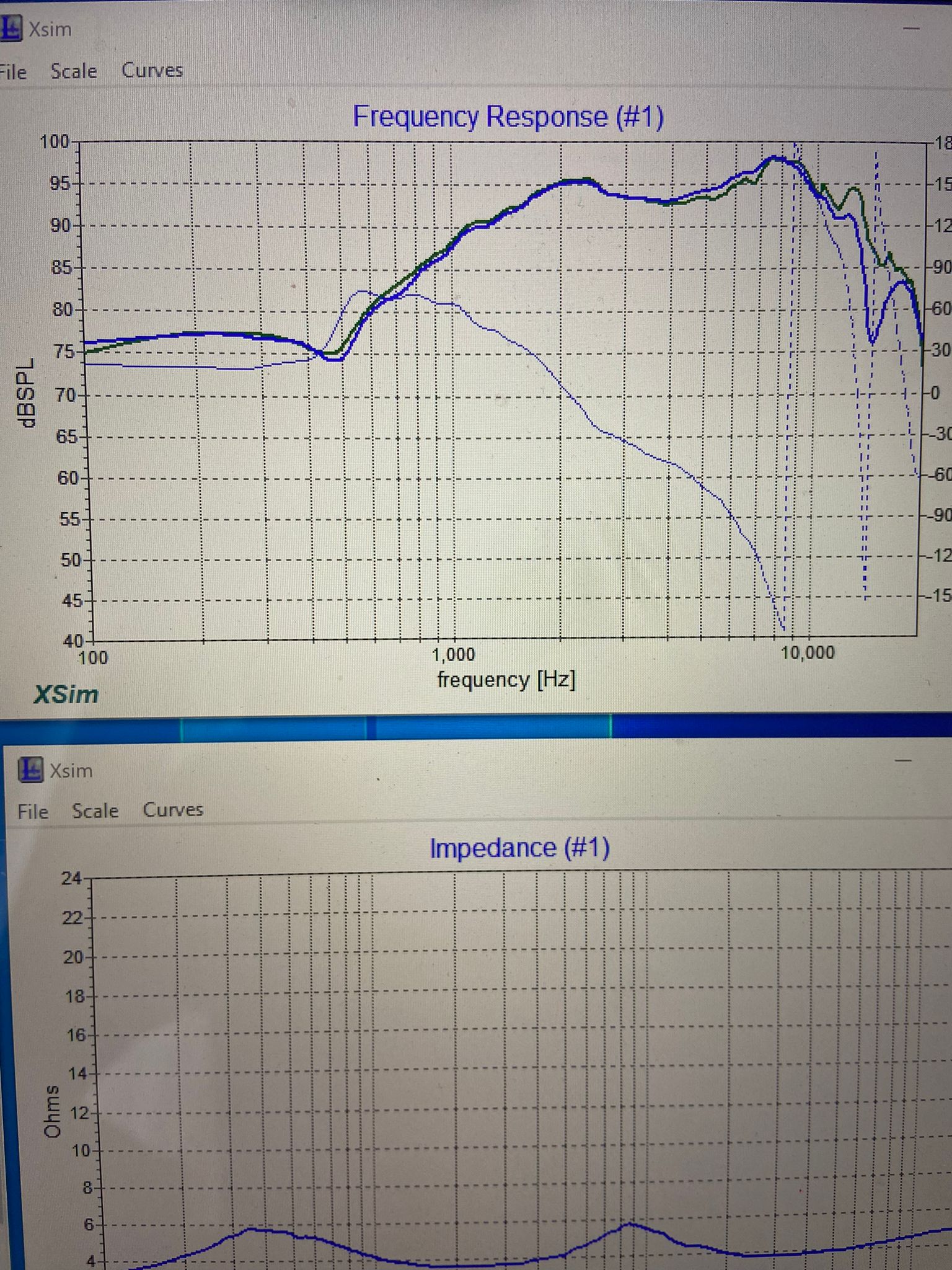

Here is the response differences before the delay is applied:
and this is after the negative delay value is applied:
Is this normal? Am I missing something or did something wrong?

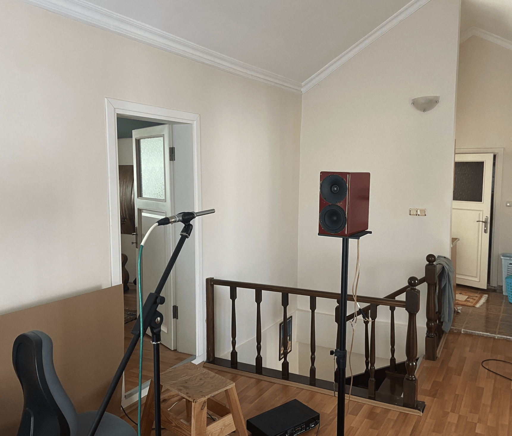

I placed the mic 1 meter away from the speaker and left a safe margin away from the boundaries (approx 1.5-2meters). which allowed me to take gated measurements from 250hz upwards. The mic is directed towards the center of the woofer and the tweeter, and I have taken all the measurements at that position (individual, and combined).
This is an old DIY build with different drivers and a preassembled crossover, which was a failure as you can imagine. So I have decided to turn them into something decent. The mic is a behringer ecm8000. It's not calibrated but I did some measurements with my studio monitors as a reference, they look quite OK.

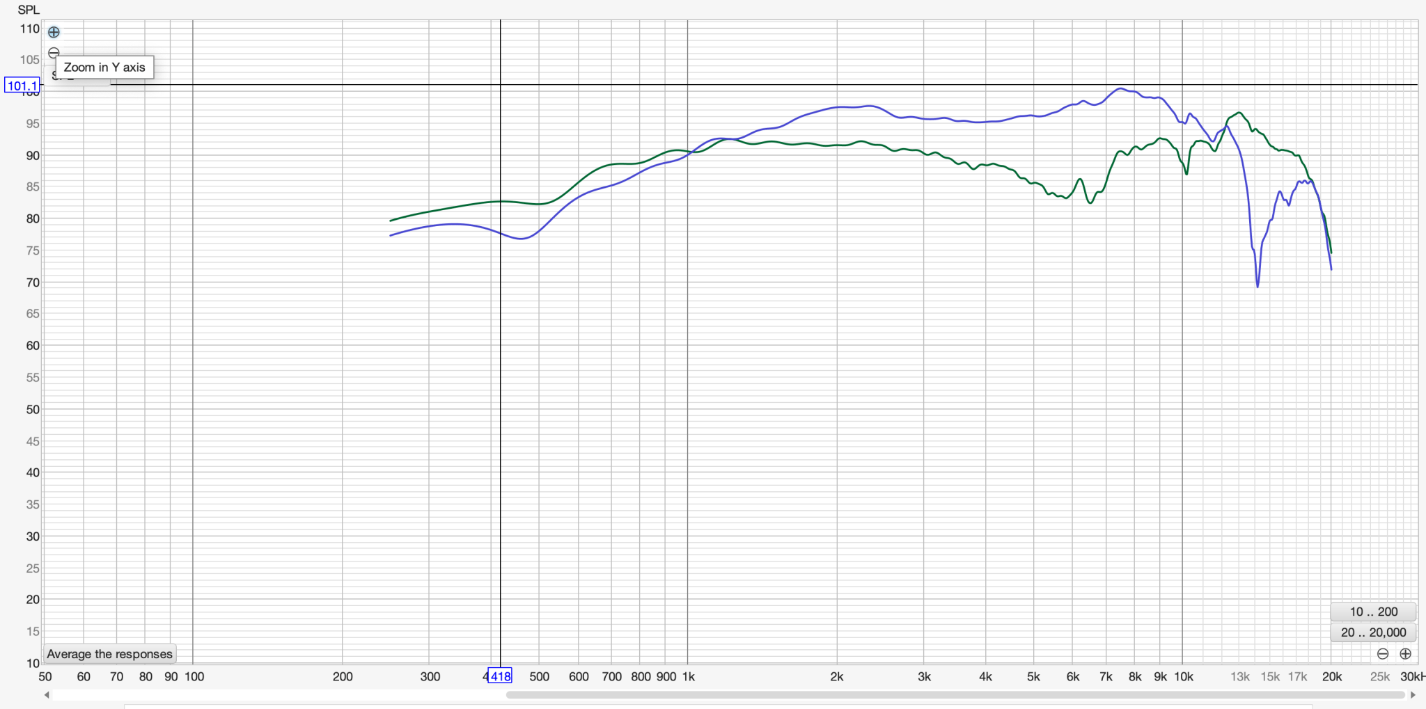

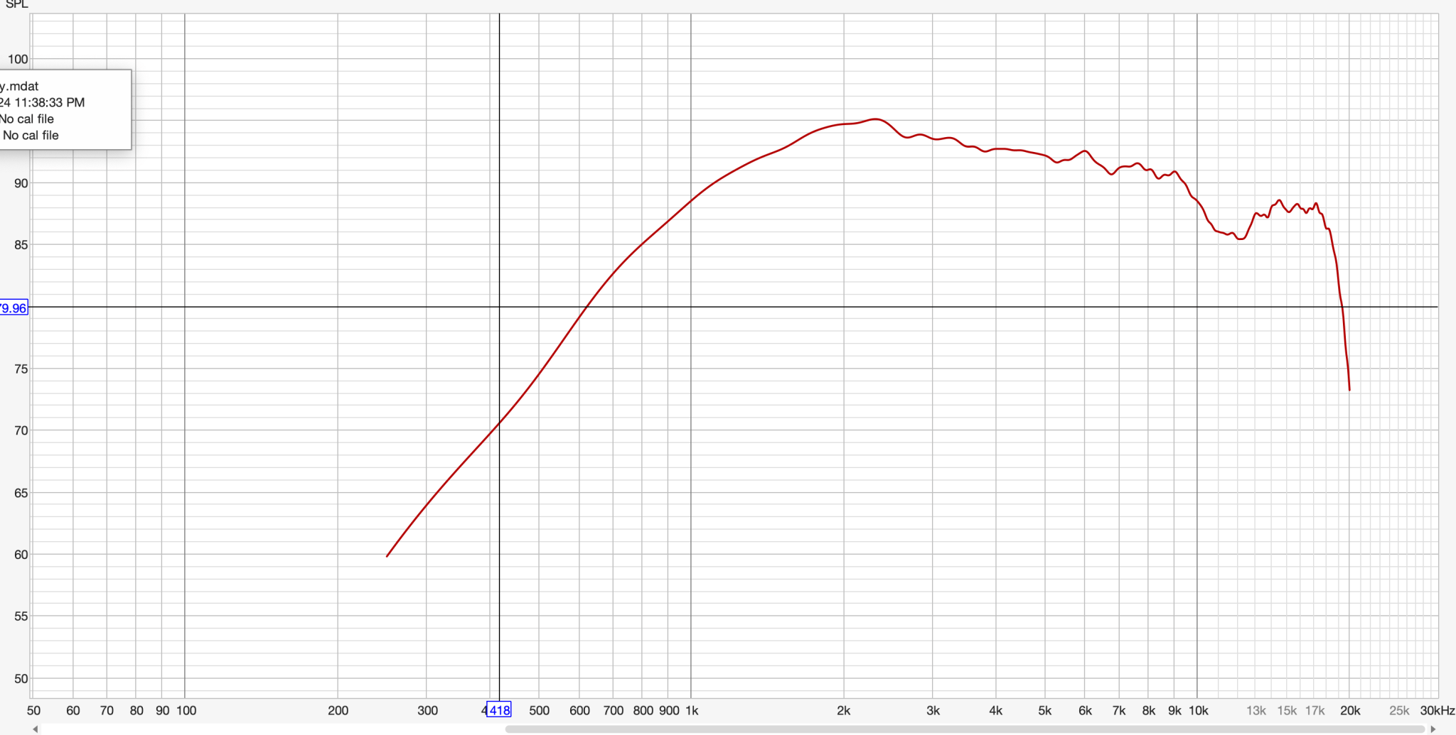

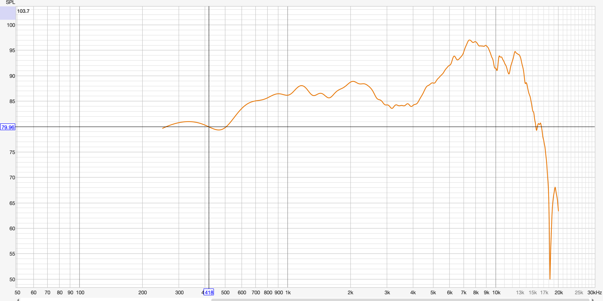

So, I am attaching the measurements
Tweeter:
TW
Midbass:
drivers combined (the green measurement is taken with the tweeter in reverse polarity):

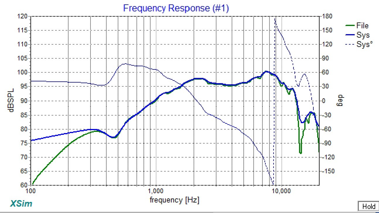

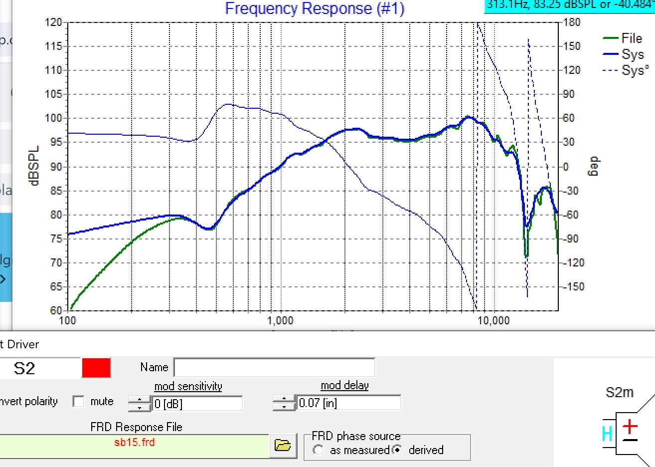

And here is how it all looks in xsim with and without mod delay. (improving the hilbert bode transformation allowed me to match them with a positive delay this time)
by the way, i measured the distances from baffle to the dust cap of the woofer and the tweeter's dome, the difference is about 2.3 mm's which corresponds to 0.09 inches

Thank you for supplying your measurements. I now better understand what's going on.
Firstly, I'd like to comment on using the Hilbert Bode transformation. It needs to be kept in mind that, for typical magnitude-response data sets, the Hilbert Bode transform results in an approximation to the phase response of the transducer, albeit a quite accurate one within its limitations. Being minimum-phase in nature, it inherently removes the phase shift caused by the time-of-flight to the microphone. Neither does it account for any variation in a driver's acoustic centre as a function of frequency (possibly a second-order effect), nor does it correctly account for the phase-response effects of sound diffraction from the cabinet edges (as multiple sound sources, such as those produced by cabinet edges, don't usually sum to minimum phase result).
Note that the raw sound pressure measurements will include all of these things. Hence, that's why you found that you needed to tweak the value of mod delay to get the best results. Admittedly the adjustment is quite small, but it's still there and tends to affect higher frequencies more due to their shorter wavelengths.
I would assume that the FRD data for the woofer and the tweeter contains the phase and the magnitude response. I'd be quite surprised if it didn't. If the microphone–loudspeaker geometric arrangement does not change during the measurements, it would be expected that the FRD magnitude and phase data measured for the woofer and tweeter should add together so that their summed response very closely matches the measured magnitude and phase response when the woofer and tweeter are driven simultaneously. This is a simple test of measurement consistency.
For best results in your crossover network design simulations with XSim, I'd recommend that you use the raw measured data for the woofer and tweeter, rather than Hilbert Bode transformed data. Your measurement setup seems able to produce all the required phase responses, so they should be utilized to get the most accurate results.

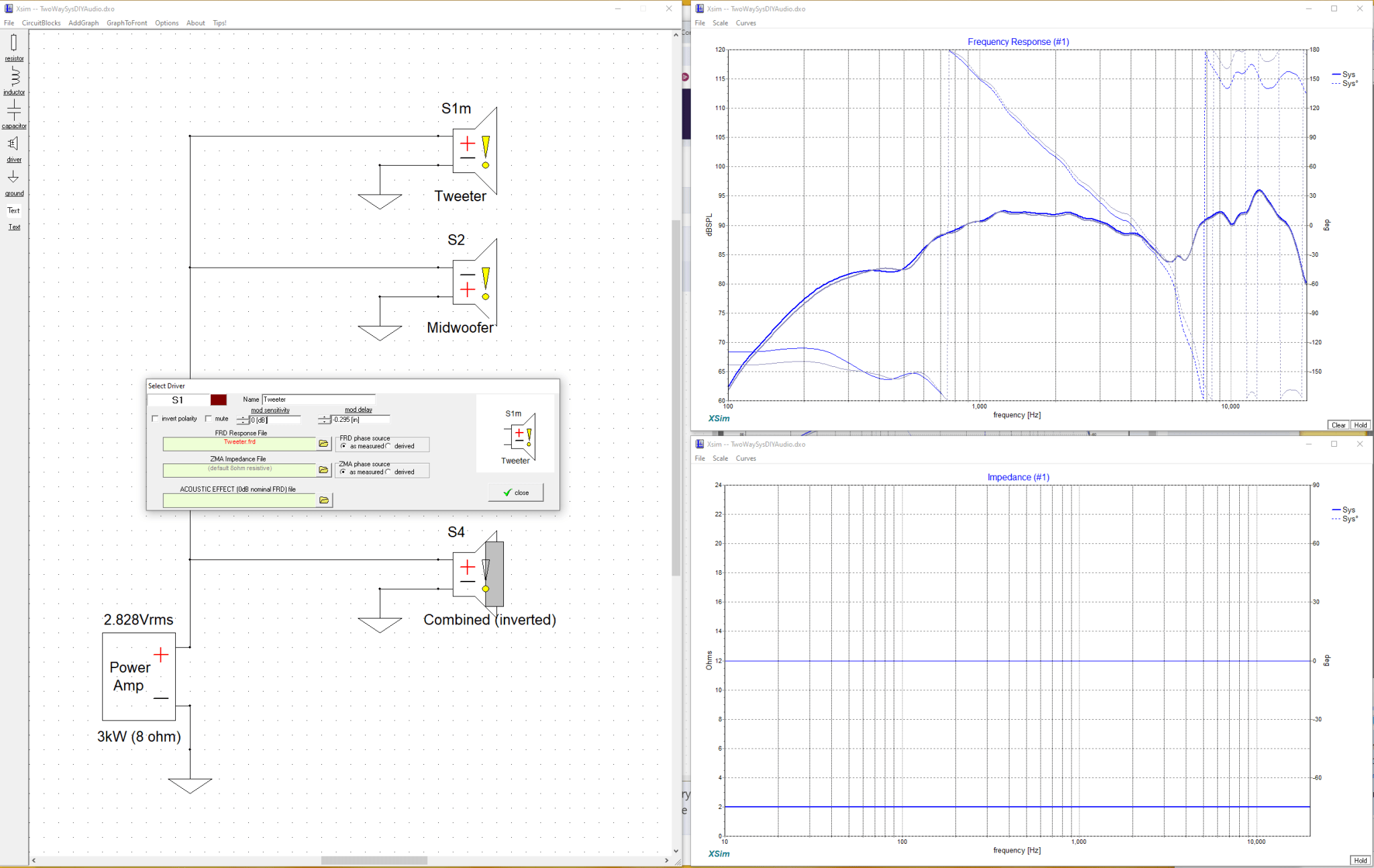

Thank you for supplying your measurement files. I've loaded them into XSim and have taken a look at the results of the computations. Below are the results comparing the inverted-polarity combined response to a summation involving the midwoofer with negative polarity and tweeter with positive polarity. The tweeter also has to have a mod delay = -0.295 inches for best results.
As you can see, the XSim magnitude response summation and the computed phase response compares very well with the measured combined response. However, I am surprised at the requirement for having to use the mod delay option.

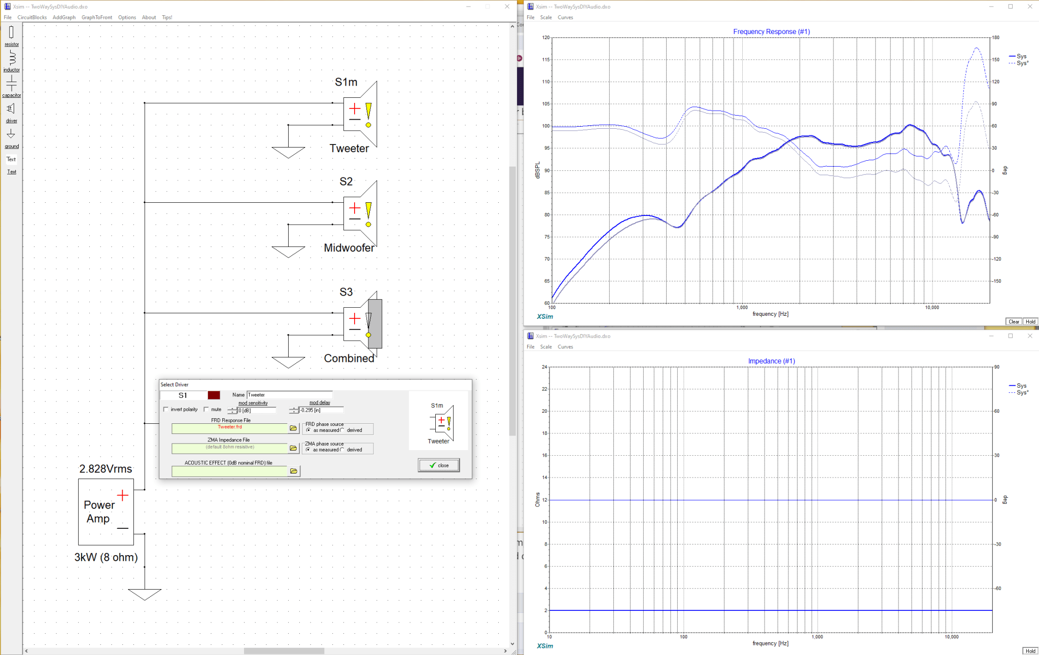

Below are the results comparing the combined response to a summation involving the midwoofer and tweeter both connected with positive polarity. As in the previous example, the tweeter has the same mod delay = -0.295 inches, which results in a very good match in the magnitudes of the combined measured and XSim-calculated responses. However, the phase response is not as good a match, with quite a large difference above 2.5 kHz. The difference in the phase response gets larger and larger with increasing frequency. I'm not sure what's happening to cause this behaviour.
As you can see, there is no need to use the Hilbert Bode transform on your data. However, I'm unsure as to why a mod delay = –0.295 inches is needed to get an accurate summation from the two drivers in both the inverted and non-inverted configuration.
I noticed that the header of your measurement files contained the comment "with no timing reference" in the third line. That could provide a clue for those who have used REW for these types of acoustic measurements.
