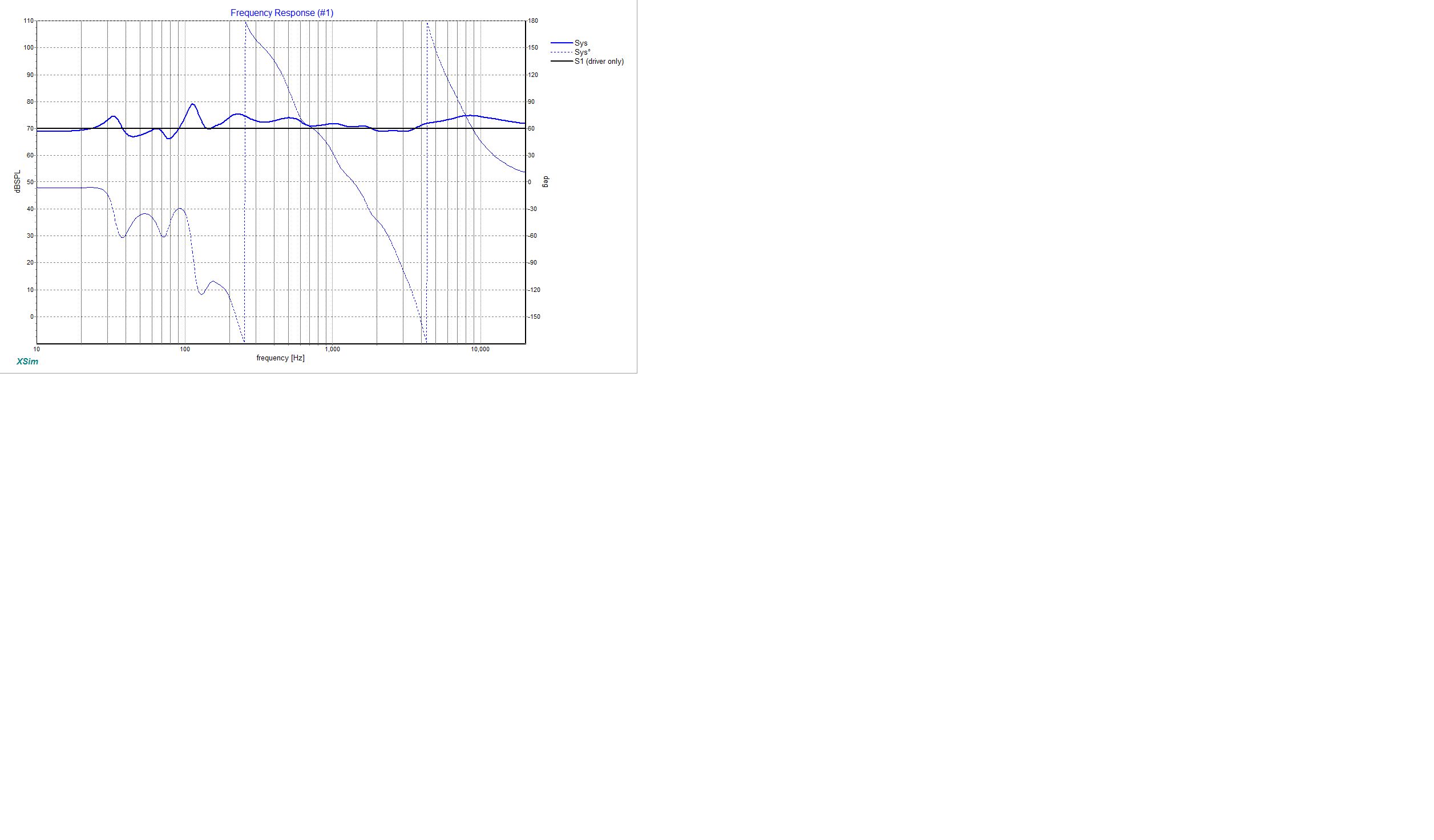

How to choose the X-Sim kind of filter to develop?You know,Czebyszew,Linkwitz etc...
I'm doing a project 4 Ways to reply MBL 101 E.MBL reports that used Linkwitz Riley 4th order.
Is Sim chooses the type of filter?
Please, a small compendium.

Fortunately I know this answer having just had this discussion with Bill. Since what matters is the electro-acoustic response, all these filter names kind of become useless when dealing wtih speakers.
Here is what I do though. Use a new speaker driver without importing any FRD or ZMA files. Use an online calculator and add the parts specified by the calculator to make this new, temporary driver look like whatever filter type you are looking for, or use a circuit block if there's one available.
You can then use this speaker's output as your reference curve. Now you can go back and match your real driver's filter to match. Simple, right? :)
Of course, I typed this in 5 minutes. Could take you 5 hours. :)

That's what this program takes account?

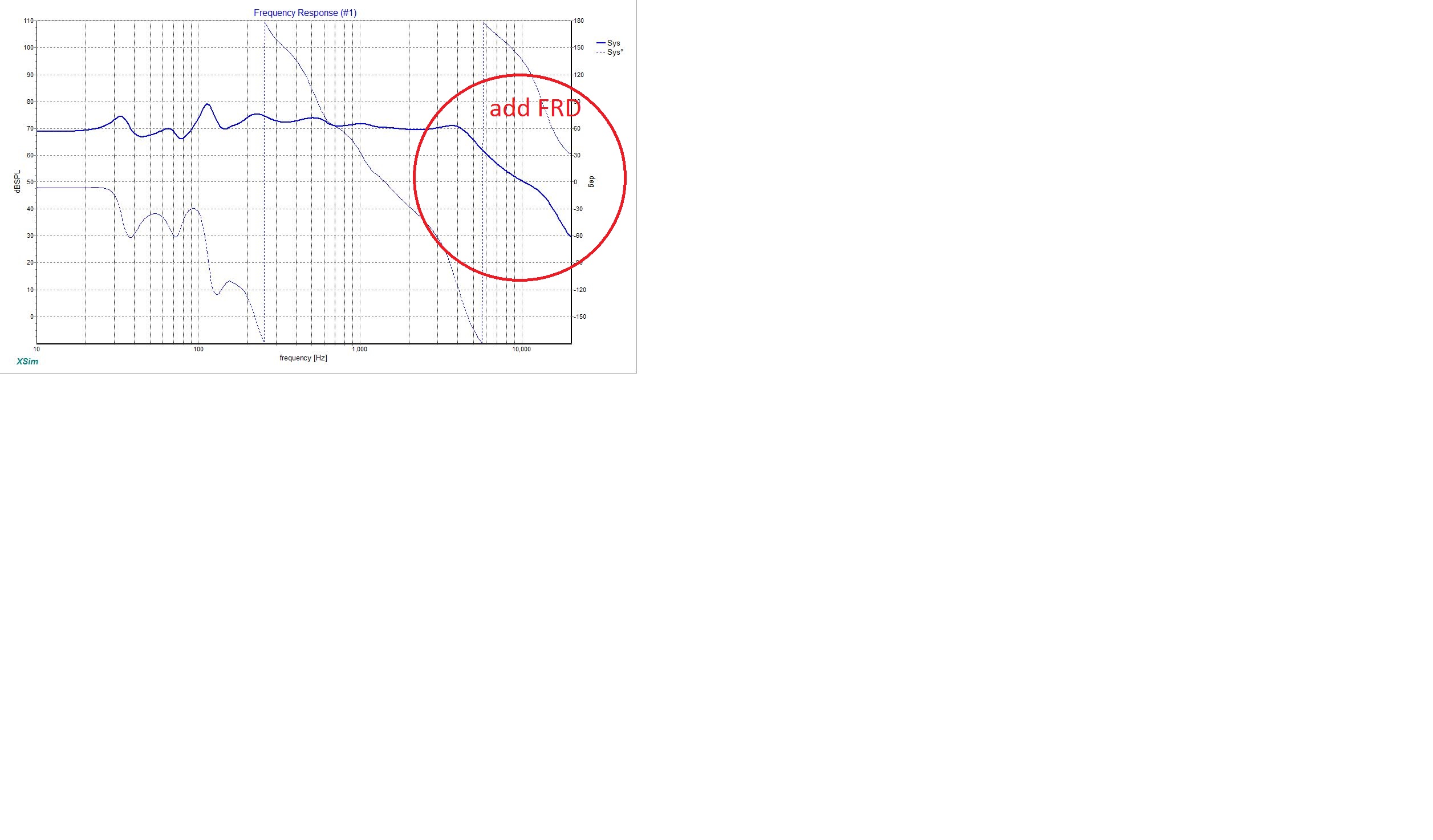

Dale FRD program from ARTA and lowered her to me high.
I made first crossovers in the calculator.To smooth the changed values of the characteristics.

Yes, using an online calculator and then just punching in the numbers
in Xsim will do the trick, only it won't take much more than typing
a message. Maybe a couple of minutes longer.
What Erik described has worked for me :)

Hi Lojzek,
Copying CL and R values is fast. :) WHat's more difficult is taking an ideal curve and matching a real driver to it. That's what I meant by saying it's easy to explain it but may take a while to achieve it.
The idea, as Patrick has put it, is that we do manual curve fitting using the online calculator and an empty XSim driver to create the target curve we can look at while altering the actual driver curve. Creating the ideal driver curve is fast. Taking a real driver and making it look like that, much harder. :)
