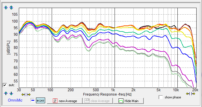

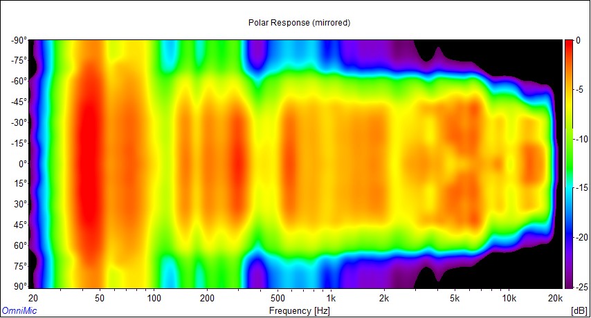

For reference, a screen shot of the horizontal K-402-MEH, measured outside on a stand quasi-anechoically, polar frequency response curves (0-90 degrees in 10 degree increments)--before I adjusted the crossover filter overlap to take out the relative null associated with the crossover frequency at 475 Hz:
I had the fonts set on 125%. I returned them to 100%, and I can now see the horizontal scale arrows:
I keep the fonts at 125% due to my demastering over an HDMI bus to my TV and audio setup. The fonts are a little too small to see them at 100% from 12 feet viewing distance on a 65" screen...Thanks for the debugging.
Perhaps adding a little margin to the polar frequency response plot will alleviate this "feature"?
Chris

Give this a try:
http://libinst.com/junk/transfer/OmniMicInstall.exe
I set it so that form isn't "scaled". Didn't think that affected font, but maybe it does. I also moved the little arrows upward a bit.
