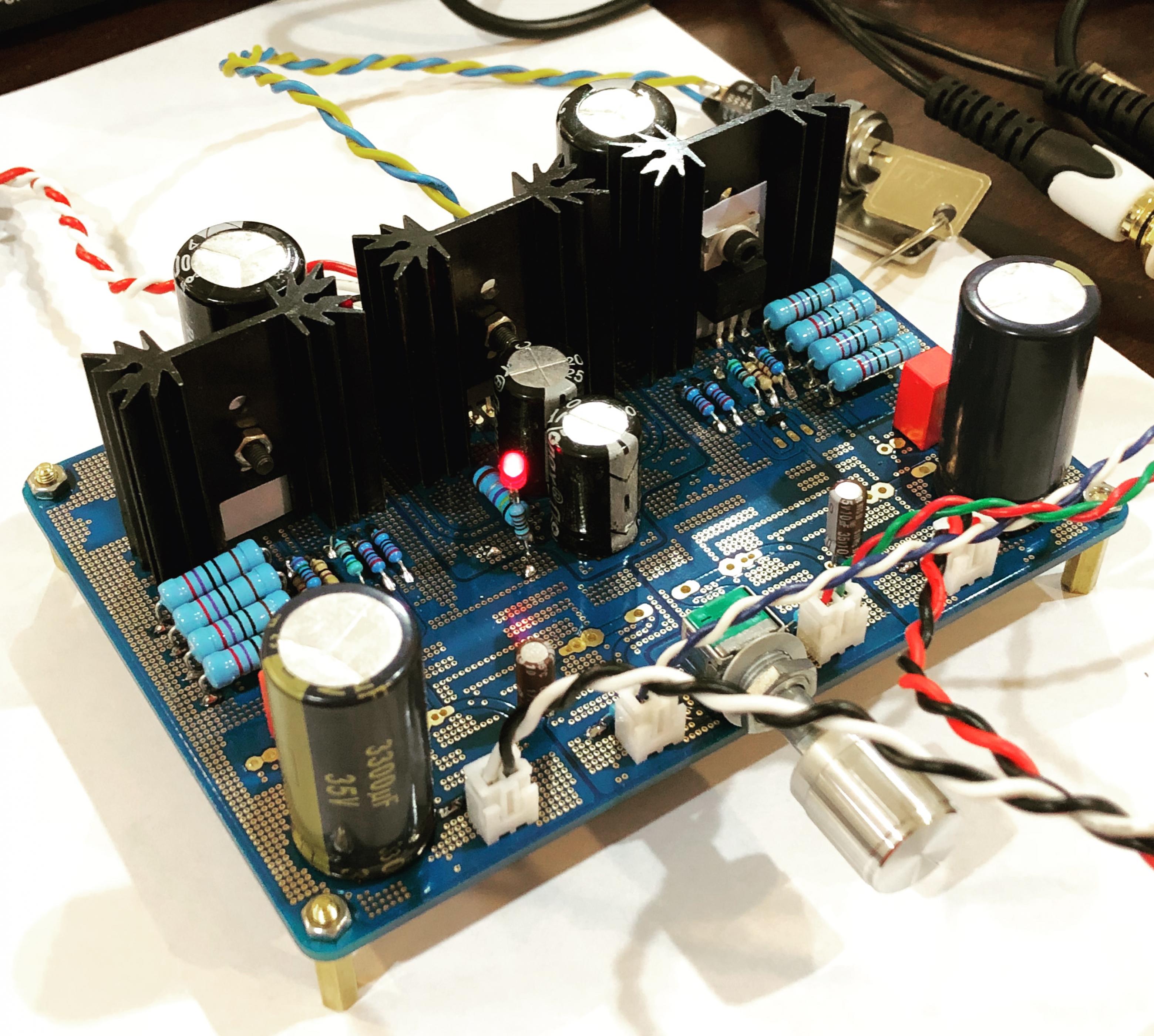

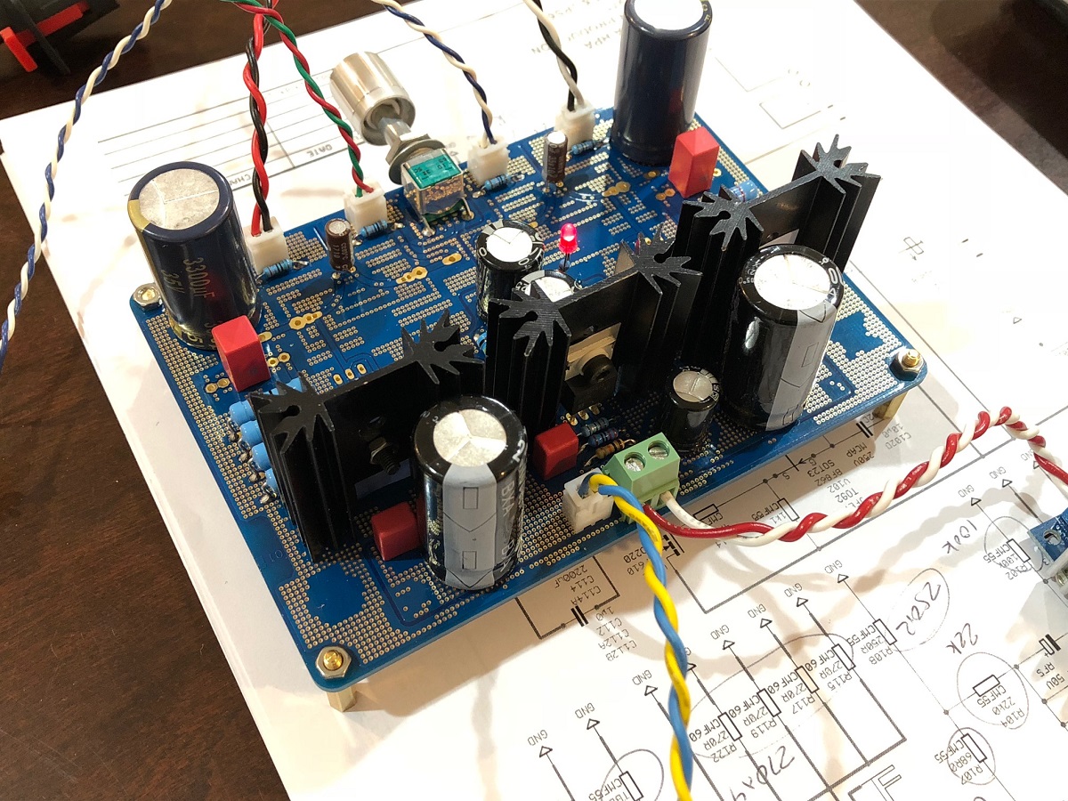

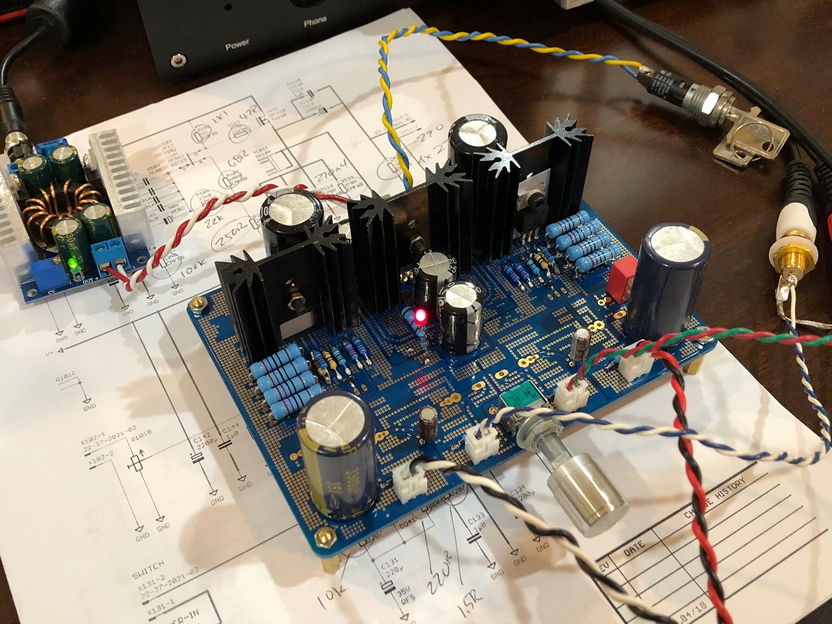

Good news, I built and verified the new Desktop Class A (DCA) amp. It works well and sounds great. An easy build.
I am using a DC step up to get exactly 20v at the amp after the Cap Mx. Running 130mA bias current:
attachment.php
Here is the backside so you can see the parts behind the heatsink:
attachment.php
Here is measuring the noise at the output with my Fluke 101 on mVrms and I get 0mV. It sounds quiet as well.
Will have to stop now and listen tomorrow. Just two songs so far to confirm PCB is good and free of itcner

Yes, because it is the very last "switch" I have on hand in my supplies. Looks cool but could be problematic is one loses the key. :)
It's a very simple build as you can see - hardly any parts except for the 4 parallel 2w resistors for the resistive load.
We forgot to ask JPS64 to include an LED power on indicator so I added it after the Cap Mx so we can see that the PSU in functional.

Running really well and superb sounding. Measuring in at 0.015% THD all H2/H3 and powerful deep bass with 150mA buss at 22v rail. Dissipating about 2w per channel.
I want to mention that this is a really really easy build. An ideal first project or gift for someone new to DIYA.

what step up are you using to power it? Looks beefier than the one for the pocket version.
I shall get started on finding the parts later today. was planning to have the PCB "bare" so may have to find a way to mount some jacks onto the board
Something like this works well - the blue ones seem better than the red ones, in my experience.
DC-DC Converter 10/12/15/20A 150/250/300/400/1200W Step up Step down Buck Boost | eBay
Search eBay or Aliexpress for "DC DC step up 10 amp"

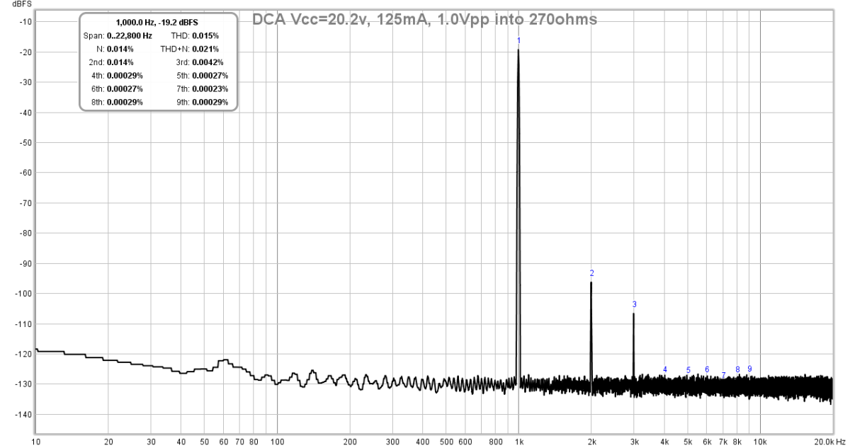

Some Measurements of the DCA
This is with the 56ohm/220hm mod on the resistor network as described above. I found that the harmonic profile can be tuned with the Vcc setting. There is even a point where you can make it H3 dominant. But to do this requires looking at real time FFT and adjusting the Vcc. I have found that the ideal harmonic profile lies right around the design voltage Vcc=20v, and with FFT monitor, it is 20.2v to be precise but this varies for each amp due to variations in the actives.
Source was a Cayin N3 DAP loaded with a high res 1kHz sine wave. The FFT was measured with a Focusrite 2i4 at 48kHz. Load resistor is built in 270ohm at output JST pins.
For 20.2v Vcc, 125mA bias, I get 0.015% THD and this profile:
attachment.php

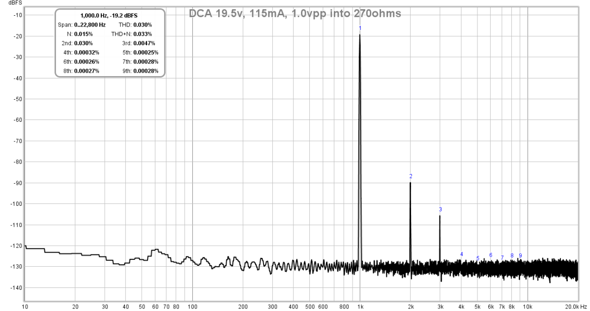

If you like it more tubey sounding with higher relative H2, set to lower voltage of 19.5v and THD is 0.03%:
attachment.php

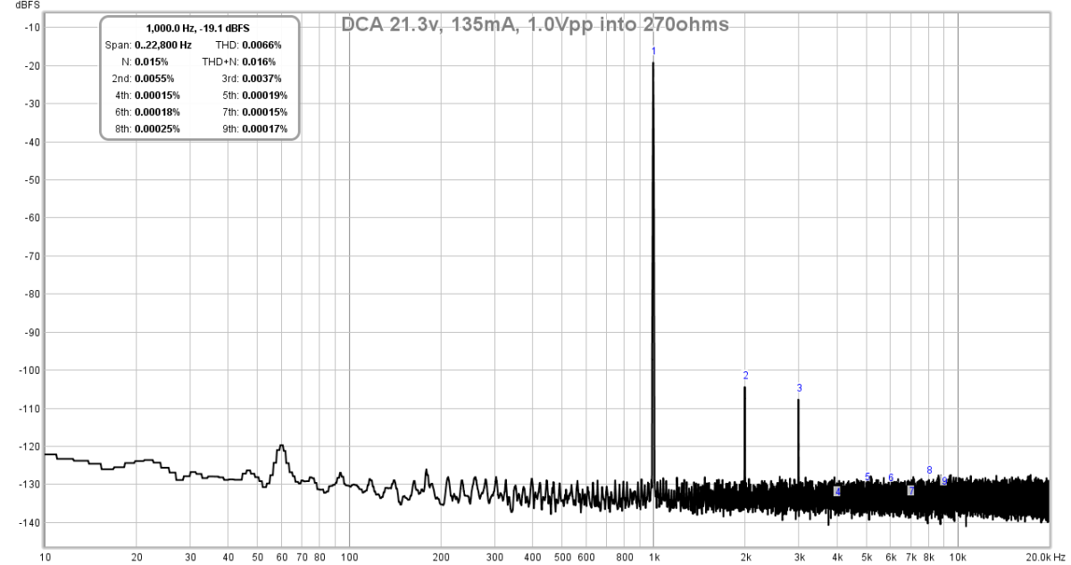

If you like really low overall THD of 0.0066% and about the same H2 and H3, set to higher voltage of 21.3v:
attachment.php
So having a variable DC-DC step up is really useful. We can see that the design of the PSU is working well to really keep the 60Hz peak low. The overall amp layout design is excellent and sounds very good. Extremely low noise. The slight rise in the FFT towards 0Hz is due to a large 10uF input coupling cap that is letting infrasonic noise through. Uses of 4.7uF input cap would reduce that - not that it is audible.
