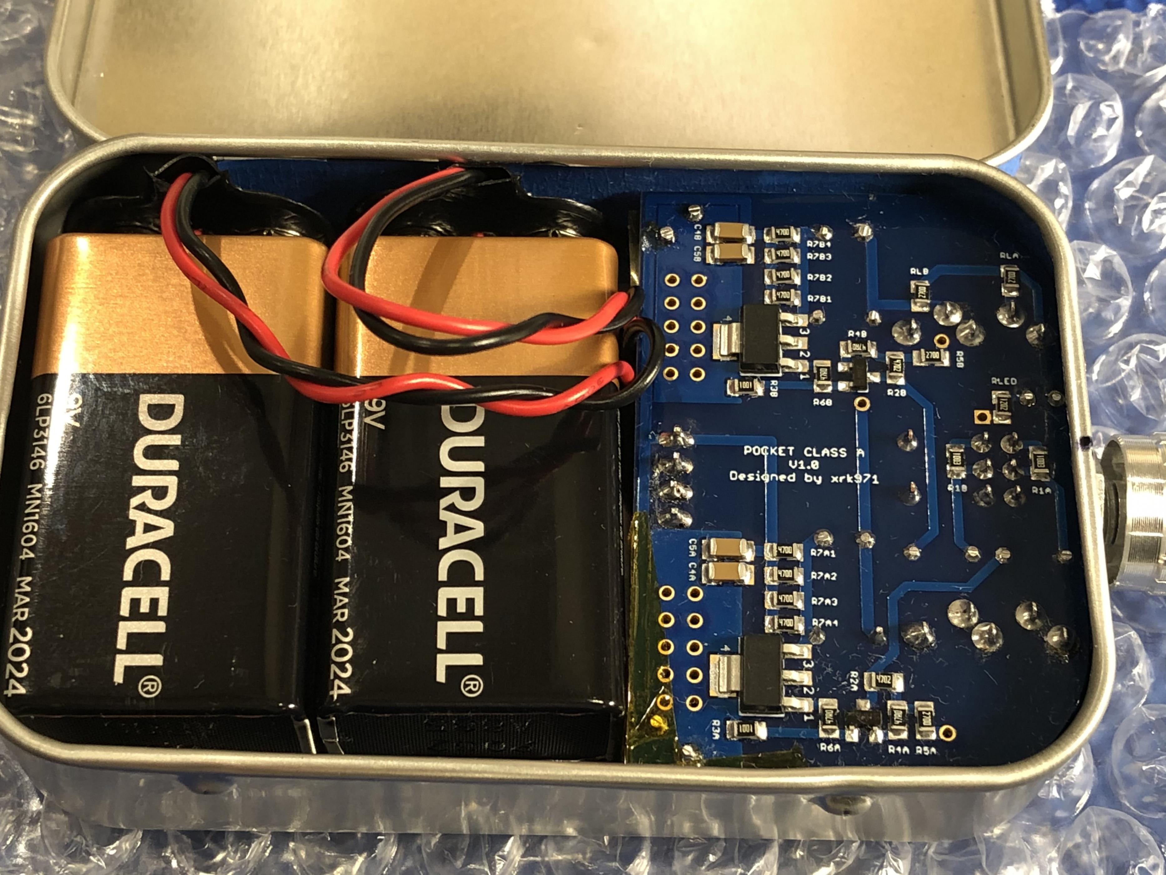

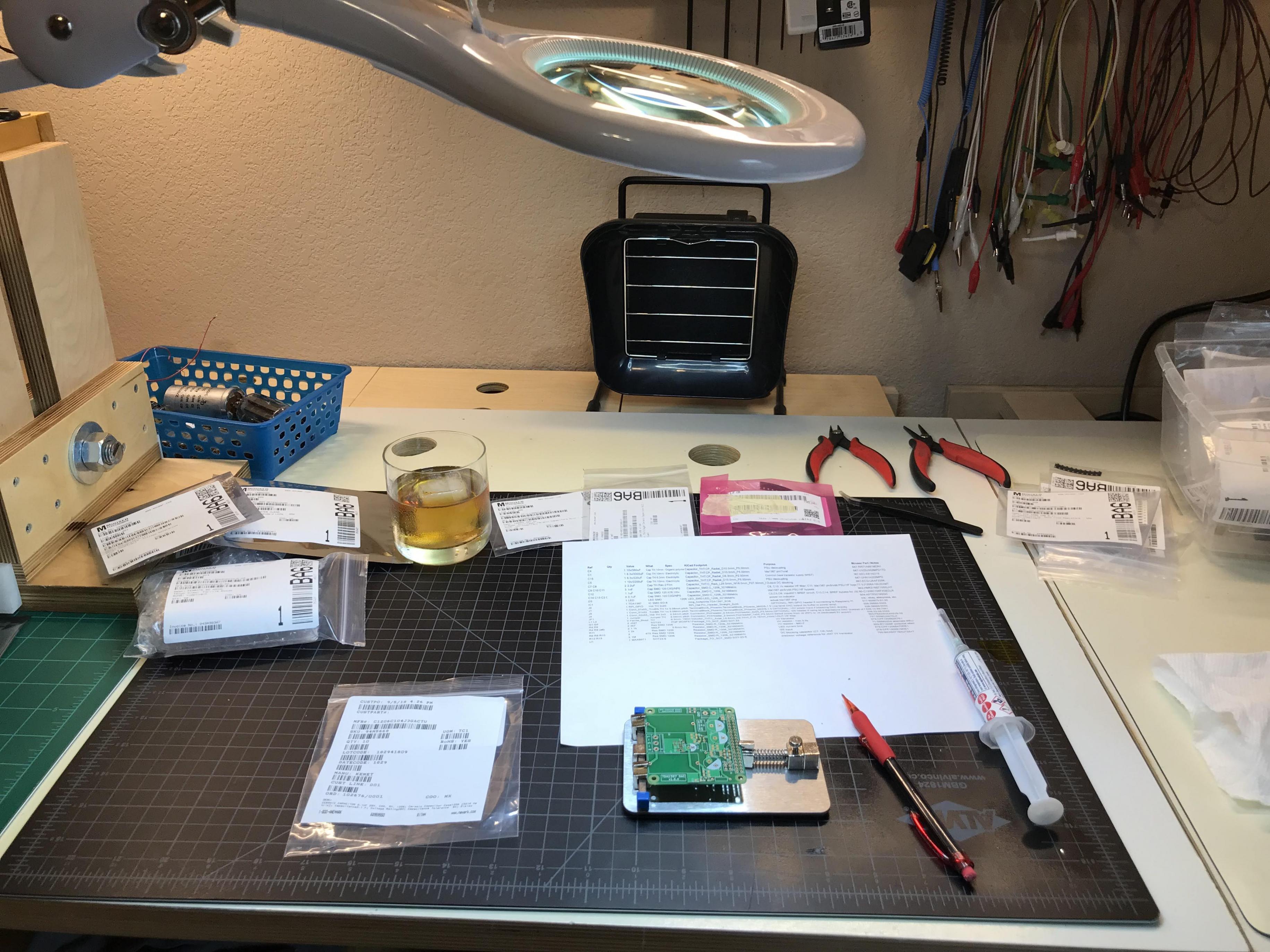

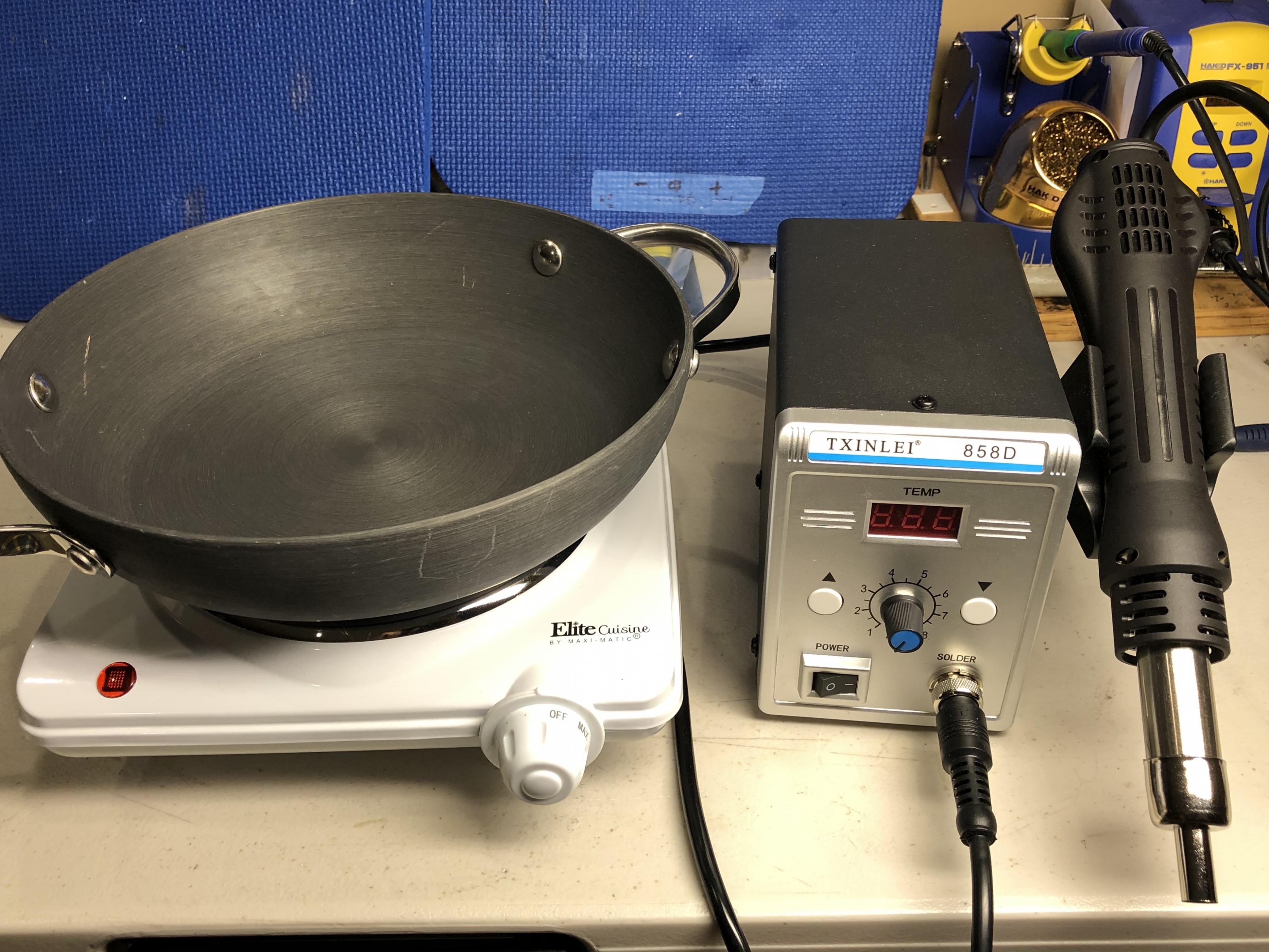

With the need to hone my SMT soldering technique and a curiosity with the HPA world I decided to build a PCA. This project should cover both bases nicely.
After discussing with X what tools would be necessary for SMT work I went with a hot plate and hot air station.

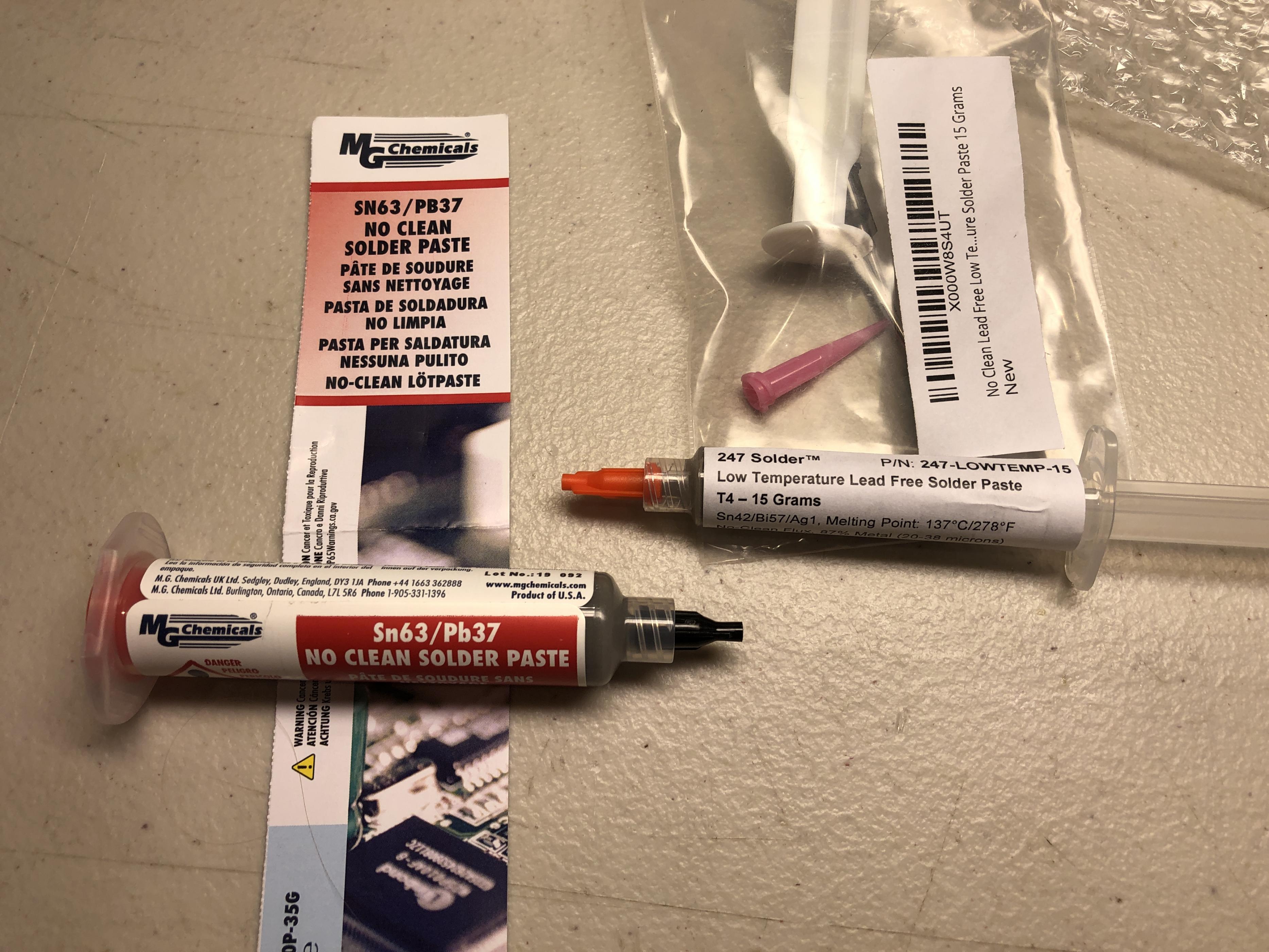

Application of the solder paste was a learning curve, too much at first. The pads need a very small amount, about the size of the tip of a .7 lead pencil. Magnification headgear is highly recommend

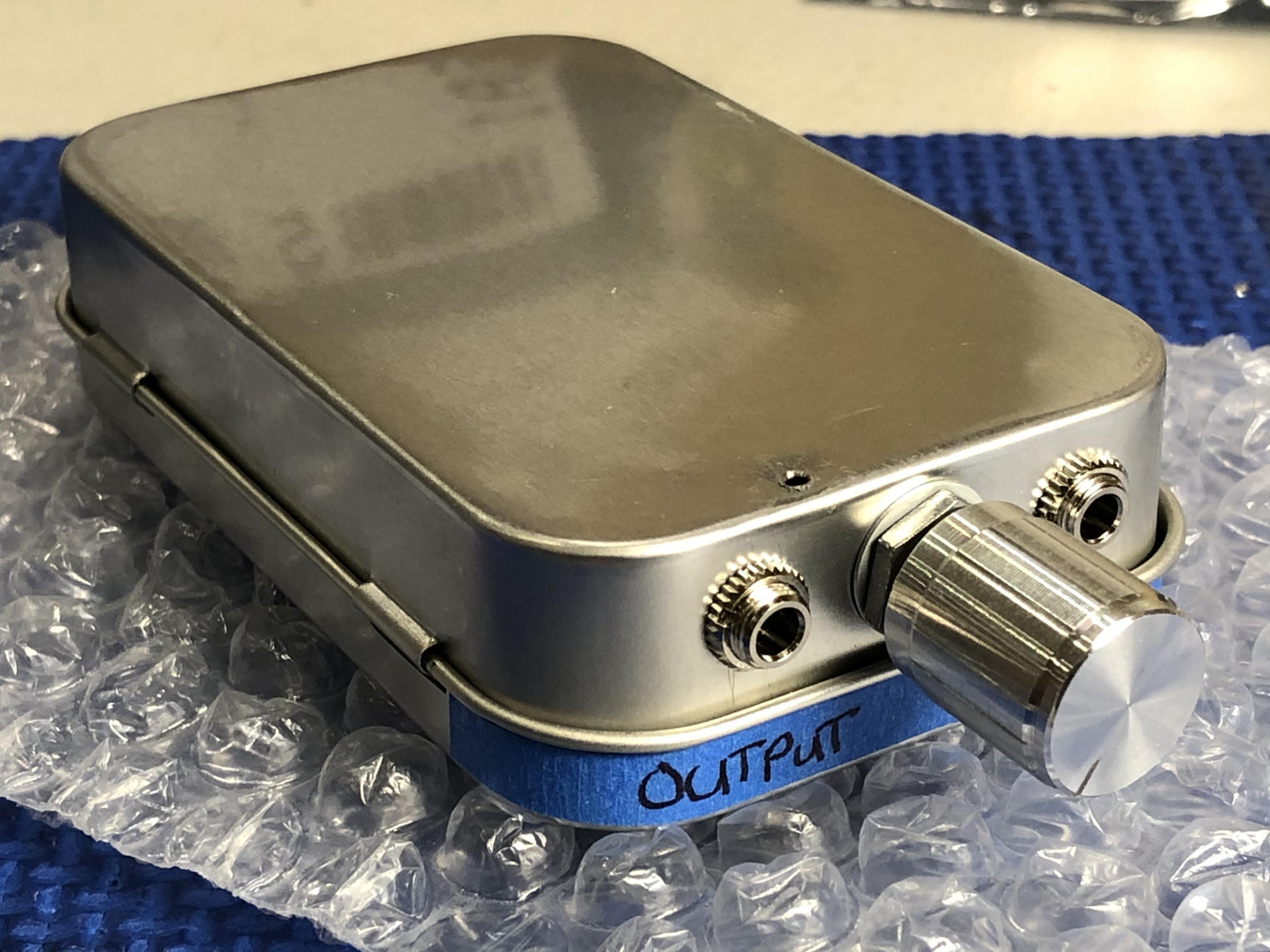

SMT soldering done this way was easier then I expected and came out much neater than when I used a fine tipped iron. The PCA was a pleasure to build, I found the trickiest step was getting the alignment for the three holes punched in the tin correctly. Being a noob that doesn’t own any “cans”, I purchased an entry level pair of CB-1 HP’s to listen with the PCA.
I’ll give this combo a test drive and report back soon...

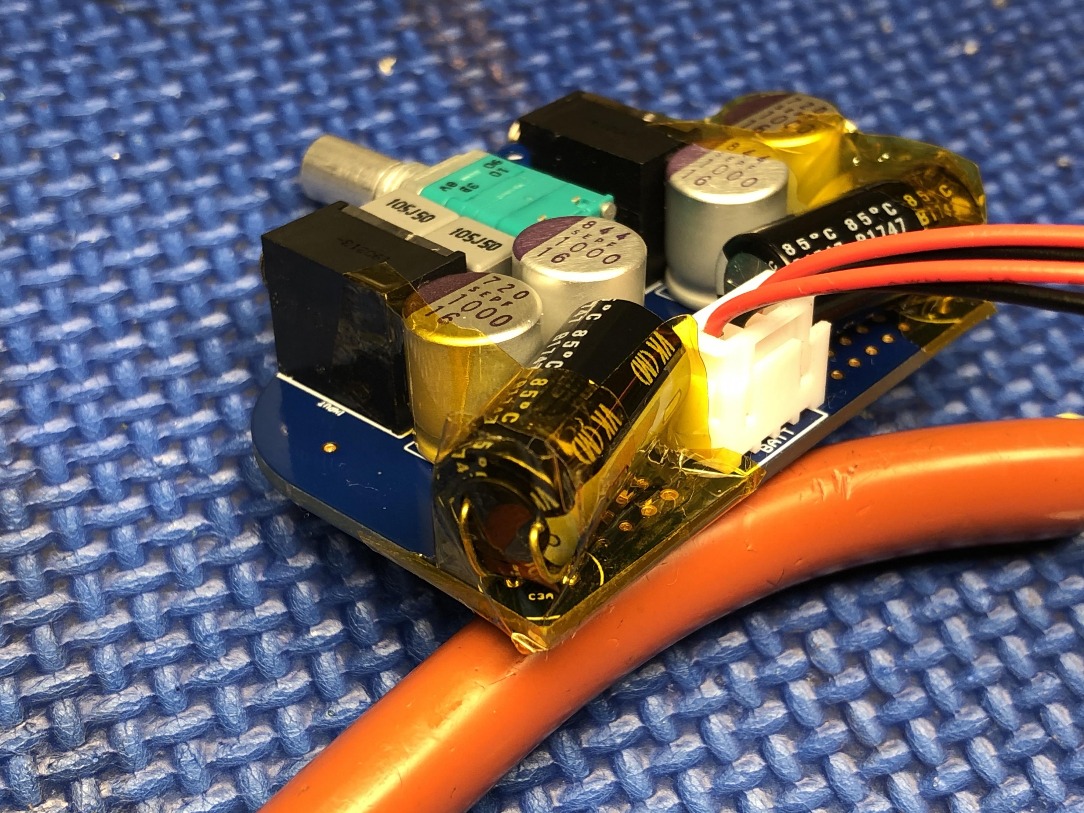

That’s about perfect bias current and temps are good too. Just like a regular Class A amp with temperatures.
The trick with power cycling the knob is standard practice with the rechargeable batteries to slowly bring the rail caps up to prevent auto shut down from the smart battery controller inside the 9v Li-ion cell.

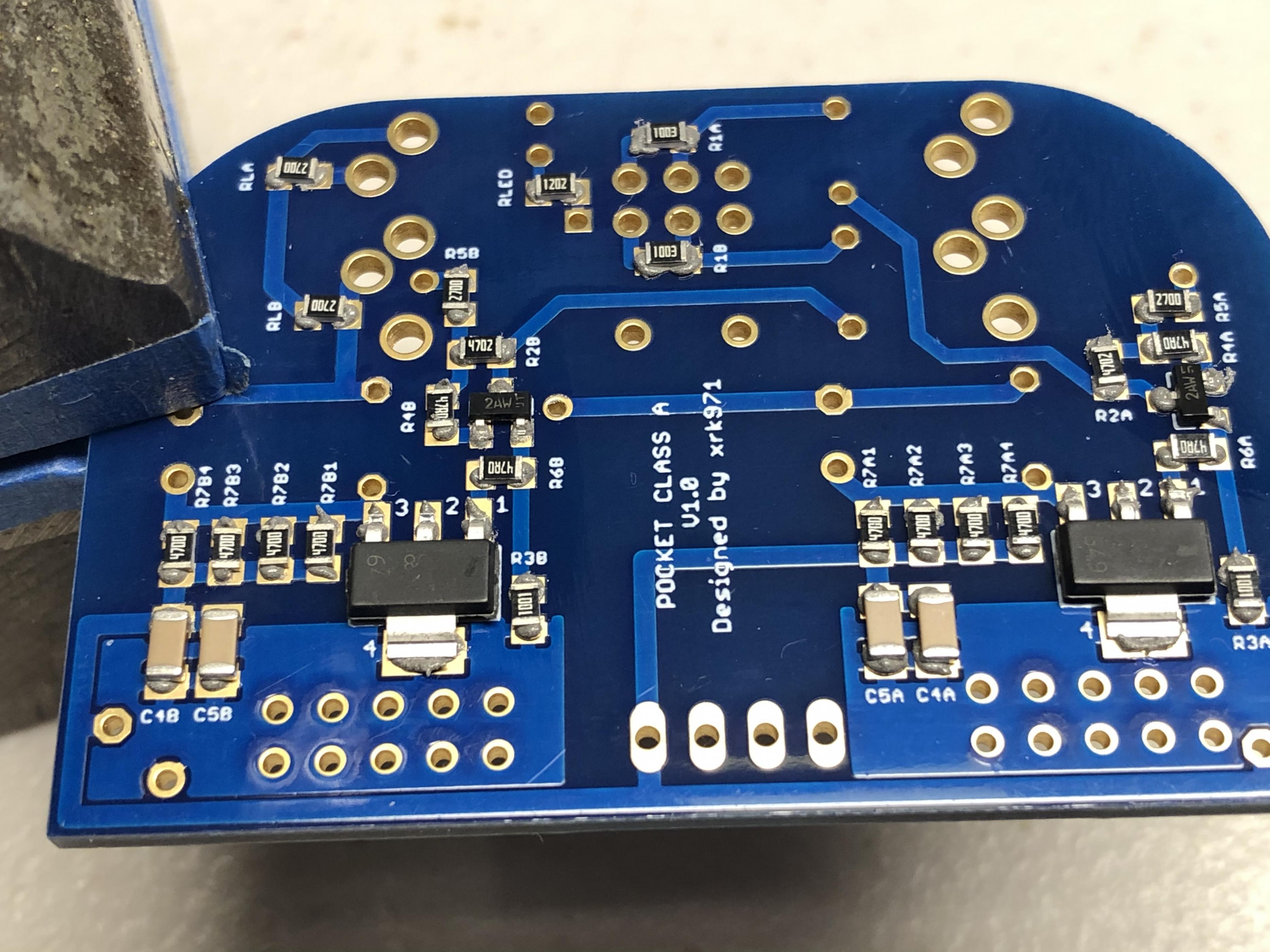

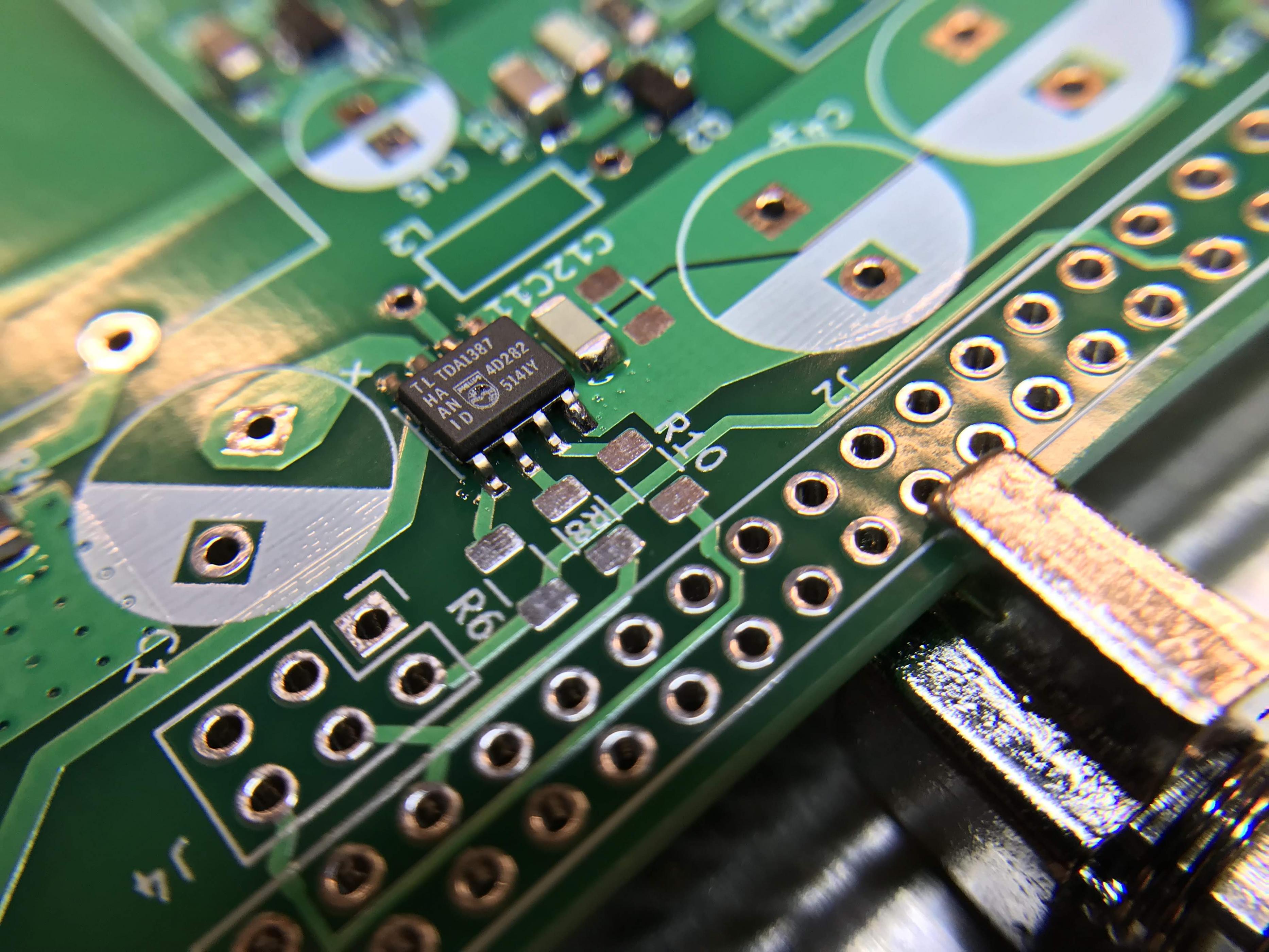

Possible solder bridge on R10
https://www.diyaudio.com/forums/att...p-gb-de11df65-24bd-4433-bad5-e47042b71c3c-jpg
It's solder paste. Once it's heated and flows, it should migrate to each pad. Good eyes though - wow!

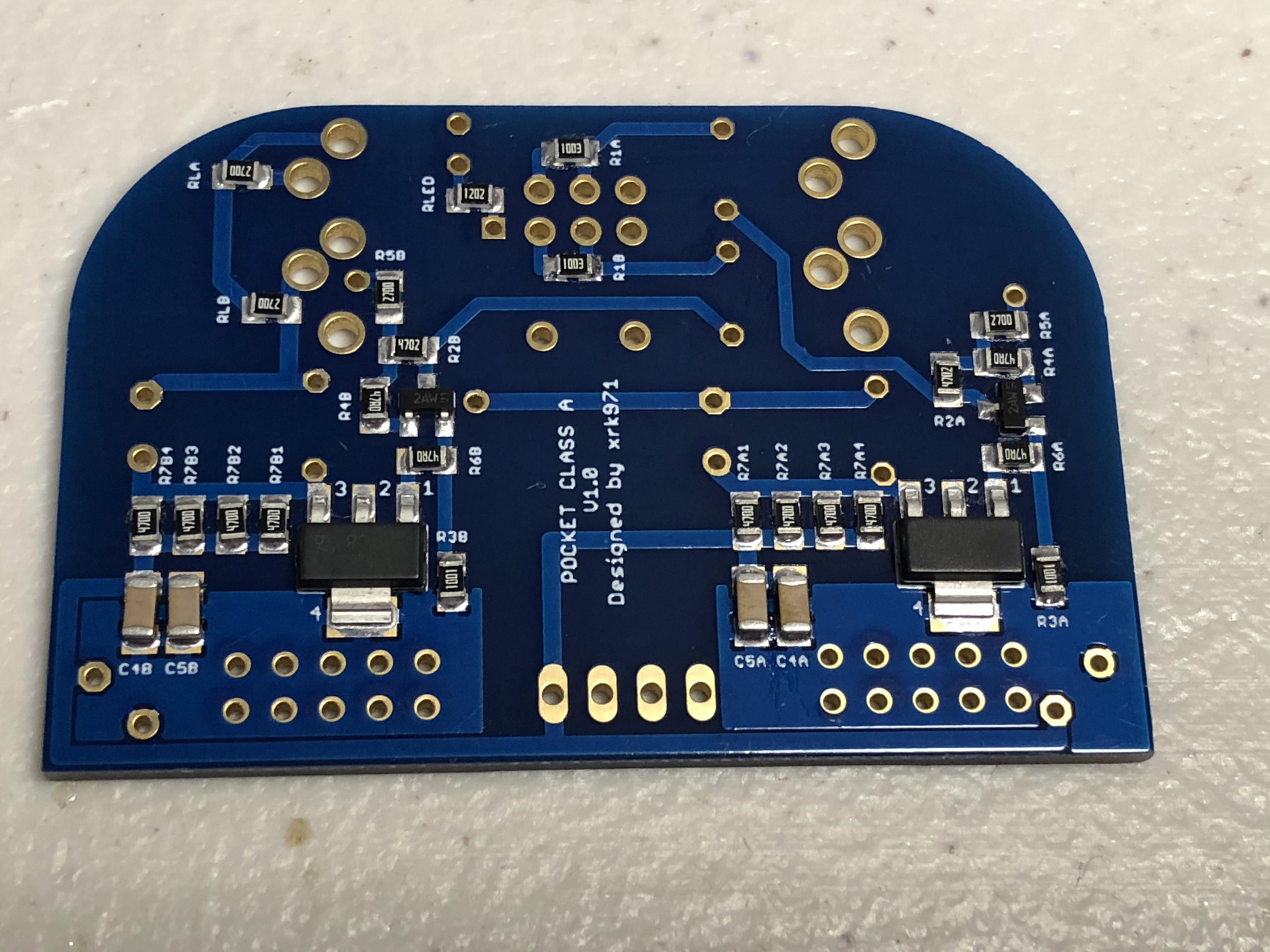

Sorry - Hit Enter too soon and X added the note also -
Here's the solder after flowing - looks great!
https://www.diyaudio.com/forums/att...p-gb-fe3bd1da-6c9c-4cc5-af1e-3bcb9143eab6-jpg
I've always used the solder paste and hot-air station for SMT components. For multi pin IC's, I usually tack it in place on opposite corners, then come back with fine solder and a chisel tip on my iron. I've tried the hot plate method, I can see how it would be convenient though. Place solder paste, and all the components, then heat it up and watch the board solder itself.
A good setup, patience, and diligence and you can get great results.

@Vunce - he beat me to it - LOL! Did you use the tip that came with it, or did you swap out to another / smaller size. I can't get nearly the nice small amounts from mine that you were able to achieve. Gorgeous work!
I agree that Vunce nailed it. Looks perfect for a first timer’s attempt.
I find the blue plastic taper Luerlock tips work much better than a hypo needle. You can push down and pinch off the paste bead.
X - Something like this?
USA Shipper 100 pcs Blue Luer Lock dispensing syringe tip cap Hydroponics vape | eBay
EDIT - I think this...
Tapered Dispensing Tip Needle, 22 Gauge, Blue, Luer Lock Hub, Polypropylene

I used the smallest tip it came with, but it was still too large. I'm pretty good with an iron, so for the few I needed with the AN, it wasn't an issue. Maybe next winter, when the new build season gets under way I will sit down and figure it out.
