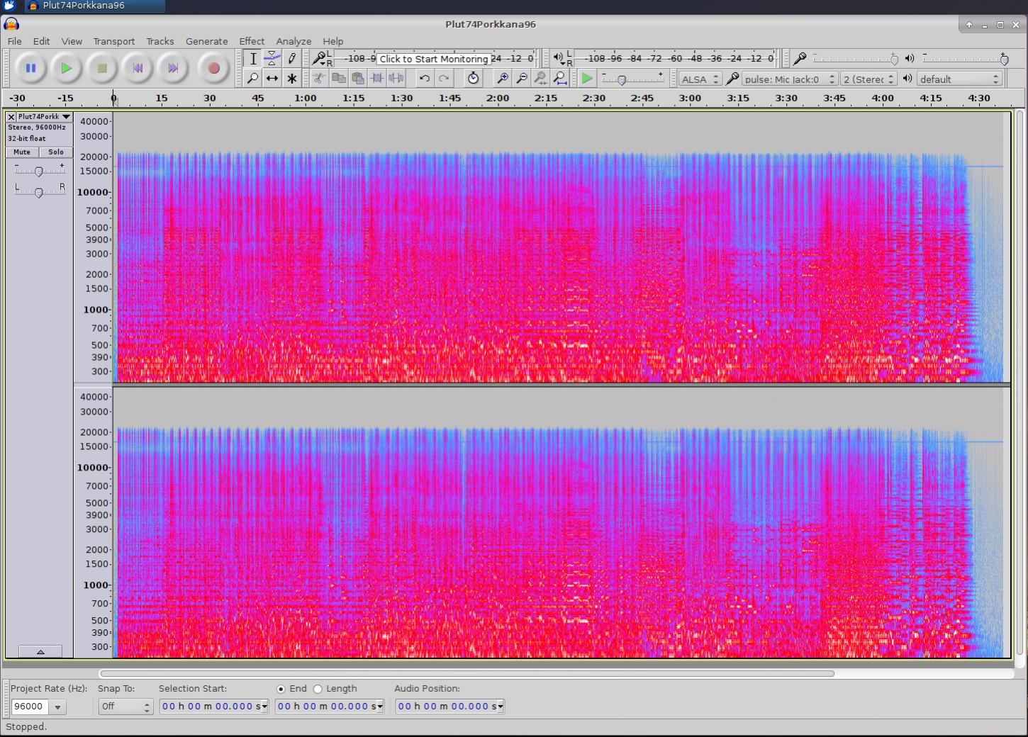

I searched this thread for this issue but didn't see anything directly related, so maybe someone here can help. I use a stock Xonar Essence STI ii with Audacity 2.1.2 under Xubuntu 16.04, also with Adobe Audition 1.5 under Win 10. In both cases, regardless of the project sample rate I set, the resulting file is of the proper format but there is zero information above about 22KHz. It's as if the Xonar ADC always operates at 44.1 or 48KHz, then the output is resampled to fit the requested format. (see attached pic of spectral analysis.) With my previous M-audio Delta 24/96, this did not happen. Can anyone shed light on this? Is it a driver issue? Hardware limitation?
