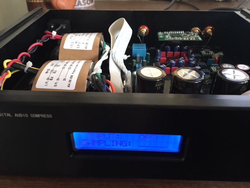

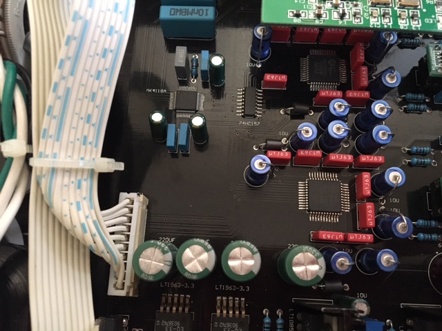

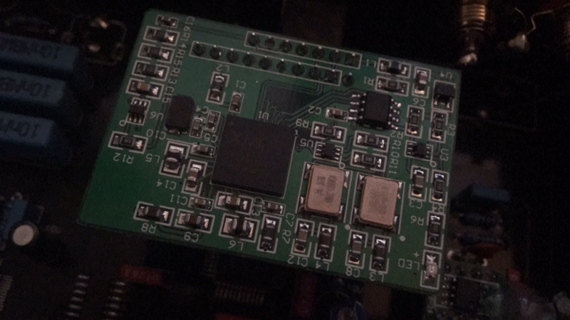

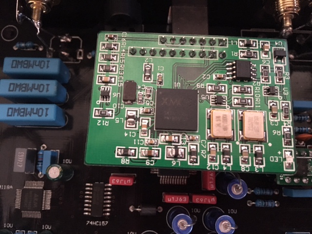

I decided to go ahead and get myself the the dual Ak4495 Dac (weilang Board, fully assembled), and have hit a strange Problem.

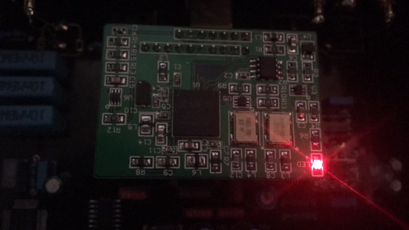

I have used the xmos usb interface to connect the Dac to my Mac, however the interface is not detected by the Mac since the Led on the xmos board doesn't light up every time.
I have to turn On and turn off the dac's power button several times (10-15 times)to ensure the power light comes ON on the xmos board.
This is quite frustrating and the number of times i need to do this for the Xmos U8 board to come on seems to be increasing. But once its comes ON the Dac works without any problems.
I have tried changing the usb Cable , the power cable , nothing seems to fix this problem.
Is there a way this can be fixed ?

You might try doing some careful poking around for power and see if you can find the problem.
Makes me think it is something that happened or was aggravated by being shipped half way around the world, and r8833 has a good suggestion.

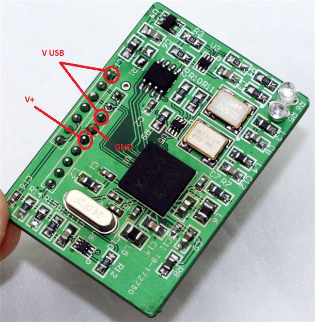

First measure if 5v comes on pin V+ if yes then further measure voltages 3.3...1.8 and 1v. You have black inductors L... measure points. If all voltages are present than take a look if shield of usb connector on dac board is dirrectly conected to gnd or trought capacitor. If directly cut trace between shield and gnd and instal 100nF smd if capacitor is present than connect shield and gnd. Then we will go on.

I tried poking here and there to get the xmos to work, then with my multimeter tried measuring the 5v on V+ pins . everything seemed fine.
