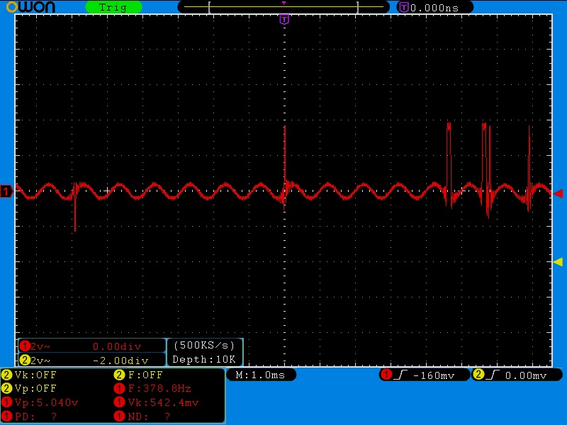

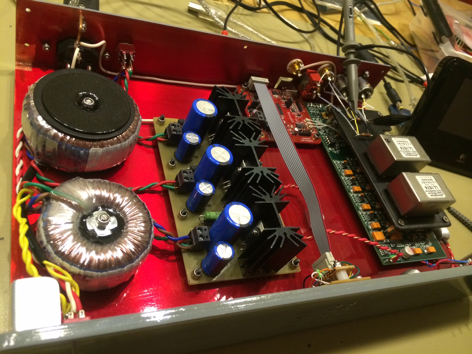

I´ve have some trouble with noise on the output of this rakkdac/ waveIO combo when I use my Squeezebox Touch as digital input. My combo looks like this:
Pic1.
If I use win7/ jriver media/ asio as digital input to WaveIO I have no trouble or noise, but with SBT (with EDO-applet) I get noise on the output of the rakkdac.
The noise looks like this on my scope when I run a 1kHz sinewave from the SBT at 44.1kHz samplrate:
Pic2
The SBT seems to recognize the waveIO card just fine, but if I scope the "I2S data" connection the frequency seems low, at around 300kHz. Bitclock and LRclock looks the same with SBT as with pc-input.
Any ideas that could help me sort this out?

and when you use the isolated output, still the same noise ?
That is what I am going to try. I need to get the connectors and cable in house first.
Kind of strange that it works really well with win7/jriver/asio. I was up all night playing music. I worked with the SBT/ EDO trying different versions of the software/firmware and options for buffersize but noise remained the same.
