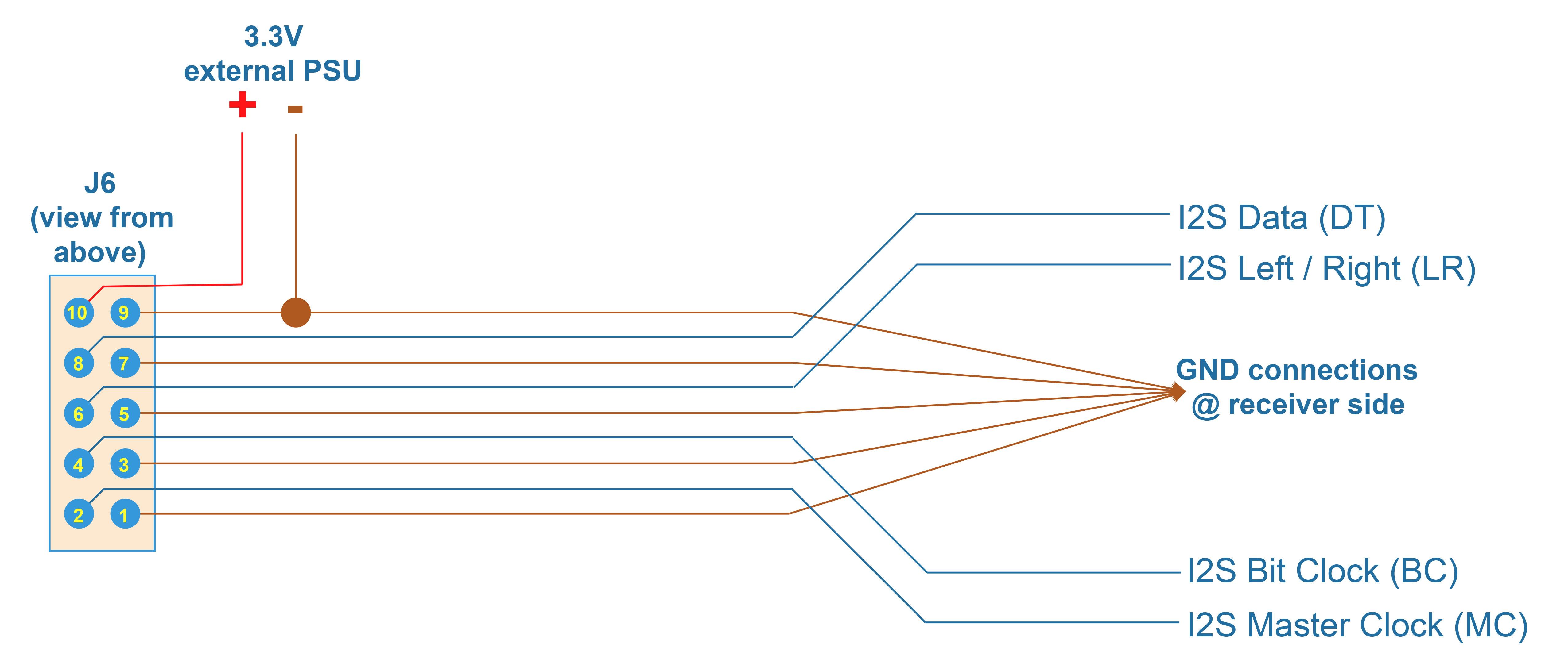

@ Bartt: attached is a picture with connections you asked for. I hope it helps!

Great, very useful. Fortunately I've got some free GPIO ports...
Thanks Lorien
