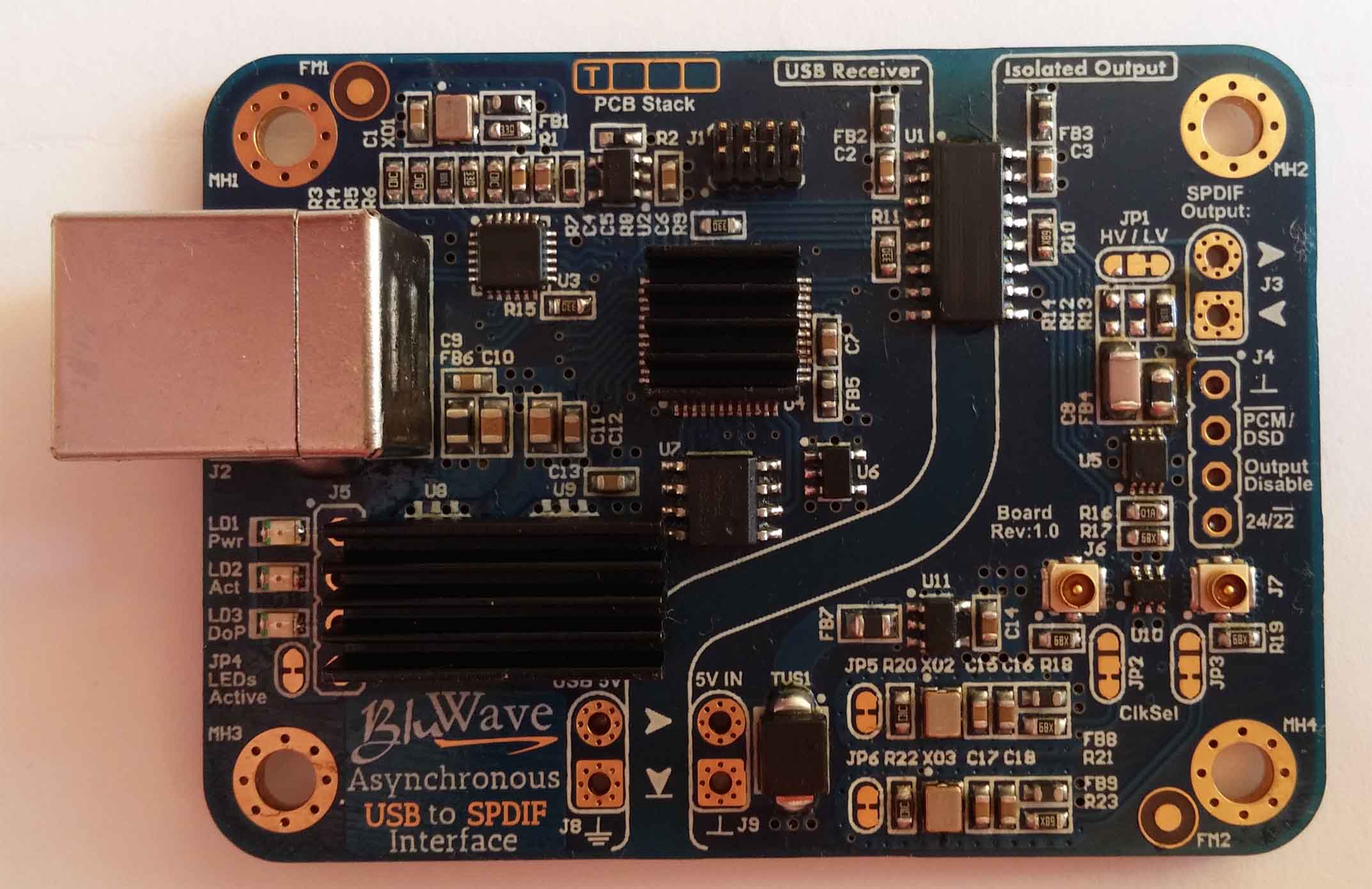

Off topic: After a couple of years of building WaveIOs, I might came to the feeling to design something new...
I thought to post the news here first to see if there's any interest in it before moving on and pollute this nice forum with a new boring thread!
I'm speaking about a new board which is basically a pilot for me regarding a couple of reasons (almost all are technical). I'll not get you bored with unwanted details unless you really want to! but to tell that it's a simple USB to SPDIF Interface built to fulfill requests I got from some of my friends.
Anyway, this new board is built with my knowledge about WaveIO in mind + ~six years after :p As you can see in the attached pictures, this new board is split almost evenly in two. The input side where the XMOS resides is powered form the host (PC/MAC/Linux/etc.) while the output side can be powered form two places: host OR external PSU. Obviously, I recommend the second choice!
Moreover, the "audio oscillators" are now placed after the isolator, on the so called "quiet" side of it! It is quiet enough for my oscilloscope, better than actual board... I must say I'm quite happy about the outcome!
I'm sorry if this PCB pictured here isn't "prepared" as should be... It's my test board.
As for slaving it to external clock sources, this can be easily done since there are two U.FL.s present there for this purpose. If you're going to use external clocks then you can switch off "audio" oscillators on the main board... both of them simultaneously.
Speaking of oscillators, are the finest NDKs I could find, as I always use for all boards I made. As usual, drivers are genuine, made by Thesycon and customized for this new board.
The first batch is a small one! Now I have nine boards here for spare, excluding the "test" one which will be kept for "just in case" situations. Price is set at 89 Euro each, including Paypal, shipping and VAT charges.
Any questions are welcomed!
If there's some interest please put your name here along with the number boards you want to have but please remember that I only have 9 of them.
Kind regards,
L

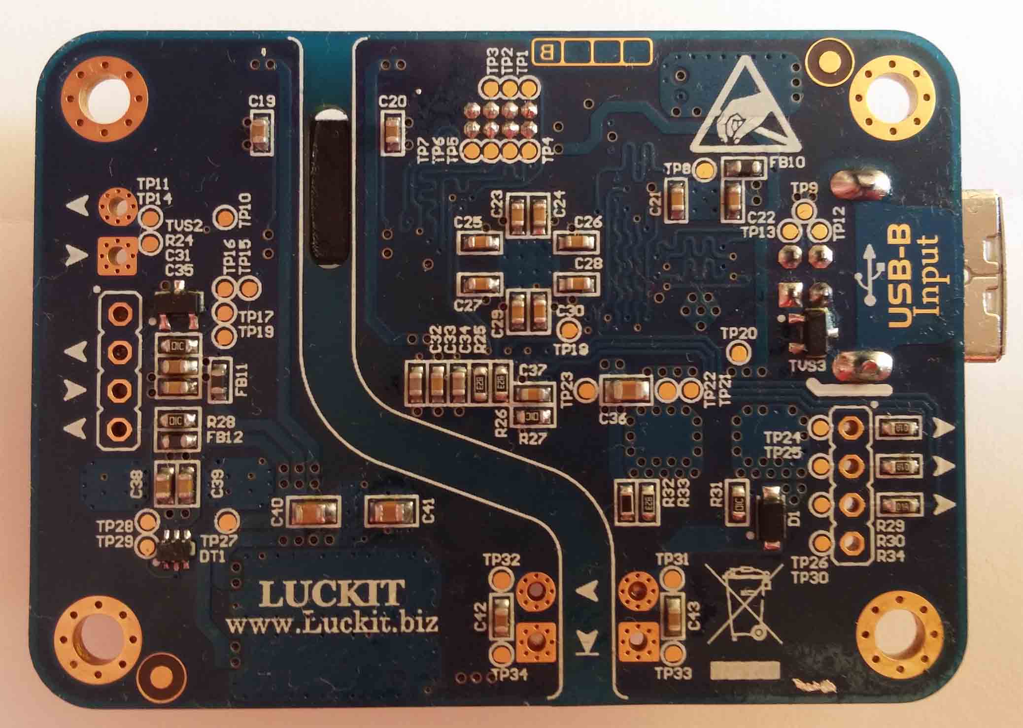

Edit: TOP and Bottom pictures of it:

Lorien,
Why not !
Better isolators and best LDO regs from today ? New generation XMOS chip? Uf-l plugs also on the isolated side ? MCLK uf-l plug always ?
Same XOs frequencies or a little highers ? (read at IanCanada inputs who likes using 40/44 Xos even with NOS id=f I understood) !
Maybe a good idea is to make it even more universal and allow also I2S uf-l inputs because many of us are using RaspBerry like boards but still need a good clock with good isolator chip !
So just as an idea (and it seems to me you will have even more sells...)
Add it 3 uf-l plugs inputt (with Sussumu resistors very low noise if needed in serie or zero ohms strap for further tweak and desoldering to choose the R value one needs)
Putt : 2 uf-l MCLK outputt plugs (one for BBB boards eggs or SD card drivers) and one for the people who use IanCanada PCM boards or have personnal DAC mainboard with MCLK injection needs)
+1 in this case (the game being to make a good versatil Clock board in fact where the main option is USB but not only :) and I promess you even more sucess than the last one I like a lot :) )
Kind regards
Eldam ( humble free consultant as having no job yet but tons of ideas !)
(If you need beta tester for the sound behavior I'm in too)
@ Eldam: this board wasn't meant to "break" every barrier in therms of performance but, hopefully, to be an affordable USB to SPDIF interface with a fair price/performance ration - at least my version of it!
All the ideas you have are very good but some cannot be applied here.. as the PCB is already made. In fact, I start this board with the idea to design it as cheap as possible. Well, over time, I began to change few things here and there knowing that if I'll add few parts things will get 'better' so, the "cheapest board available" trophy I'll leave for others. :)
Anyway, the "few parts board" idea I had at the beginning got more complex and this is it the limit I set for this design. Obviously I can go way more but I'l step over the desired price range.
So, should I understand from your post that you're interested in one such a board?

Hello Lucian,
May I ? It's not aboutt trophy, it's about versatility ! It was the concept which made the sucess of your Waqve I/O ! Needs as DIY are in conStant evolution ! I don't think you will break the frontier of your last price which was near 100 USD/euros by adding some uf-l plugs and a trace or two ! (btw the price of 4 layers boards are far lower than some years and luckilly it can be seen in your new planned price)
I can rephrase it : a this actual price and option (so the same as the previous) you are in direct concurrence with all the others : the well known italian board, the JLSound one, the DIYhink, etc (there are others) ! Even more, one may take the idea for him :eek: ! 2 possibility : make the price constant but staying the Hermes of hand made cutt or follow the others but at the risk to be lost in the Cloud !
Maybe a poll here in a new thread to have a clearer vision ?
to answer to you not + 1 if the same Wave I/O with just better scope improvement, + 1 if more versatil on inputs/outputs.... like I/O the second part of the product name :)
OF COURSE WILL ALL MY HUMILITY IT DESERVES TO YOUR EXCELLENT JOB AND GREAT AFTER SELL SUPPORT (I am in the personn who always advised to buy your product ;) )

Lorien what frecuency are the oscillators?
Since it's SPDIF only (with 192 KHz maximum sample rate), 22.5792 MHz and 24.576 MHz clocks are enough for this board to run properly. Anyway, in software I can change it to double of above freqs. (not tested yet though) Sadly, my 4x.xxx clocks are still ordered and I have none here to put on these 9 boards.
