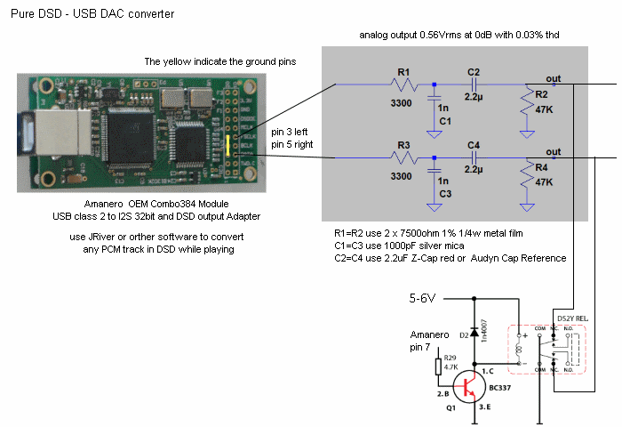

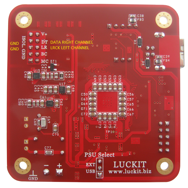

Forgot to say something about actual PCM / DSD pin mapping:
I2S_BCLK = DSD_CLK
I2S_LRCK = DSD_DAC0
I2S_DATA = DSD_DAC1
Why don't you read back 2-3 pages??? or get the manual:)
"Forgot to say something about actual PCM / DSD pin mapping:
I2S_BCLK = DSD_CLK
I2S_LRCK = DSD_DAC0 =left
I2S_DATA = DSD_DAC1 =right
WaveIO | Luckit
Thank you danico but Lorien post was not so clear about channels. Attached pic to be sure where to get the channels, please reconfirm.

@ Felipe: after all you had to unpack the archive before running the setup.exe file! I'm glad it worked after all so now I can say there are no more issues with 3.34 drivers that I'm aware off!
DSD pin mapping: I'm sorry for confusion but the DSD pin mapping is written close to the latest firmware release for your WaveIO cards.
Just go to Luckit | Audiophile grade DIY products @ Support tab and on the same line with test version you'll see:
(PCM / DSD pin mapping: I2S_BCLK = DSD_CLK / I2S_LRCK = DSD_DAC0 / I2S_DATA = DSD_DAC1)
I hope it helps,
L

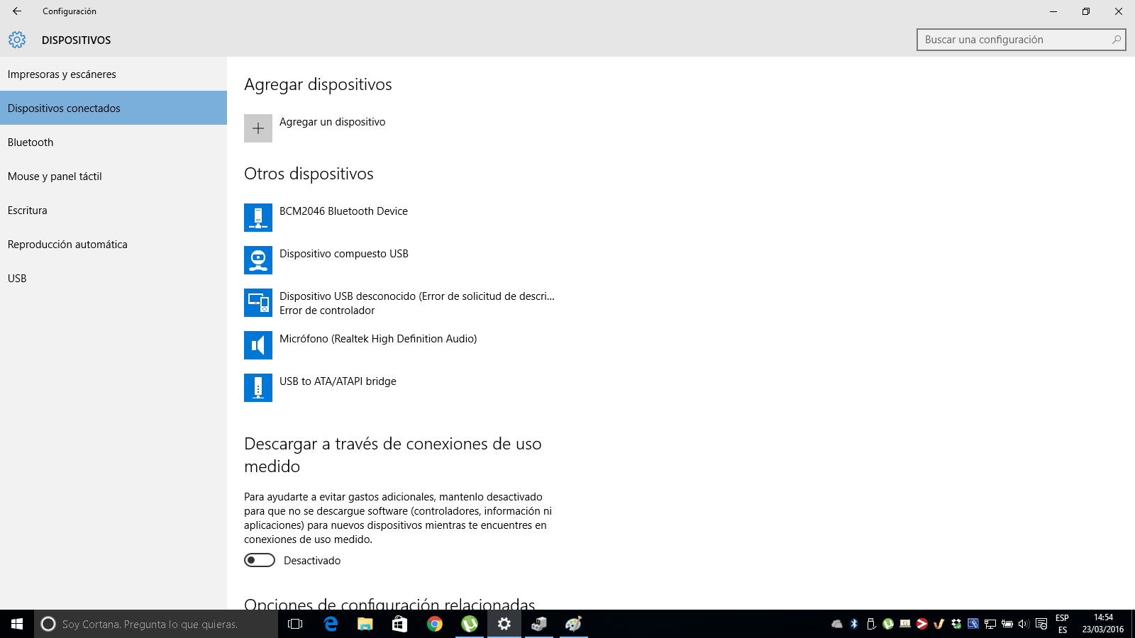

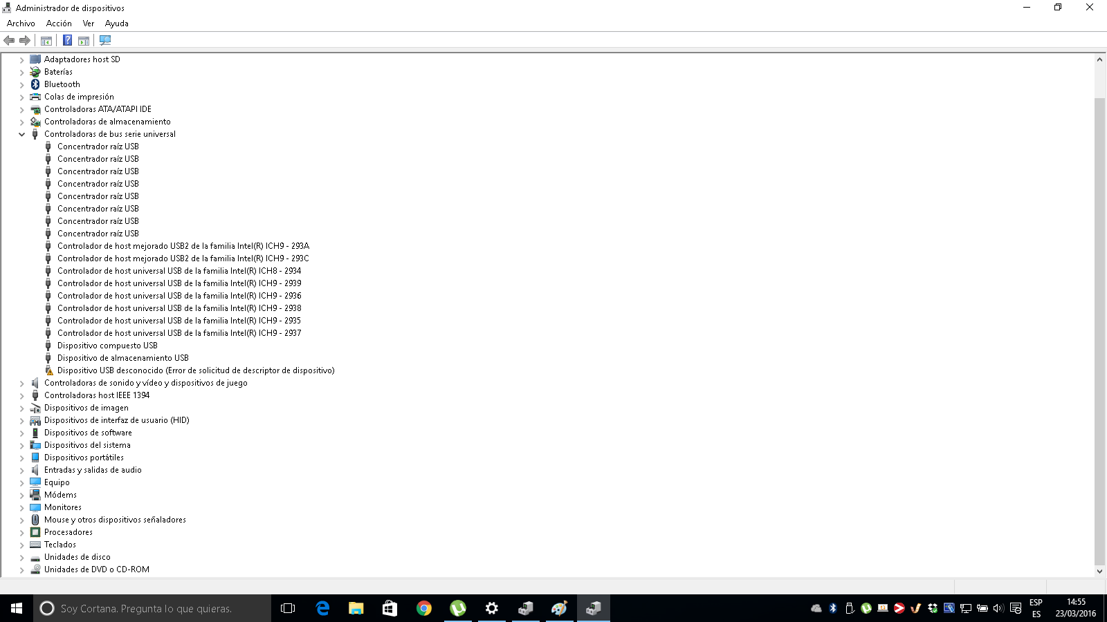

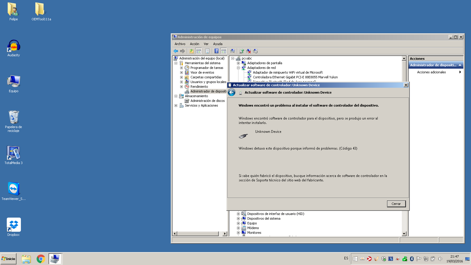

In few moments I'll email Thesycon forwarding your picture and search for a solution as I don't have direct access to the meaning of those error codes.
It's sad for me knowing that you still have troubles as in this post you said is all okay (at least this is what I understand...). Can you tell me what version of Windows 7 are you running and which SP is installed?
Kind regards,
L

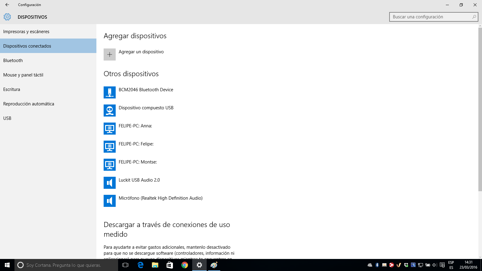

Joined 2009
I use Daphile player on USB stick (Linux).
Upgraded to W10 still problems, when I execute the drivers I see on W7 or W10 that WaveIO are installed, but when I connect Daphile the player don't recognise WaveIO, I open W7 or 10 and the USB port see unknown device and drivers not installed, attached pics W10.
