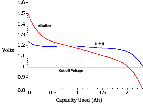

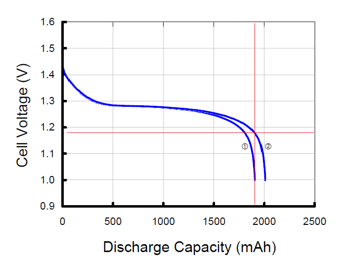

Then I contemplate to go 2S LifePO4 and have a discrete linear low drop regulator to 5V (+/- 0,1 V). This will input 7,2 average but in practice between 8 and 6,5V. But at least I will have a total absence of any connection to the mains.
But maybe better is a direct connected 4S LiMH at nominal 4,8 it will vary less, between 5,7V and 4,5V, looking at the graphs. Have to puzzle that out. :dunno: Maybe: Do not allow charging higher than 5,4 volts . . and set the cut-out at 4,4 and this would give a safe margin.
You mention you have a safety diode: can I add that to the 5,7V? This would give me the allowed high level charged state to 6.0 volt and still have a margin . .
Who has experiences with this?
How NiMH is a constant voltage source, of 1,2V (and 4.8 V with 4 cells in a pack) and better than alkaline:
How cells in a pack with slight differences in capacity influence the 'lifetime' of the decharge line:

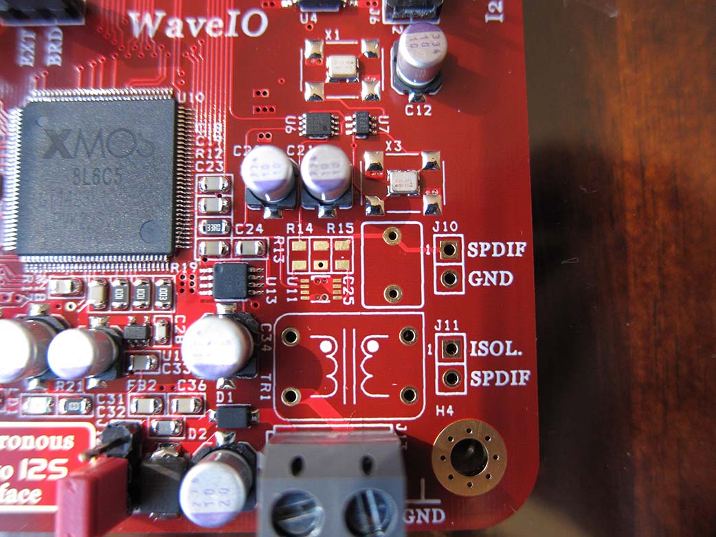

I was wondering if anyone can help me with Waveboard I received from Audio Creative crew when I ordered DDDAC kit...
I was planning to try S/PDIF outputs to workout optimum software, drivers and power supply for Waveboard..... but surprise, surprise -> the S/PDIF output parts are missing... From what I see, it appears that U11, R13, R14 and R15 are needed to provide buffered S/PDIF signal at J10 (“direct” output, i.e. no pulse transformer).
Is this correct?
The DC isolation / coupling capacitor C25 and the pulse transformer I can provide myself, but without the U11 I don't think I'll get the S/PDIF J10 “direct” output happening...??? Correct?

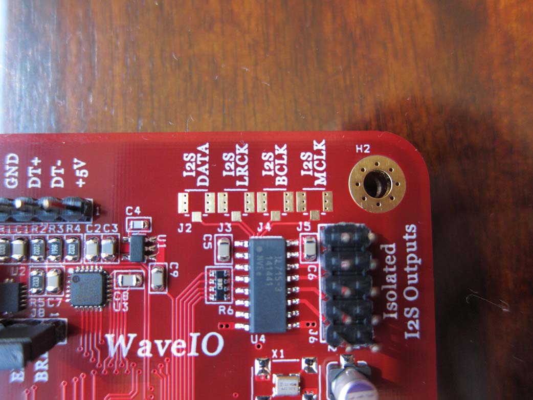

The funny part is that I ordered DDDAC in kit-form to play and experiment, but received Waveboard that gives me only isolated I2S output option - not even the connectors for un-isolated UF-I wires to try different options – see pic #2. Does anyone know where I can get these little J2, J3, J4 and J5 connectors?
Is this correct?
Hello Nick! Yes, both me and Doede decide to remove those parts from any WaveIO which will go with his DAC because the SPDIF input wasn't needed in Doede's configuration (at that time at least).
Yes, without that U11 chip you will not have SPDIF signal regardless of the output port you'll use. Anyway, there are other parts placed on the SPDIF path and U11 is one of them.
Nick
There are few choices for you! As I can see, you're in Australia thus making difficult the first and easiest one for you: shipping back your card here and I would take care of all the necessary adaptations so you can have the fully featured Waveboard. Anyway, if time is not pressing you regarding your project you can consider this option.
The second one is to source you all the part you need to make the SPDIF stage a working one. I have the parts here so there's no delay n get them and shipping charges are minimal since all will be sent in a small envelope.
Third option is to source you a list of all parts you need, get them from there and solder for yourself (or anyone else with required experience).
I would opt out for the first choice since I have all the knowledge on how to make our WaveIO looking like "new"... not to mention that I'll test it here and make sure it's fully working. I'm just saying that for the rest of the two choices, there's a risk that you have to take into account so you must know what you are doing to that board. I'm mostly speaking about the J2 to J5 connectors (which can be easily damaged if are touched by the melted solder), the U11 with small pitch and a particular resistor with a via hole in one of its pads...
