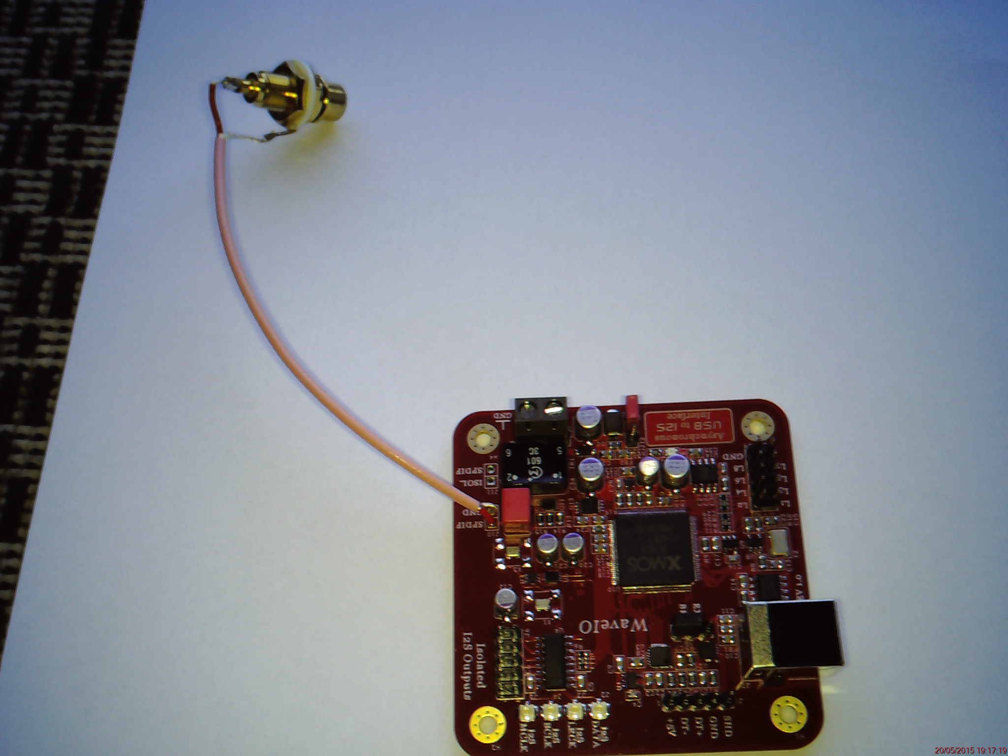

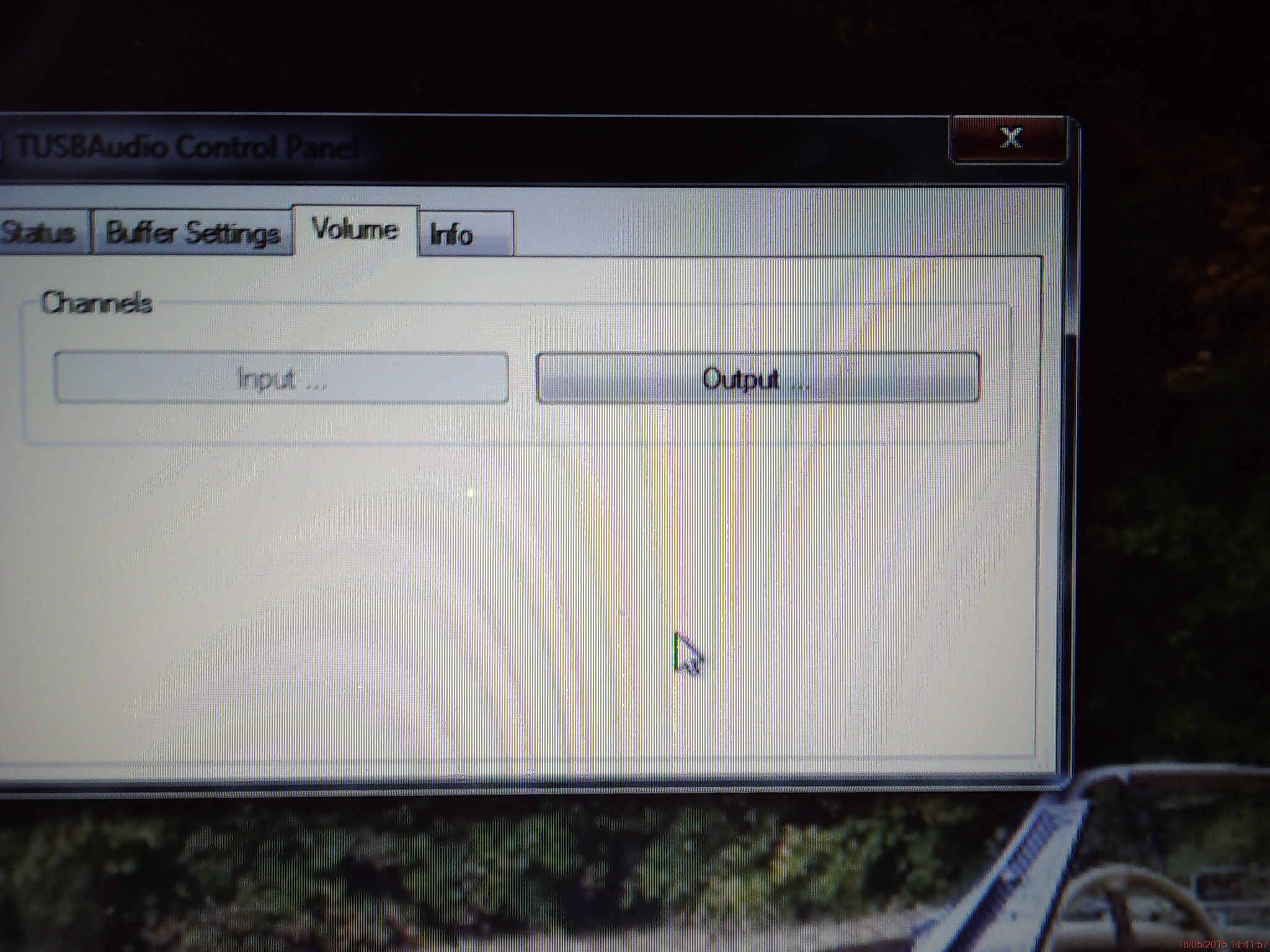

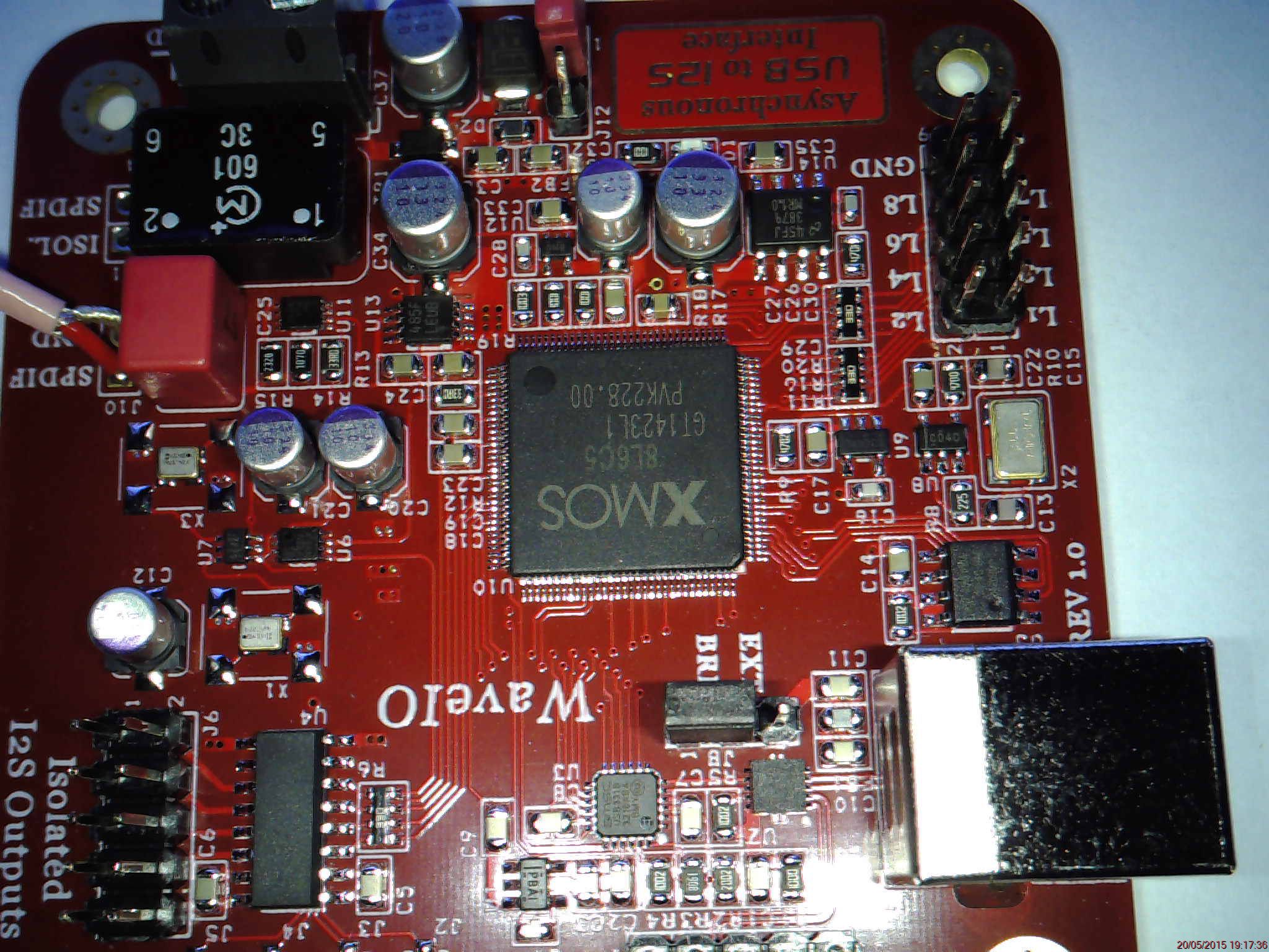

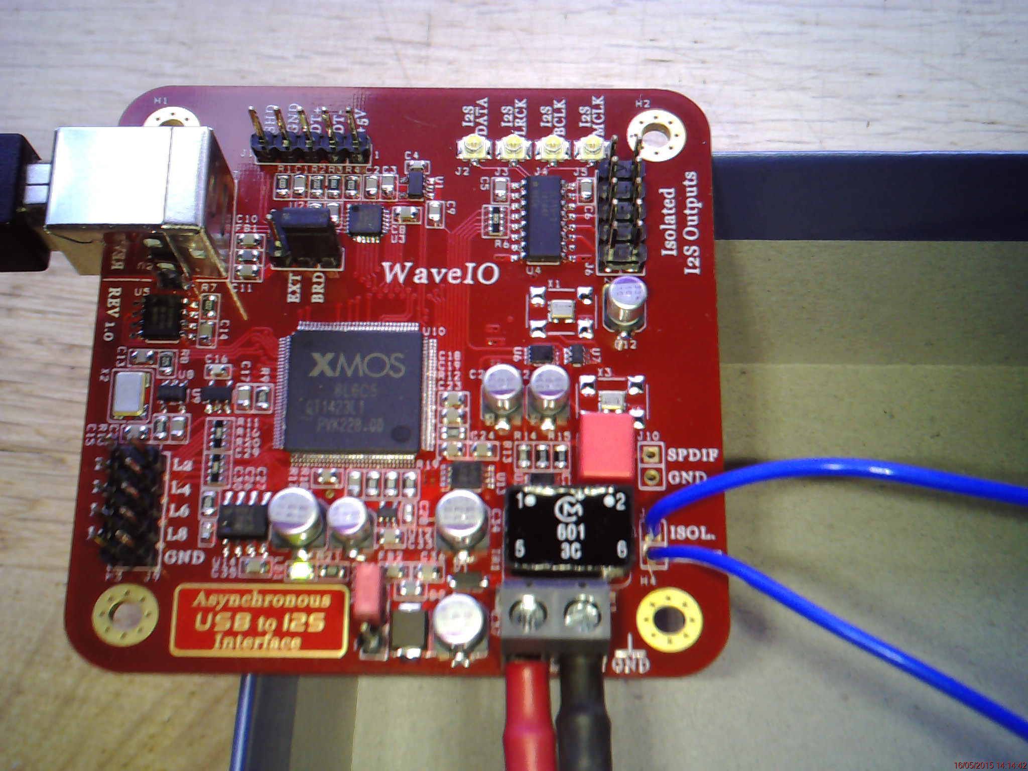

wave lo board help
Hi folks , im trying to use the wave lo board as a usb to spdif converter
but im having problems , ive tried a seperate 5v supply , and ive tried it powered via the usb cable , but it still dont work ,im using windows seven
ive tried both spdif connections square pad hot wire and other connection earth
if i go to control panel and select sound i can see it playing but sound dont
come out my dac just lots of clicking , anyone can help cheers phil.

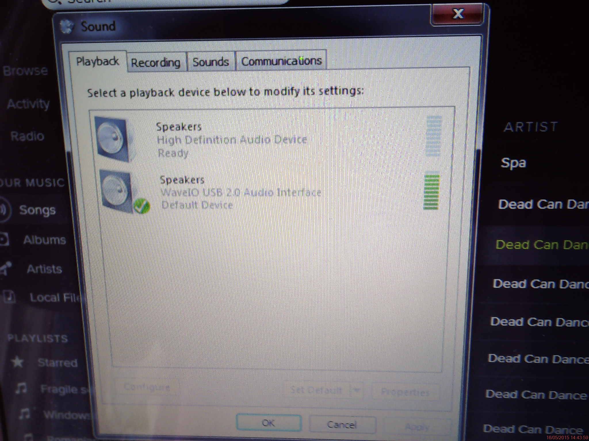

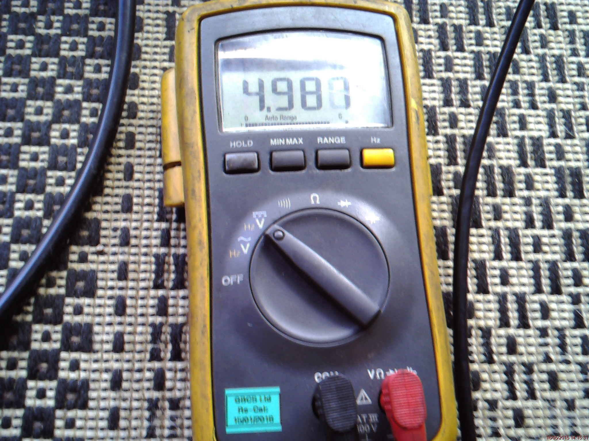

Yes if I get the usb cable from the laptop and plug it into the wave lo board
no spdif connections there is a green power light and if I move the jumper it
lights up when I give it 5v from a separate power supply, music is playing on my laptop speakers but when I plug in the usb to the wave lo board the
speakers go off on the laptop and in control panel sound it is showing that it
is playing but when I connect it from spdif to dac no sound just clicking from j11 and no sound from j10 its like its having problems locking onto the
signal ,

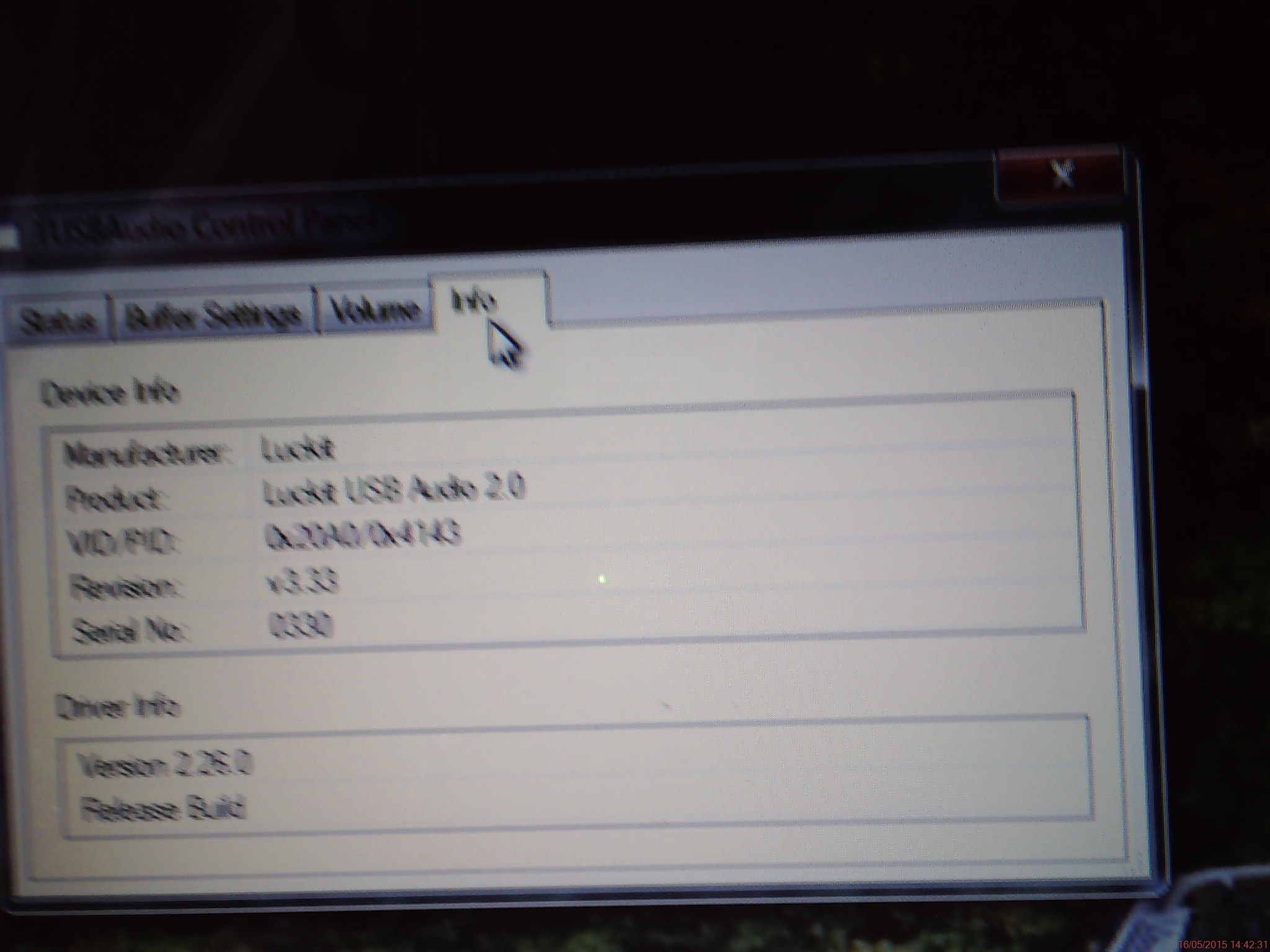

I have a fan music usb to spdif converter and that works fine £20
drivers 2.23 and 2.24 and v2.26.0).zip which is right for windows 7 I think its v 2.26.0
cheers phil.

ok start at 16 bit 44.1 khz and go up from there...

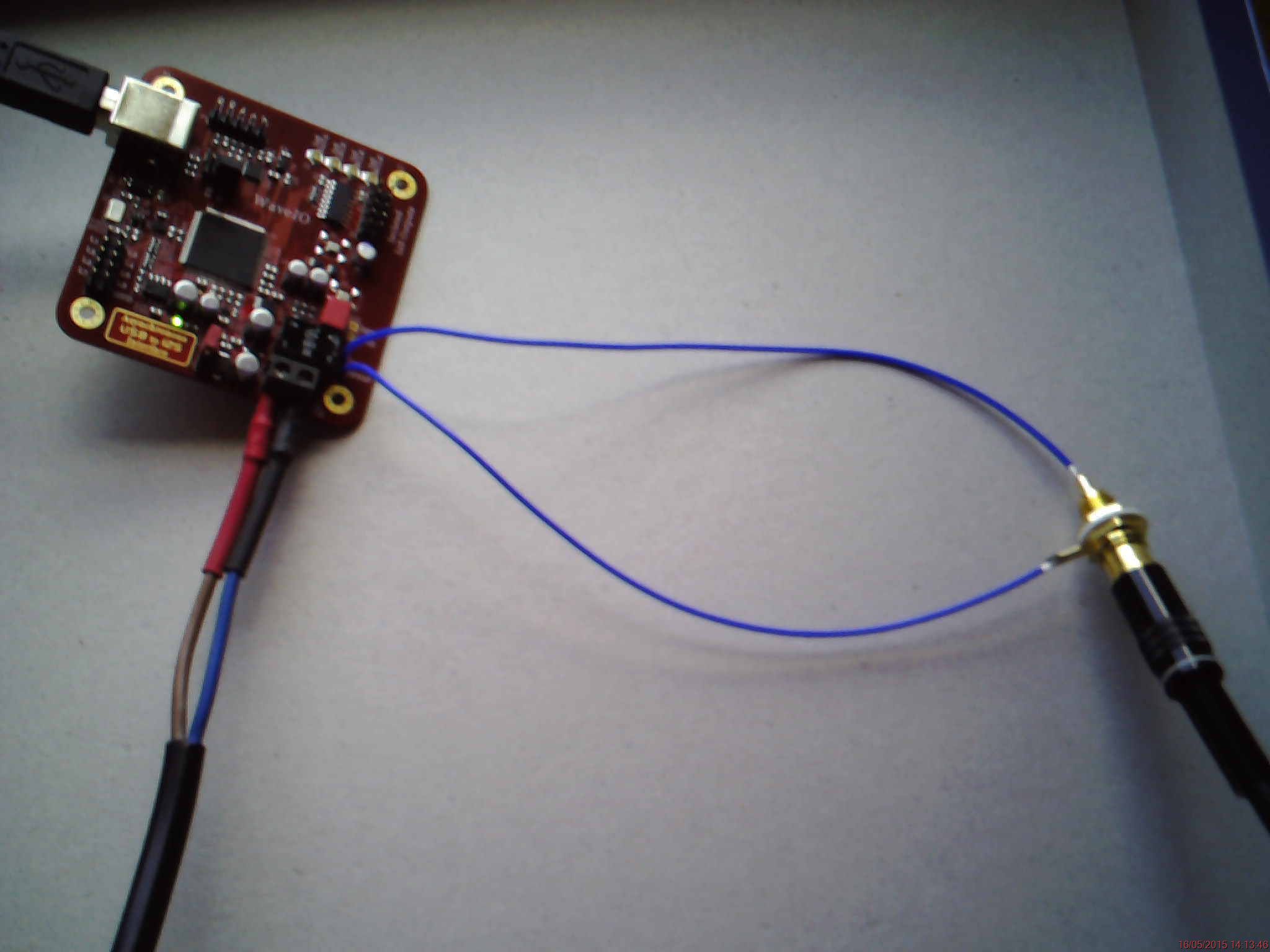

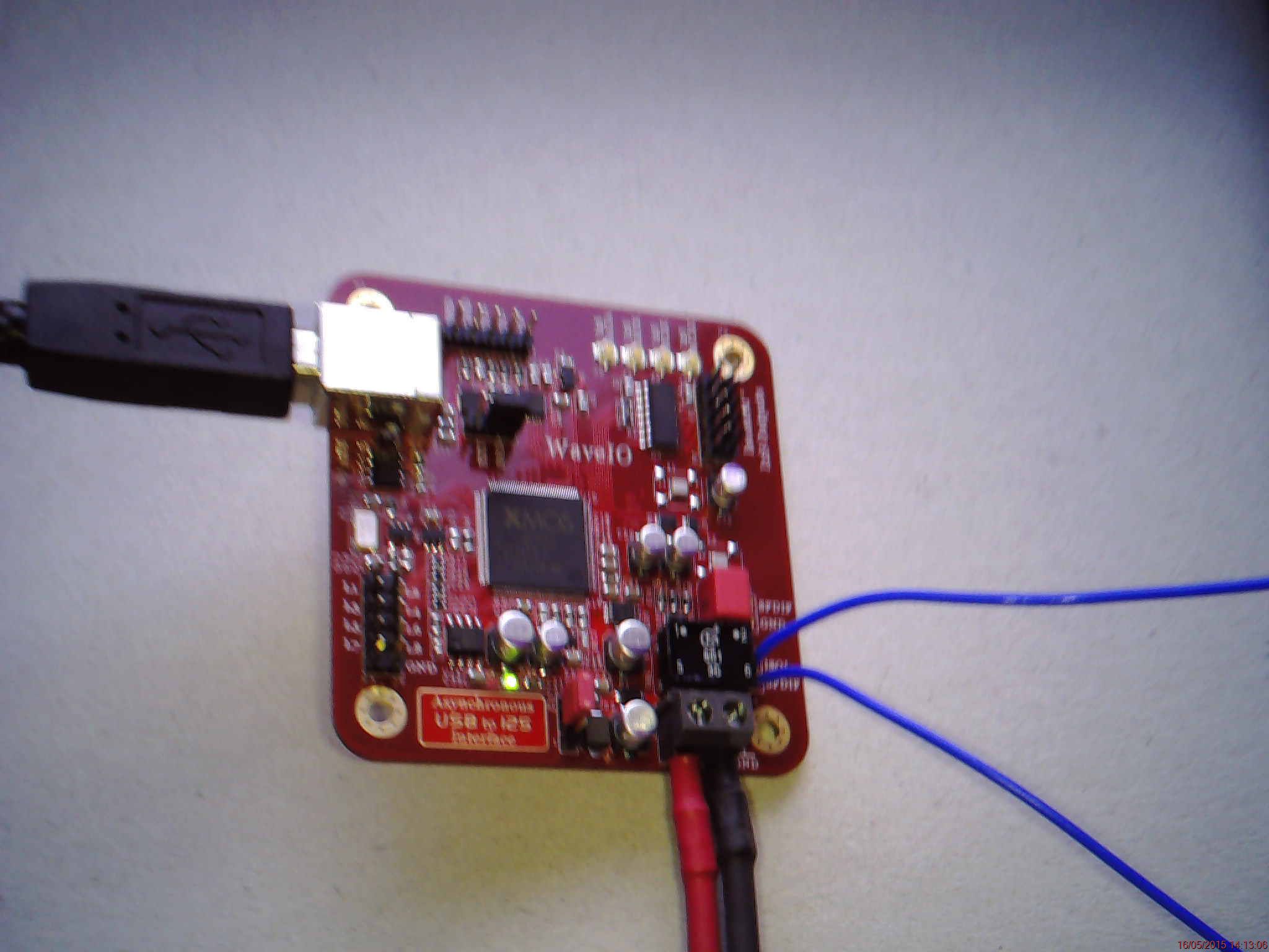

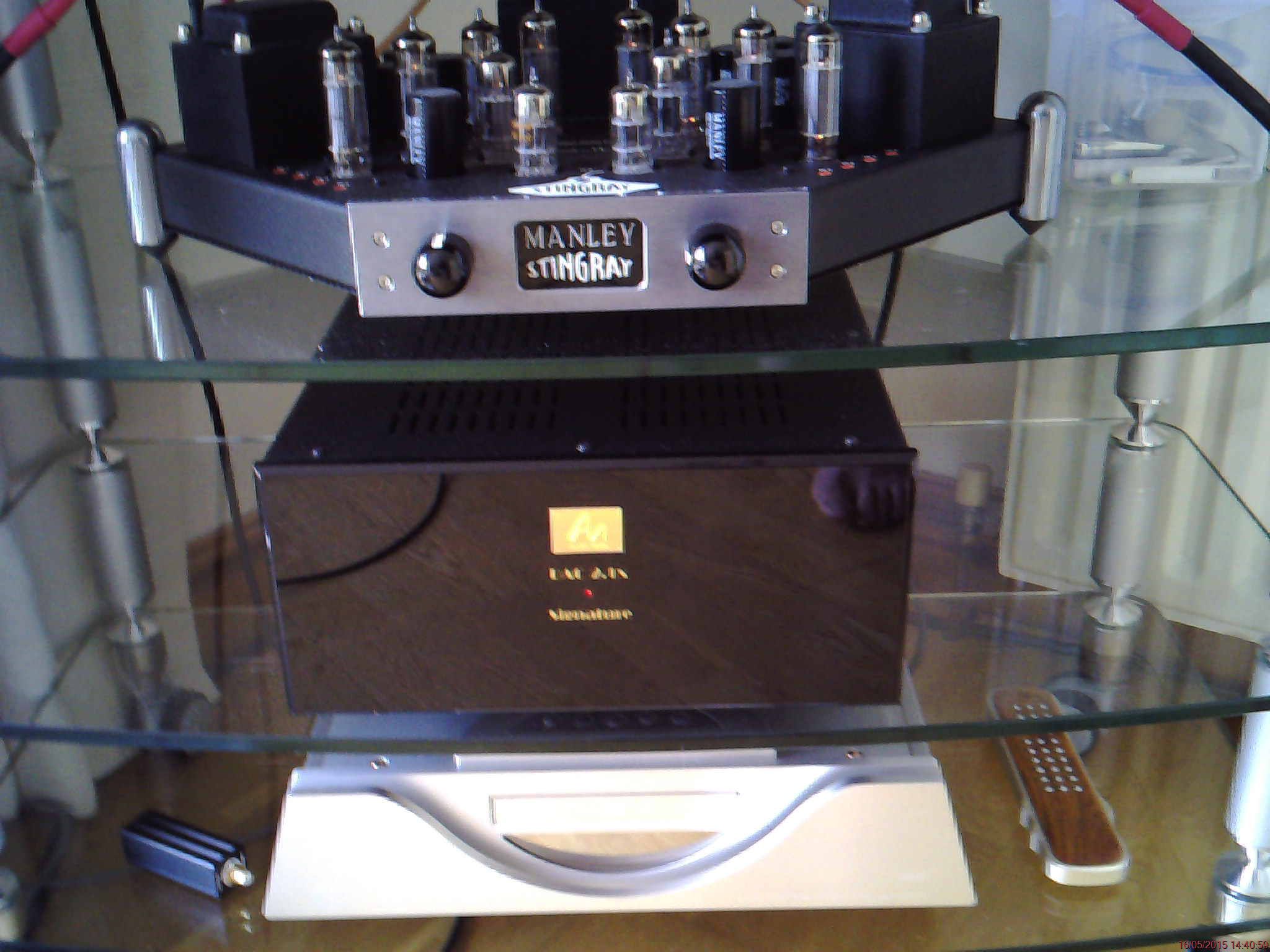

can you show a picture of your set up
i never had problem with the i2s but the coax can be tricky, i use kynar 26 or 24 AWG (silver plated oxigen free copper) that i twist together very short distance (isolated output only)
dig into W7 driver menu to see all the option, oh i forgot i always deactivate all the sound hardware on the computer i use (hackmac, pc or linux...) if you want it very easy boot daphile instead of W7 (no driver needed)

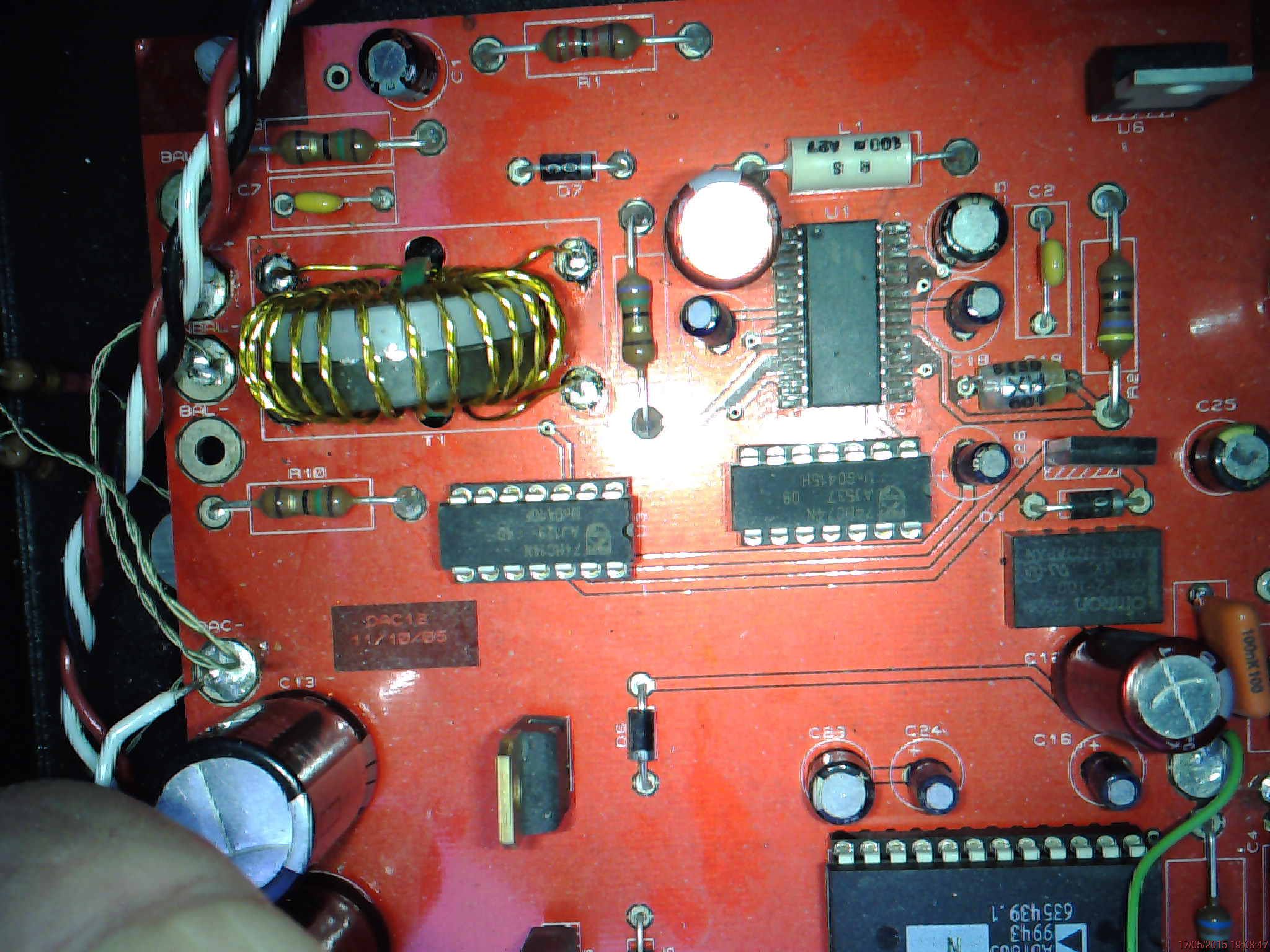

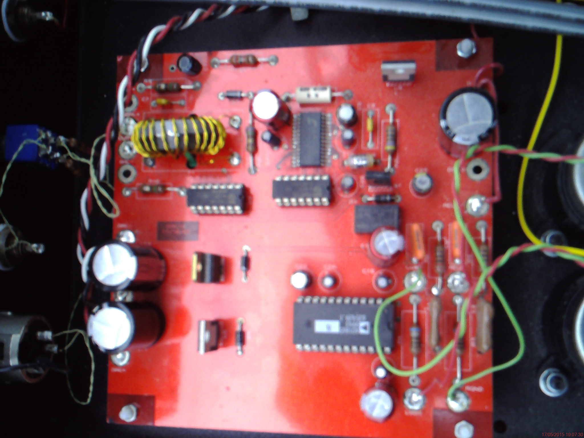

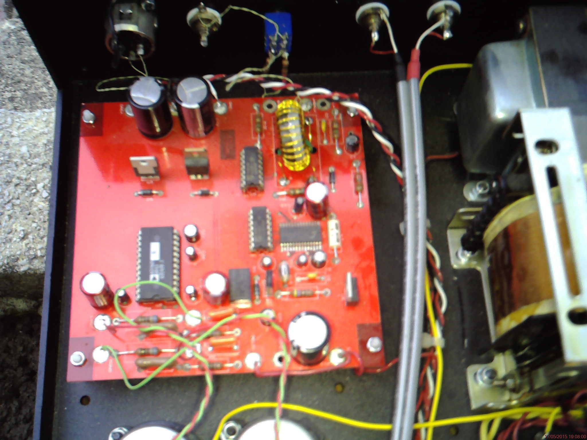

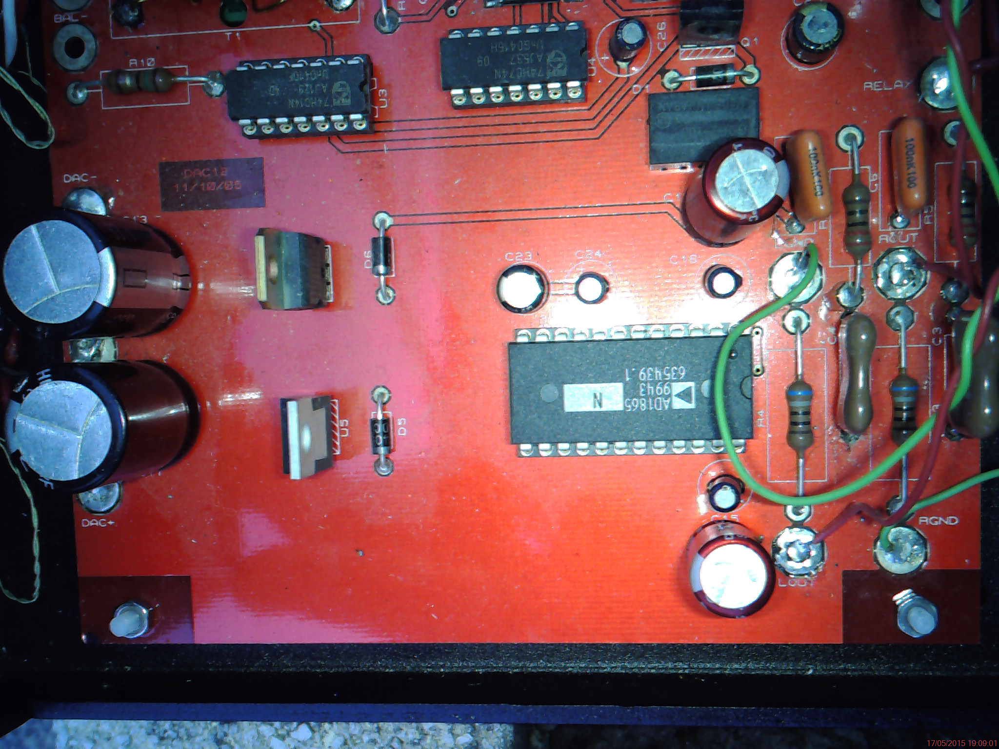

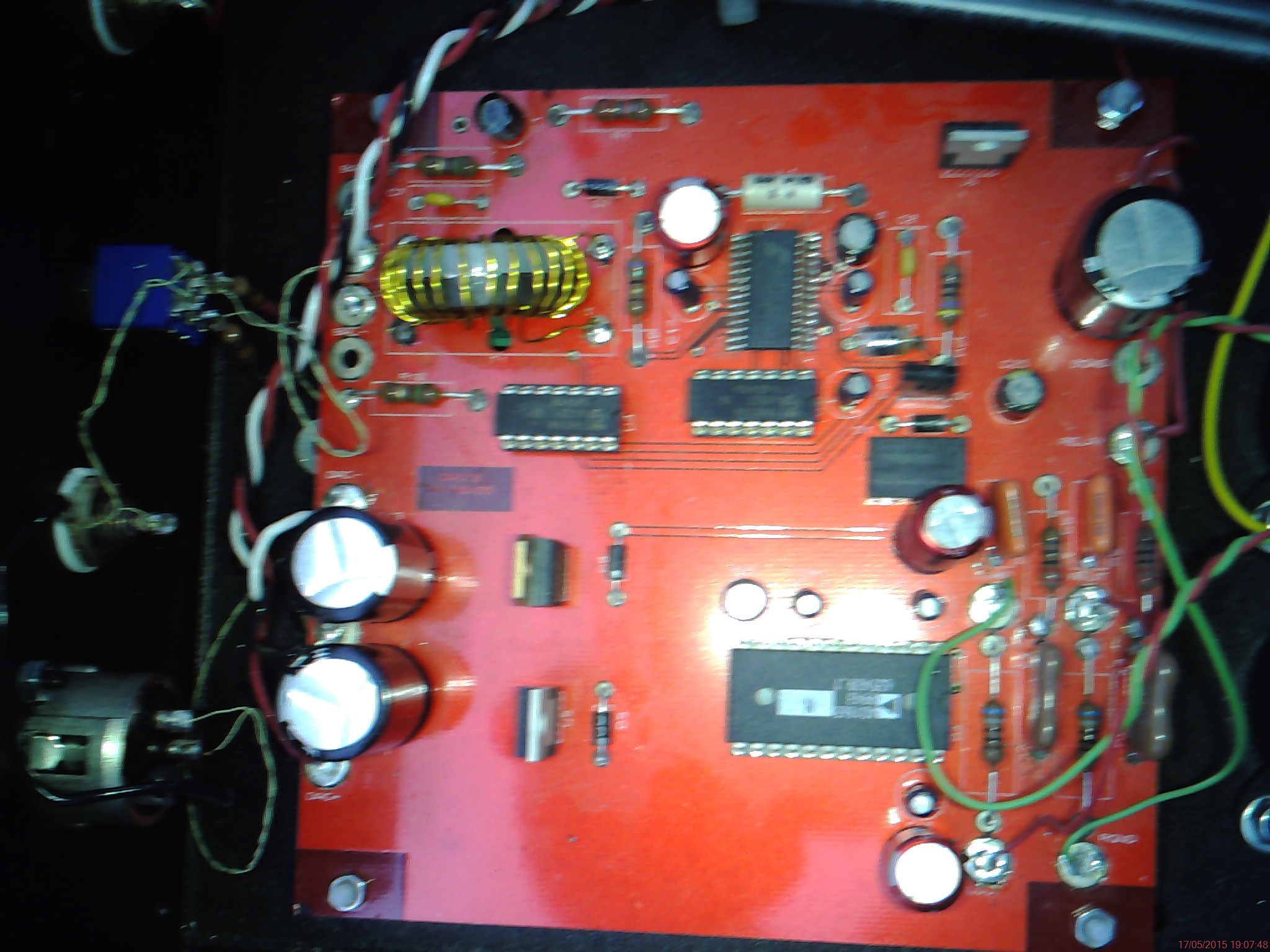

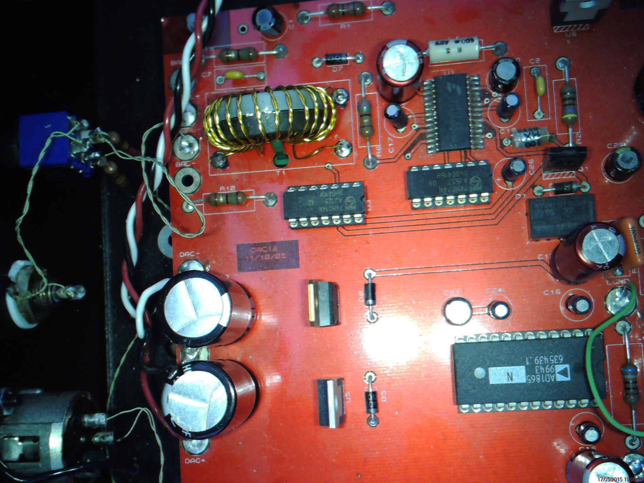

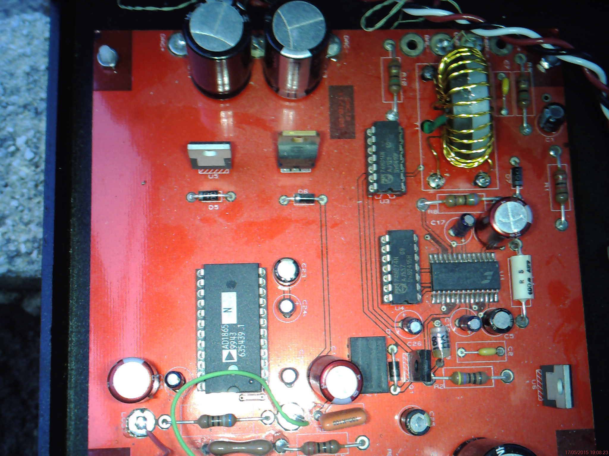

Hi Lucian , thanks for your email I have posted some pictures of the spdif board for you to have a look at , there does not seem to be any problems with the drivers windows recognizes it when I plug in the usb lead and says that everthing is working ok, its also showing sound playing in windows output when you plug in usb lead , have a look at the pics thanks for your help phil.

Still having problems getting this working
did you try 44.1khz 16 bit
and use the isolated spdif output
