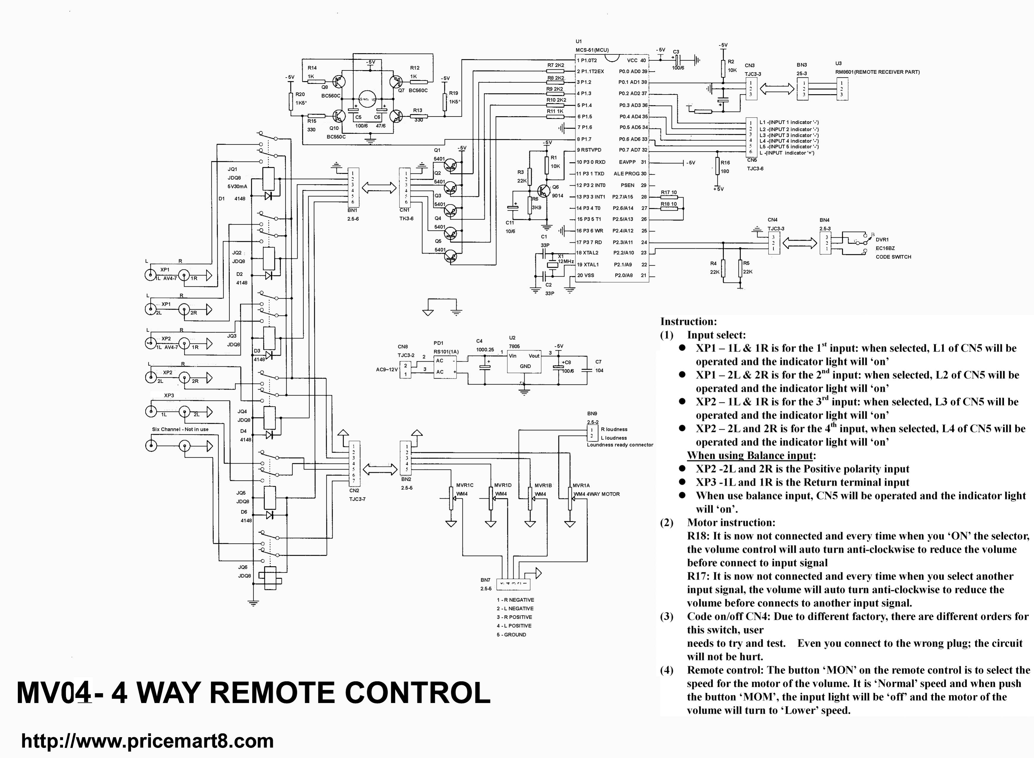

Recently built the John Broskie "Unbalancer" PCB:
The Unbalancer
I'm using a DAC which has two AD1865 chips, and true balanced output - the i/v stage is passive via a resistor so the dac output is only about 200mV. Hence I thought it would be great to kill two birds with one stone and get good voltage gain and CMRR using Broskie's linestage design.
Here comes the hard part - controlling the volume with remote control.
I bought a "LITE MV04" kit:
4 Way Motorized Remote Control KIT set MV04
It has RCA and XLR inputs, and also does either RCA or an XLR output.
HOWEVER, upon receiving the kit & manual (see attached) pdf, turns out the XLR output (which I intended to run to the Broskie PCB) is not true balanced - as you can see in the schematic the circuit accepts a true balance input - 3 wire signal but the output (BN7) is only 2 wire signal (L & R) so it is not a true balanced output.
What would the best plan be to maintain good CMRR in this situation?
Common mode rejection occurs in the *receiving* device. It can be degenerated by impedance imbalance but is independent of signal balance.

I didn't look at the schematic but "not XLR" does not mean "not balanced".
Balanced just means that there are two signal wires for one channel, with the signal on one wire being an inverted copy of the signal on the other. When they are "recombined" through a differential amplifier, anything that was the same on both wires (i.e. "common mode") gets cancelled out.
Balanced refers to the impedances not the signals.
A balanced connection works just as well with
a.) two in phase signals of different amplitude
b.) a single amplitude signal and a zero amplitude signal
c.) a pair of opposite phase signals of the same amplitude
d.) a pair of opposite phase signals of different amplitude
The common factor of all of those different signal arrangements is that the impedances of the two signal connections are close to identical. The closer to identical (including resistance and inductance and capacitance) the better that the balanced impedance connection performs it's job, i.e. to reject interference.

Really? I thought that for the standard balanced audio outputs and interconnects it had to be c. Otherwise, standard "balanced inputs" audio equipment wouldn't handle it correctly.
If the source impedances are the same, what happens when you inject a common mode current? Even if one side has a signal and the other side doesn't? You get a common mode voltage, which will then be rejected. Now, suppose the source impedances were different and the signal voltages were exactly equal in magnitude and opposite in polarity. Then the common mode current will be partially converted to a differential voltage. All the balanced input cares about is the differential voltage, not how that differential voltage was obtained.
There's lots of confusion on this topic, and I think that most comes from the use of the word "balanced". It's the kind of thing that started with a fairly well understood meaning, and grew, and grew, until it means almost nothing specific now.
In classic pro sound environments there's floating and non-floating "balanced" and in prosumer environments there's impedance "balanced", etc. But the magic doesn't happen at the sending end of things, it happens at the receiving end, and the important part is that the receiving end be differential.
All inputs, even single-ended ones, are differential to some extent, but those made to reject common mode signal/noise are called "balanced". A poor choice of terms but we're stuck with it.
For a differential input to work properly it's only necessary for source impedances to be equal, and signal imbalances don't matter, as several good folks have said better.

Sorry, we've ducked the question. I'm not familiar with the Broskie device, but if you say it has a good common mode rejection and if you want the common mode rejection for the purpose of nulling distortions common to both polarities of the D/A convertors, then you definitely want it to follow the D/A convertor immediately. Inevitable mistracking of the volume control pots would disturb your common mode rejection significantly.
If these are not your goals, you'll need to spell 'em out a little more.
