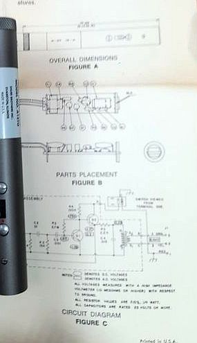

So try Shure A15TG
Apparently not currently in production.
So try Shure A15TG

Specifications
Output Frequency
700 Hz +20%, when terminated with 150 ΩOutput Level
-41.5 +4.5 dBV (8.4 mV typical) when terminated with 150 ΩTotal Harmonic Distortion
5% typical for any output termination greater than or equal to 150 ΩOutput Impedance
15 Ω
Battery Type
1.5 V (such as A76 alkaline, 357 silver oxide or 675 zinc-air hearing aid battery)Temperature Range
Operating Temperature | -12°C to 50°C (10°F to 130°F) | -29°C to 74°C (-20°F to 165°F) |
Housing
Steel with gray enamel finishDimensions
19 mm (.75in.)diameter; 141 mm (5 17/32 in.) longhope that helps...i'm still partial to the Q box's 440 hz output.

Does the level vary depending on the impedance or is it adjustable?
