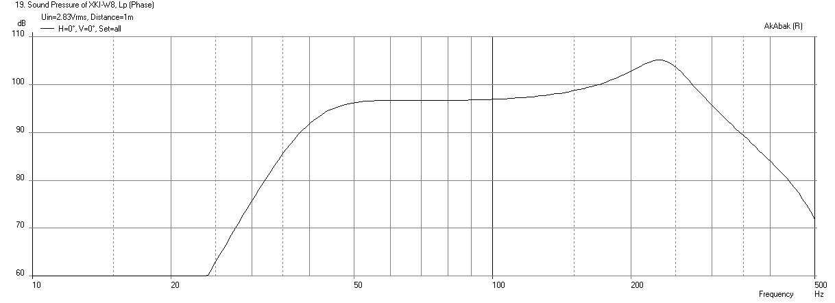

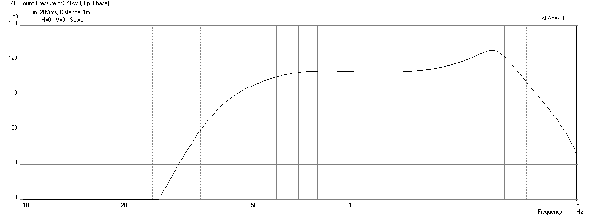

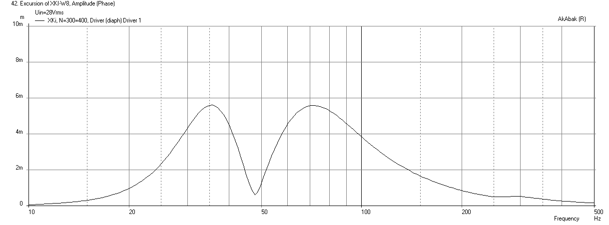

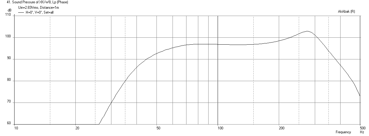

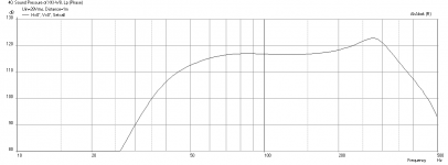

I finally had time to run a sim for you. It looks like you can use this to get a very high sensitivity XKi with 97dB and F3 of 55Hz. It can achieve a max sustained SPL of 117dB at 28vrms using a -12dB/oct HPF at 40Hz.
The design is as follows: 80 liter box wth 80% rear chamber volume 20% front chambr volume, vent is 12in wide x 2in deep x 10.5in long.
Here is SPL at 1m and 2.83v:
Here is cone displacement at 28v to hit xmax:
Here is corresponding max SPL:
I hope you build it! If you require deeper bass extension, be prepared to give up sensitivity. This is a pro-audio driver, so not surprising it tunes to circa 55Hz - the center of a kick drum.

Is that peak around 275 hz anything to worry about, or thats not present in real life?
Plan is to cross over from woofer to the fane around 150 hz so 55 is plenty low - low enough to try running the xo much lower.
The xki box would sit on top of a helper woofer box, so i may have to eliminate the driver angle and make it perpendicular to ground (so driver isn't pointing over the listening area), so i guess the "curtains " will need to tip forward to keep that relationship...
