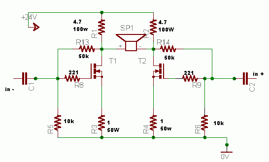

Hallo!
Just today I try to modify substantially the original circuit.
The results are on the attached schematic.
The idea comes from the Bride Of Zen.
(Be ready to build an x Boz...)
For real life test (sigh ... I haven't got a simulator) I use instead of R1 R2 two ligh bulbs that has a value of resistance around 5 ohm or so. That seems to me right since the gain decrease with the resistors.
I trimmed R5 and R6 to obtain across R3 and R4 1.5 volts that let flow current for 1.5 Ampere par halve.But I would like to run each halve at a current of 2 amps ( when I'll buy the right transformers)
And rise a bit the imput impedance.
How it sounds? Incredible !

Stefano
I have just tried your scematic in the simulator, it could do much better.
You have biased (in your scematic) the fets with only 3.6V, wich produces only 300mA draw in both mosfets, you wanted a reasonable draw at 1.5 A.
You are having a bias voltage at the drains at about 22.5V, wich leaves only a 1.5 voltage swing with 8 Ohm speaker, and no headroom at all.
By the way, I think your scematic looks more like Nelsons Zenlite.
You shoud get your self a simulator , it is a great tool in the designing process . SIMetrix free simulator is so easy to use .
You can downlod it here: http://www.newburytech.co.uk/Pages/download.html
I have attached a pdf and a simetrix-file of your scematic.
Hope you can use my feedback.

Hallo!
Henrik,
please take a look at the schematic of Bride Of Zen: I use the same sistem to fine biasing the circuit except for R105 10k instead of 100k.My error , the results are not 10k to ground but at least 20k(or more).
But my circuit effectively runs 1.5A par halve.The drains are at about half the PS or to say 10-12volts.
Probably with light bulbs(24v 60W each) things are different (?).
I'm not Joking , the performance has nothing to do with the previous Xsons.
No doubt , this is X.
Thank you for the simulator: I will download it sooner.

Erik
I have only tried simulators to windows, so I don´t know those for Linux.
Stefano
I am shure, that your bridged or balanced Zenversion souns good.
But in my opinion it contains no X.
You have build a diffrential stage without a tail, both mosfet-sources are tied to ground through its own resistor, and is hereby separated from each other.
In my understanding they need to share one and the same currentsource, thus the feedback can be comunicated from one mosfet to the other through their sources.
I am pretty shure You need a diff. pair with a tail.

Hi Stefano
Shure, but even more important, they are tied together with item 40 (low value resistor), otherwise there would not be any diffrential behaviour, wich is the path for the X-feedback.
By item 40, 42, 43 (resistors) and the two currentsources 26 an 27 you can controle the degree of diffrential behaviour to introduce some coupelig loss in the recoursive feedbackprocess, and thus reduce "the hall of mirrors" effect in ceartin circuits.
Doesn´t seems to be a problem for the Aleph-X or Grey have fixed this in an other way, since it only have one currentsource at the diff. pair.
This is how I understand the patent and the X, and I am shure there is much more to this, and also, I could be wrong.

X or not
Henrik, You are absolutely right regarding your comments about what it takes to have the "X Factor". Whether it is two current sources separated by a resistor (PI network) or one current source and two resistors (T network) is pretty much irrelevant (except perhaps for power dissipation).
The coupling loss to reduce the hall of mirrors effect is really only an issue for preamps where a significant amount of common mode noise might be a problem for whatever it is connected to - particularly if used single-ended.
For a power amp, a relatively large amount of common mode noise is less of an issue as it is effectively rejected by the speaker, i.e. it does not see common mode voltage as a signal at all.

Nelson and Sonny
I wondered too why you Nelson raised the inputimpedance to 47k at Zen V4, working with tis XSOZ stuf it became very clear to me. And I understand this compromise, it is my impression, that the buffer only degrees the soundquality very little, specially compared to the sins comitted by an preamp not able to drive the presented load, that is some degradation worth talking about.
It is easy to make the BSOZ drive even 100 Ohms load.
I have made some simulations of a X-BSOZ and a X-SOZ connected to each other, where I got a frequensey respons like this:
-0 db @ 1Hz.
- 0,15db @ 20 kHz
-3db @ 100kHz
This is the best I can do for now, with a little less gain It can go -0.1db at 20kHz, wich was my goal, tests will show how much gain I need.
I tend to do some comparatative tests between the different types, with and without buffers.
I will come back when this is done, though I think it will take quite some time to do this, as I also have to work for living.
-0 db @ 1Hz.
- 0,15db @ 20 kHz
-3db @ 100kHz
- x soz
