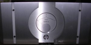

Both filter boards are now ready for wiring up and installation.
Here the intended view of the PS and main Pcbs.
My plan is to match the power fets over the weekend and insall them and be able to test within a fortnight.

Ian, great job so far! The pics shows that you are very meticulous and pay attention to the details Taping up fets is a new one Aluwork takes time, thats obvious for us that actually build amp's now and then, but yours must have taken a lot of time? Considering the attention you give to details, I am rushing my amps

Zen Mod said:I like that Alu chunk in middle
It goes hand in hand with the way the amp images.

Yes, I started around November last year. I have been building aluminium boxes since 2001 now and have gradually build up some experience and techniques. Having a good workshop helps and recently bought a Makita Mitre saw and aluminium blade.
I could not imagine not tapping the power fets these days, its makes assembly so much easlier, I just use an allen key to carefully tighten the M3 hex bolts.
That saw is marvelous, so accurate and saves me hours. But still there is only so much you can do in an afternoon over the course of each weekend.
Looking at the X250.5 and the X2.5 is my inspiration though.
Pass Labs are true masters of their chassis.
