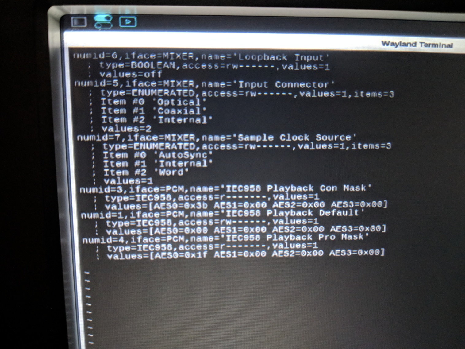

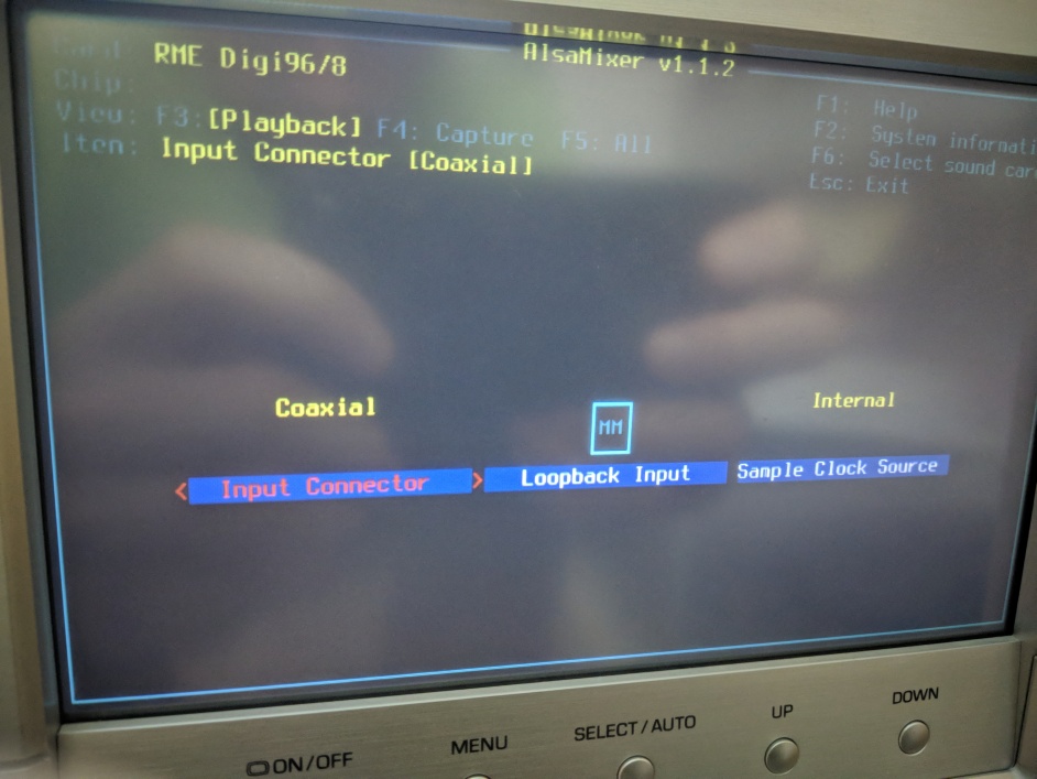

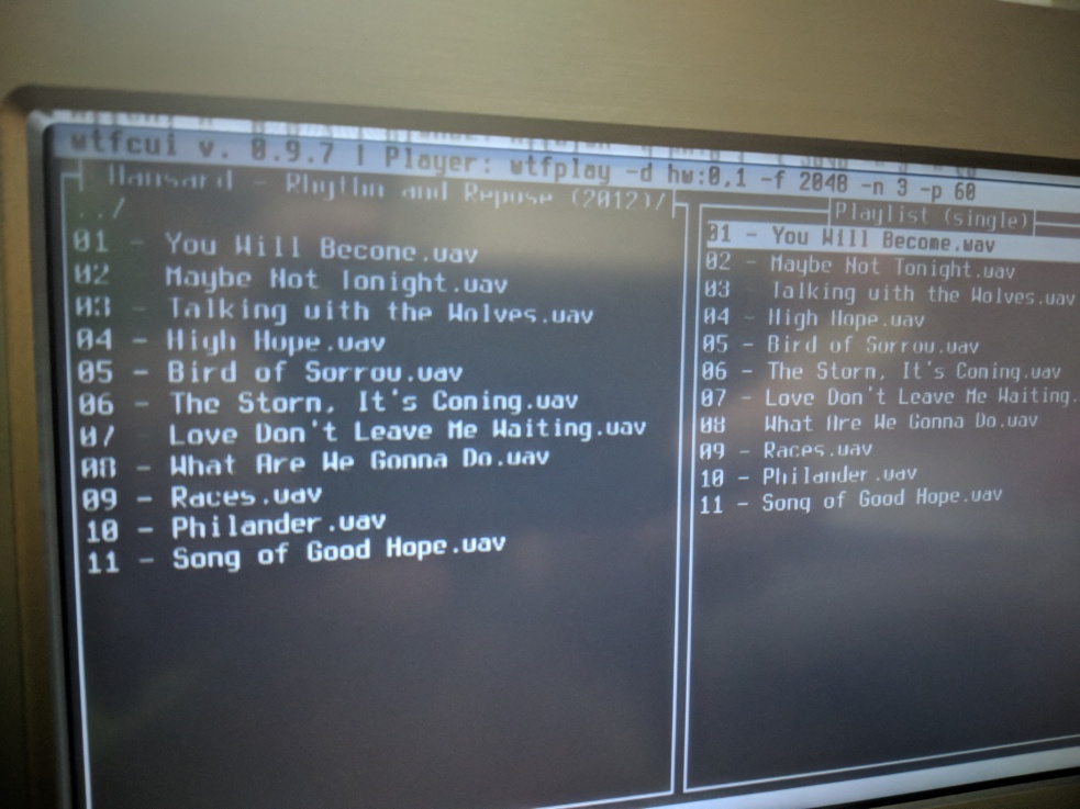

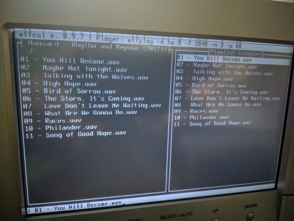

Please help me launch the rme digi 96. The player plays the file, but there is no sound.The output is set to coax. spdif rme-hw:0.0
Tried various hw options. If hw: 0.1, the spdif output is disabled. At the same time, in other linux alsa systems, these cards work OK
For example, a sound card rme digi works great with the Yoctoap distribution (32-bit, PC)Album Player for Linux
I really want to hear wtfplay, help me figure it out

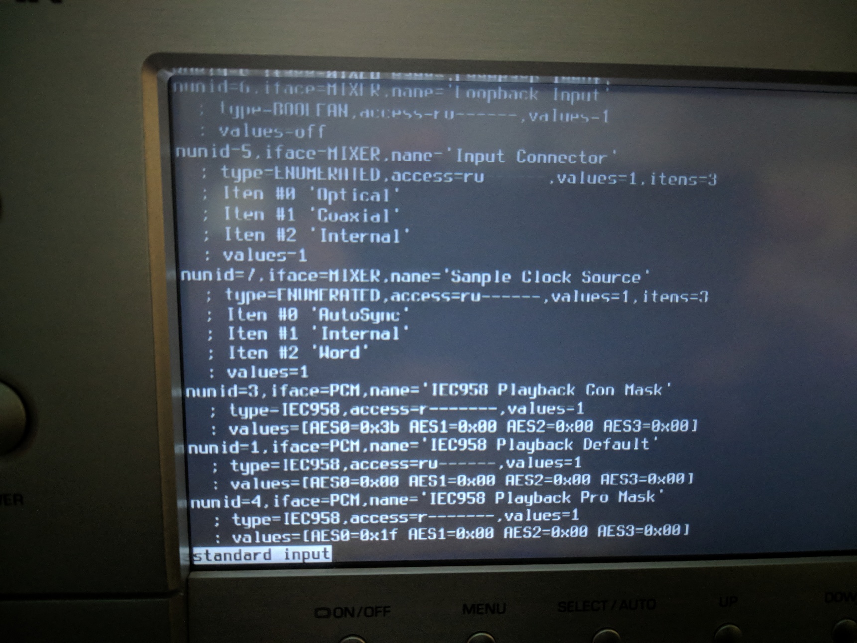

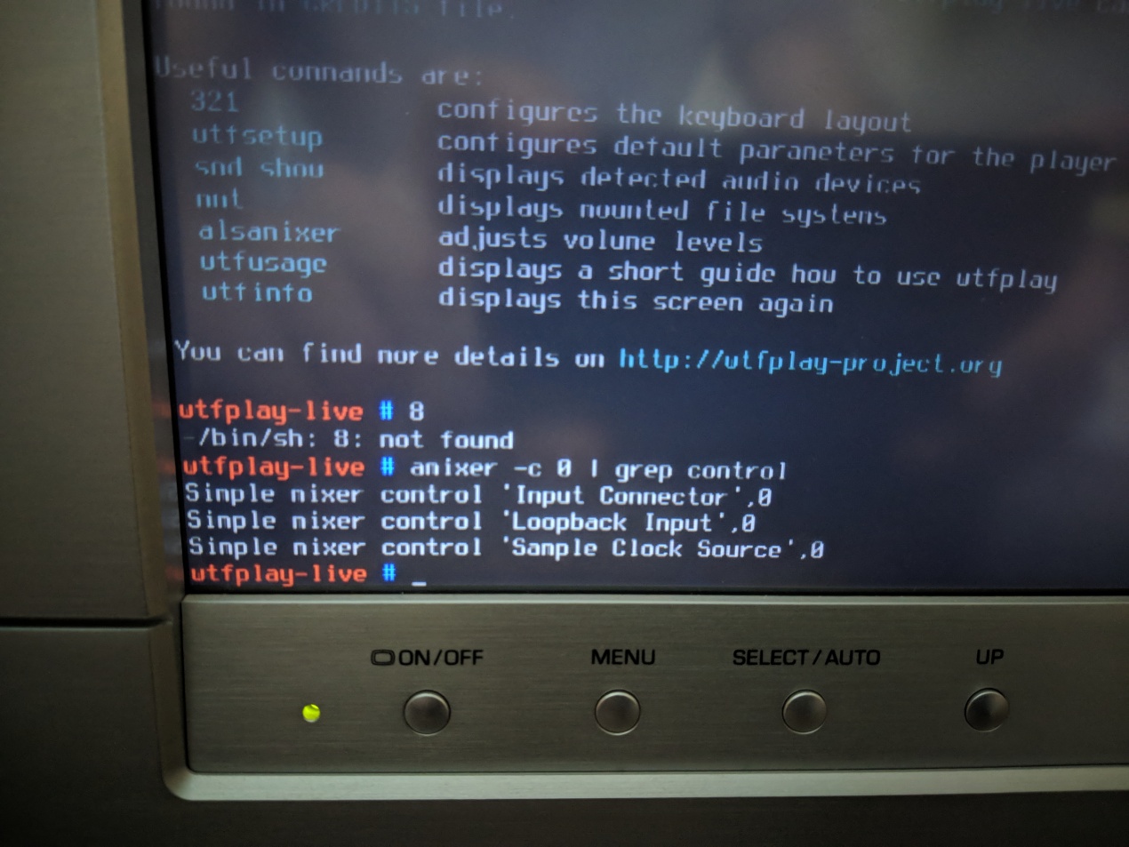

Interesting case. Would you be happy to type some commands?
What do you get with this one:
Code:
amixer -c 0 | grep control
This should print all mixer controls. You can browse them all and see if is there anything related or "suspicious".
Code:
amixer -c 0 | less
You can go even deeper with:
Code:
alsactl -f - store | less

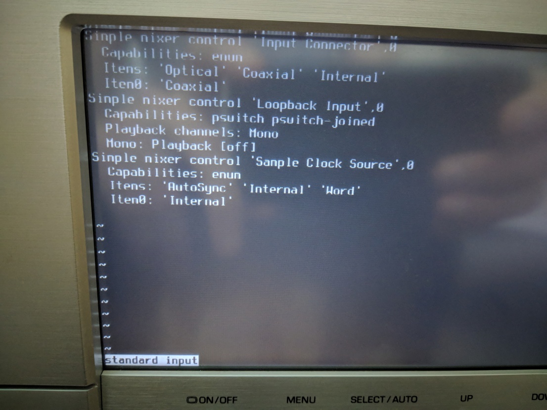

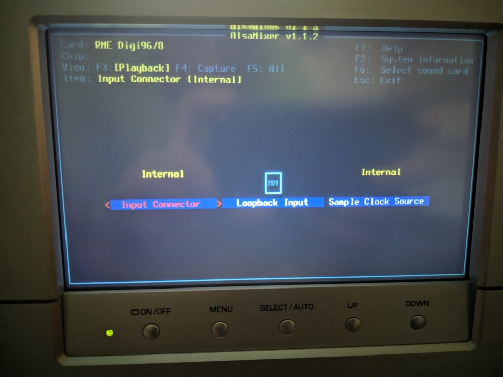

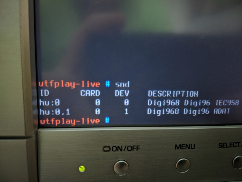

that's what showed
Thanks. It looks like the last command you did a small mistake, but do not worry about it. May I ask you also to try this command:
Code:
aplay -l
We can also try investigating from another angle. You said that the card totally works under a different Linux distribution. Would you be able to try alsamixer, amixer and aplay -l with that distribution. If it works there but does not work here, then we can try to figure out what is different. It is quite possible that I missed something when making the image.
Thank you for your patience with the debugging and I apologize if this seem a bit chaotic. It is not always easy without accessing the hardware.

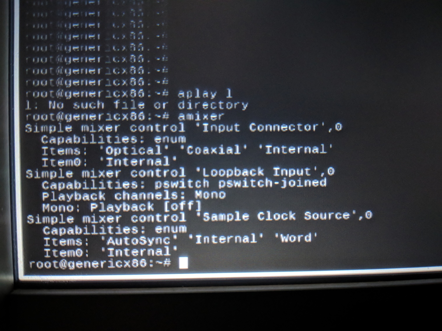

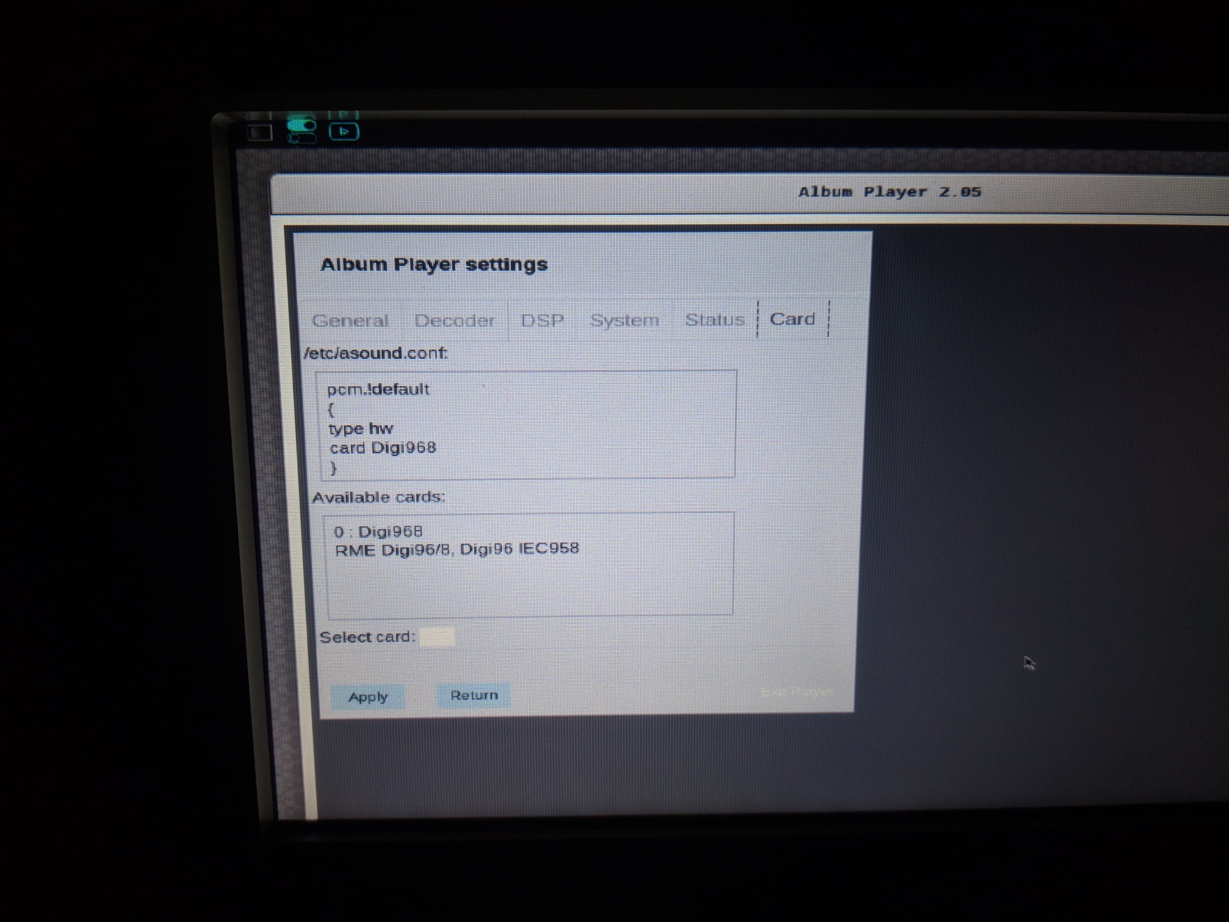

and this is the result on a working system Yoctoap
